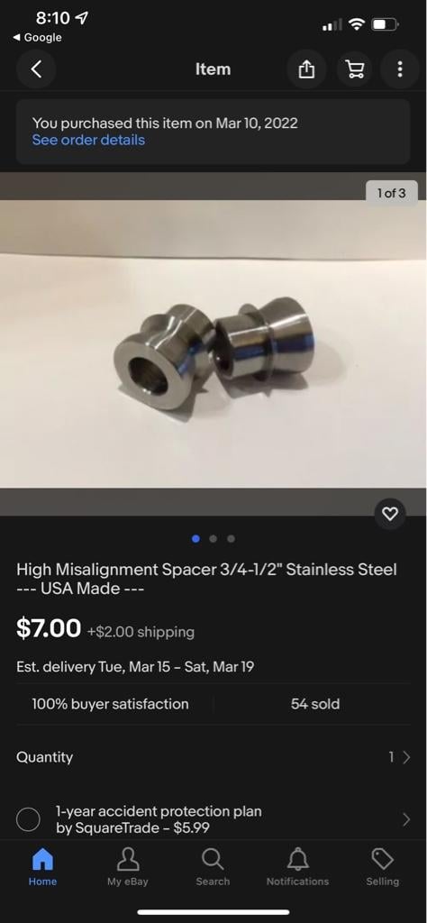

Well, I figured out why my upper links/bolts keep clunking after loosening up a bit lol.
Went back through my Ruff Stuff order and I see that the high misalignment spacers I bought for the heim joints were all for 9/16" hardware... after looking at the links I realized that the upper links use a smaller bolt lol. Doh!!
So the good new is that the lower links should be OK to use the factory hardware, and now that I think about it, it was always the upper links that started clunking. The upper links will just need 1/2" hardware to go along.. which will mean having to drill out the mounts just a bit to accept the larger bolt.. unfortunately I don't see a 3/4" heim misalignment spacer that drops it down to a smaller diameter than 9/16" ID. Drilling isn't an issue except for possibly on the front mount above the gas tank since the space is a bit limited, but we'll see what I can do..
After realizing I was looking and interpreting the dimensions on the spacers wrong (the 9/16 misalignment spacer dimension meant it was for 9/16 hardware, not a 9/16 opening) I looked up other spacers and lo and behold.. eBay to the rescue ! No drilling required and I’ll get rid of all slip in the upper links. Can’t wait !
I run the Rokmen rear upper links and get a clunk from the rear that started since installing them. The spacer is 3/4”, is stock bolt size 9/16ths?
The stock upper bolts are smaller than a US 1/2" hardware.. I can tell you that because I just got my 3/4> 1/2" high misalignment spacers and the factory bolt still has a bit of slop in this, so I will be drilling out my mounts to use the 1/2" grade 8 hardware I just got. If I had to guess the stock bolt is closer to the 7/16" range in diameter.

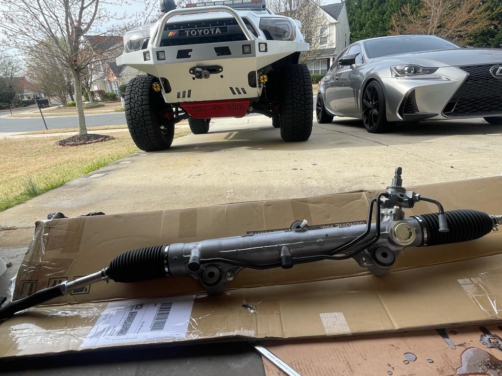

After some debating.. I decided to bite the bullet on the LC200 rack.. Just placed an order with a local dealer, $420 shipped with tax, not too terrible. Could have gone a remanufactured route for slightly cheaper but decided it wasn't worth it.
Already purchased the offset bushings for the swap so will need to put this on my to-do list as well... the plan is to shim the motor up 1/4" with some plates under the mounts and notch the lower cross member if needed to get it to sit right.. not looking forward to doing the swap, but certainly can't wait to have the extra beef for steering.
If I recall the CVJ reman I bought 3 yrs ago was over $300 shipped. That was factored into my decision making on the 200 rack. I think I paid around the same as yours. Brand new beef for a few more bucks and some fab work? Why not?
Curious to see how the install goes on yours w the diff still in place. That was another factor in doing the 200, I knew I would be pulling the diff to put the 4:56s in.

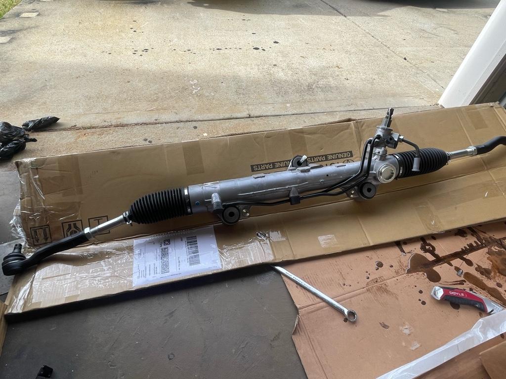

Talk about a BEEF rack… good lord. You guys all mentioned a beefy replacement but holy hell…. Pictures don’t translate the amount of beef this has in person. I’m certain I’ll blow out my front diff before anything happens to this once it’s on haha

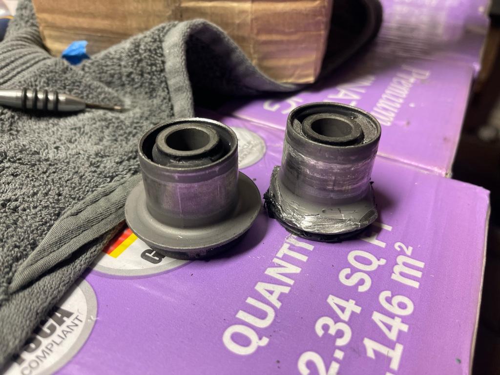

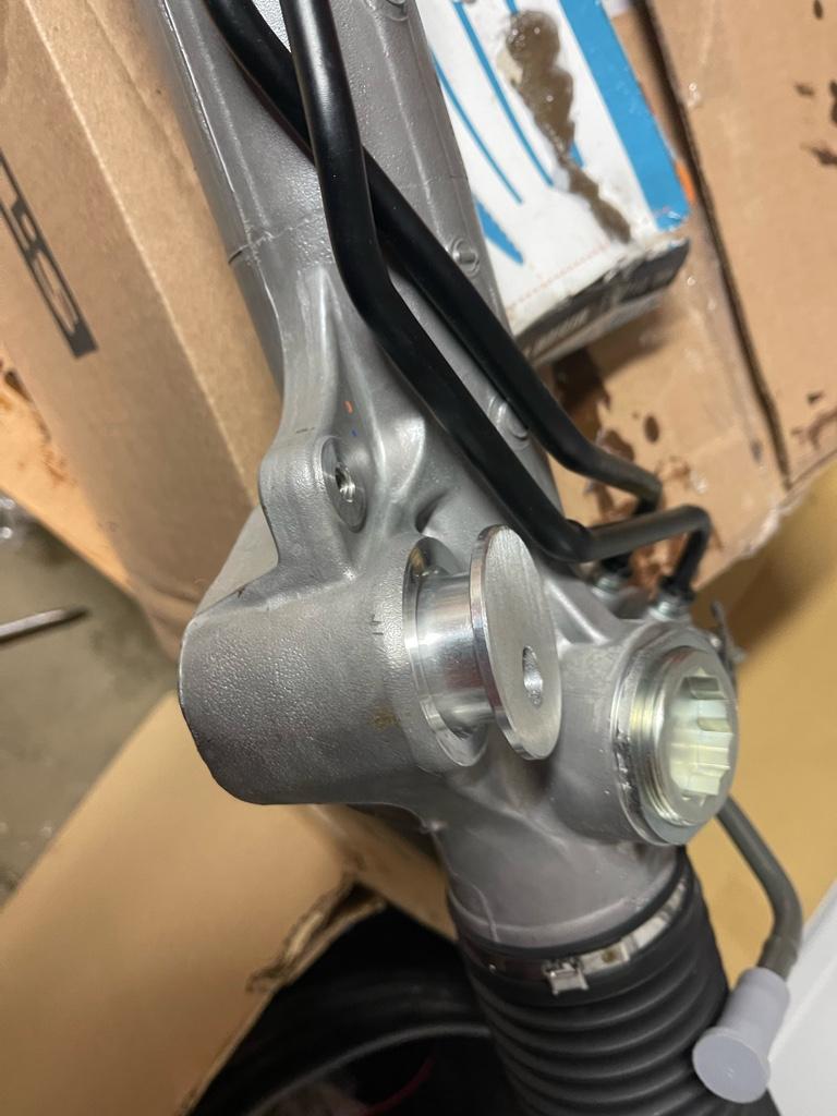

Getting the first bushing out of the LC200 rack was no joke.. but they are out now and just in time for the offset bushings to arrive ! Now just gotta figure out if it has any chance of fitting the stock width without being +2in long travel in the front ..

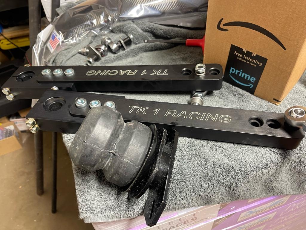

Also started putting together my TK1 racing sway bar to mock it up on the frame along with the bump stops I have to relocate. Planning on diving into this during this week hopefully
Why do you have to relocate the bump stops?
I have the axle pushed back with my adjustable links pretty far back I guess to clear the 35s against the rear doors at full bump and last time I cycled my suspension the factory stop completely missed my axle
