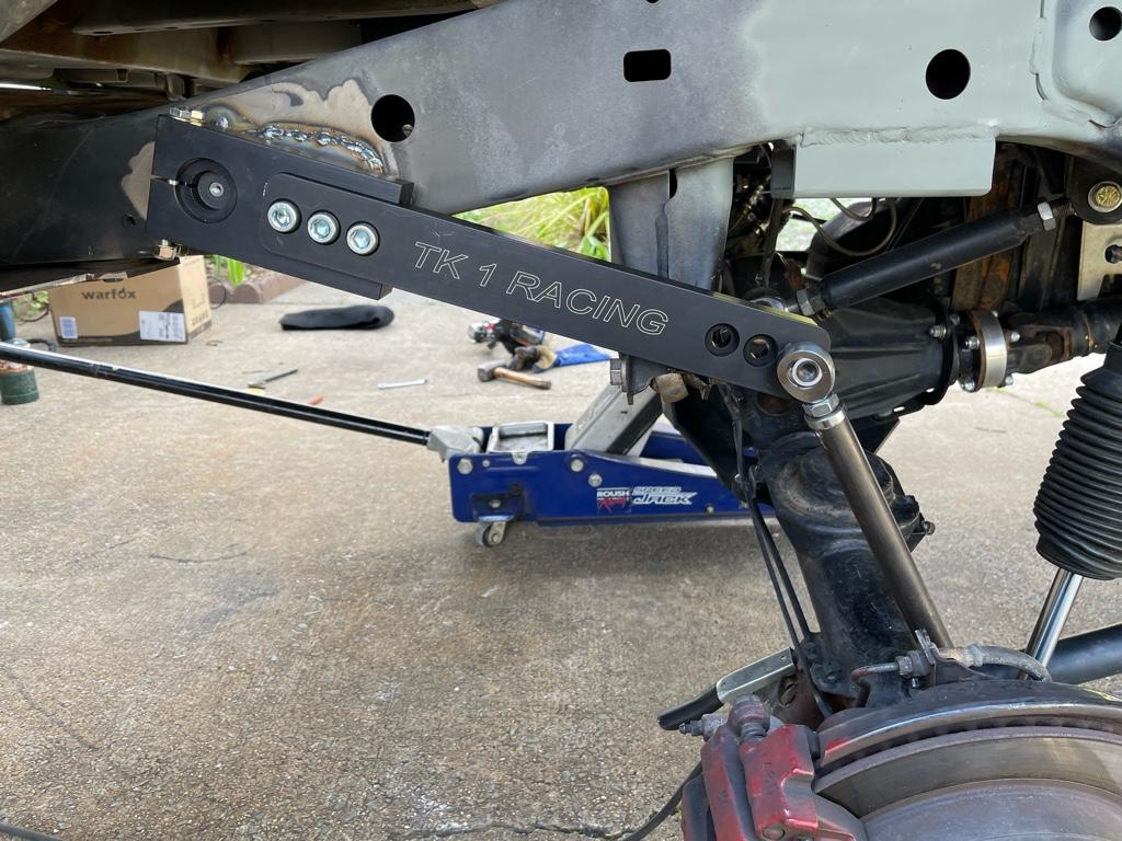

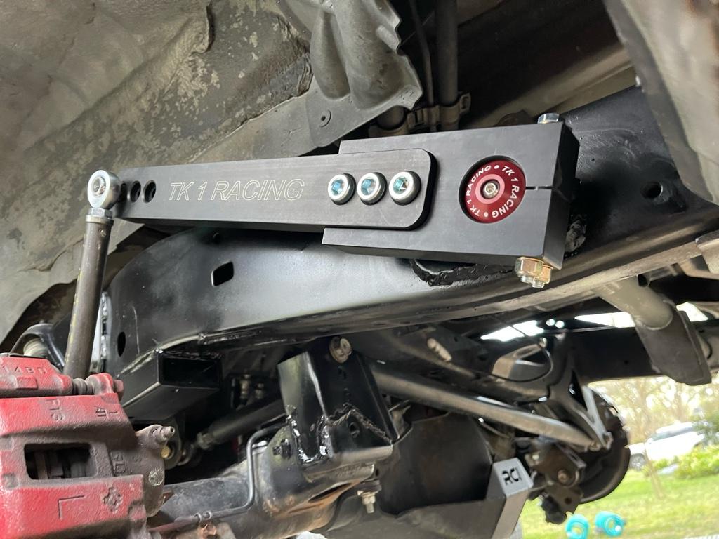

That makes sense. Looking forward to your installs of the LC200 rack and the tk1 racing rear sway bar. I still haven't had a chance to install my sway bar kit yet, but with in the next month or 2!

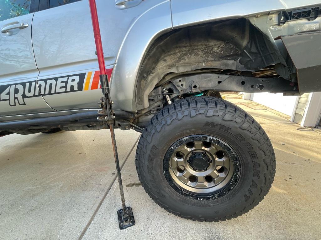

I have the axle pushed back with my adjustable links pretty far back I guess to clear the 35s against the rear doors at full bump and last time I cycled my suspension the factory stop completely missed my axle
I'm really hoping to knock mine out this week, and hopefully get some documentation on it since I've literally found like 2 examples online.. lol.

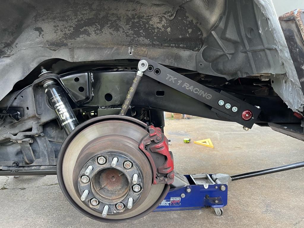

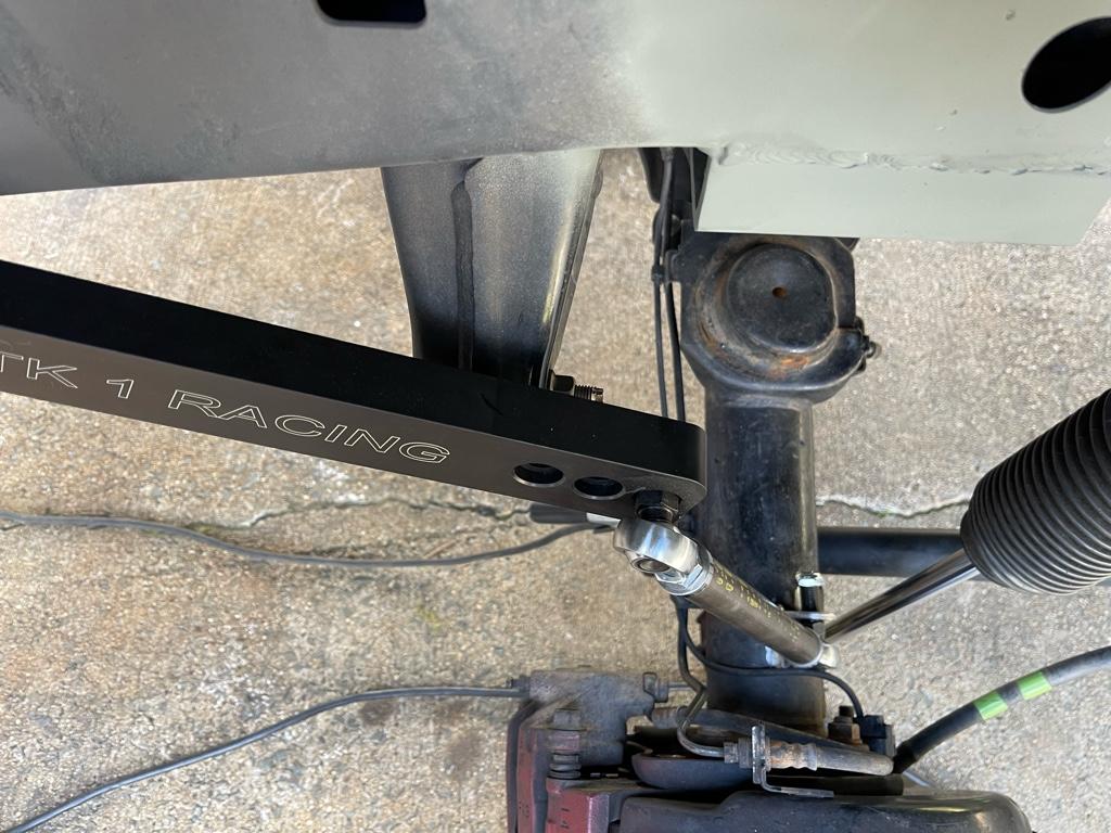

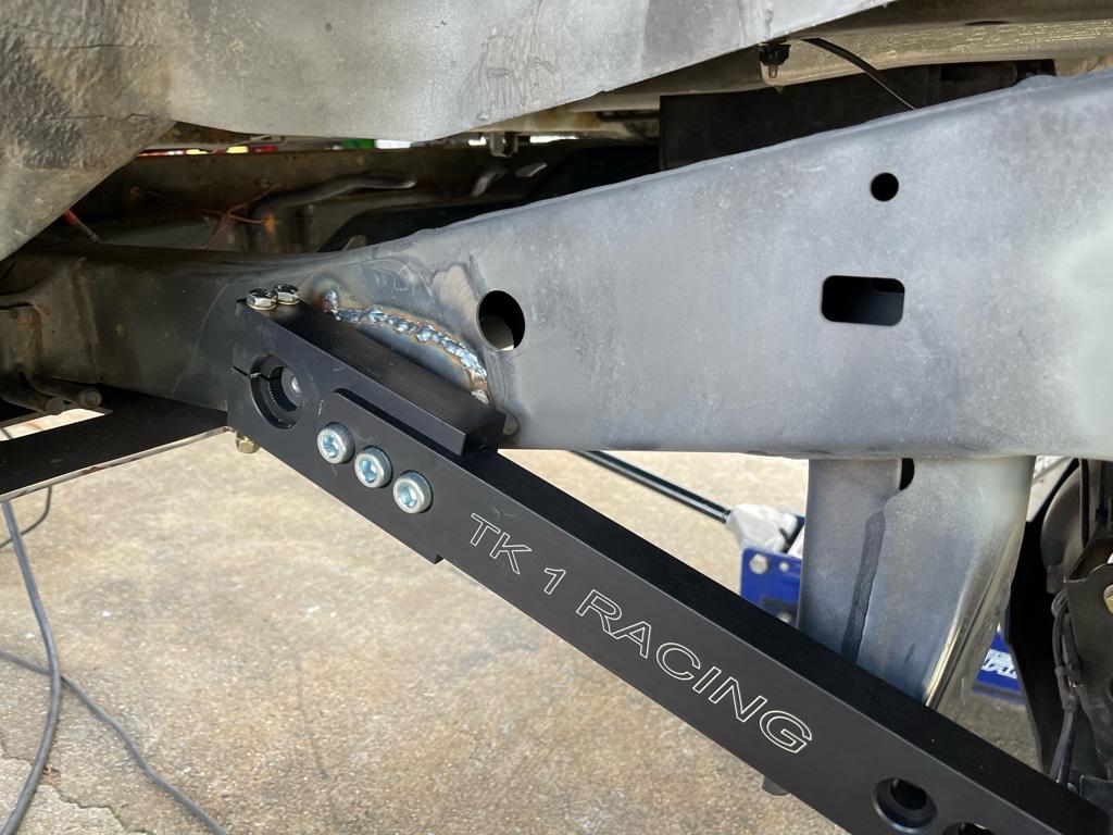

I did some rough laying out of where it "should" be according to the TK1 racing guide: basically the arm should be at least as long as the shock travel, easy in my case since the arm is anywhere from 14-16" depending which hole you use on the end, and the end link length should be at least as long as the shock travel as well, which doesn't look like will be an issue.
I really want to weld the bar running through the middle of the frame rails in the rear to keep it from being mounted underneath, and looks like I shouldn't have any issues, but I may be cutting out the spare tire cross member since it doesnt look like there for structural frame reinforcement. I'll keep you guys posted on the progress, pretty excited to have a rear sway bar lol.

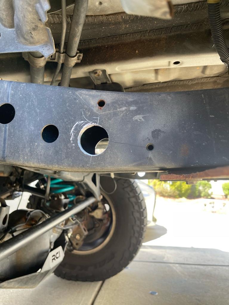

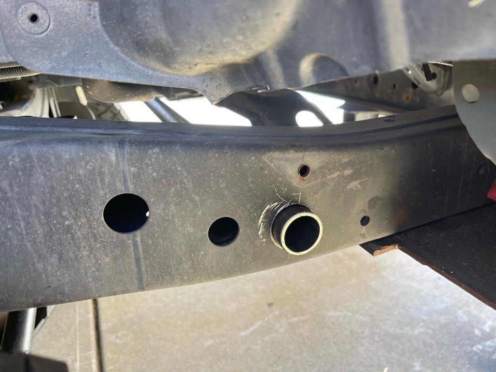

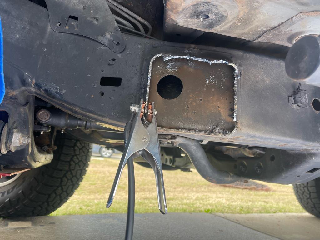

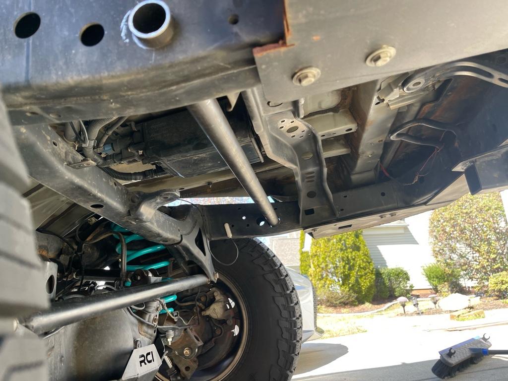

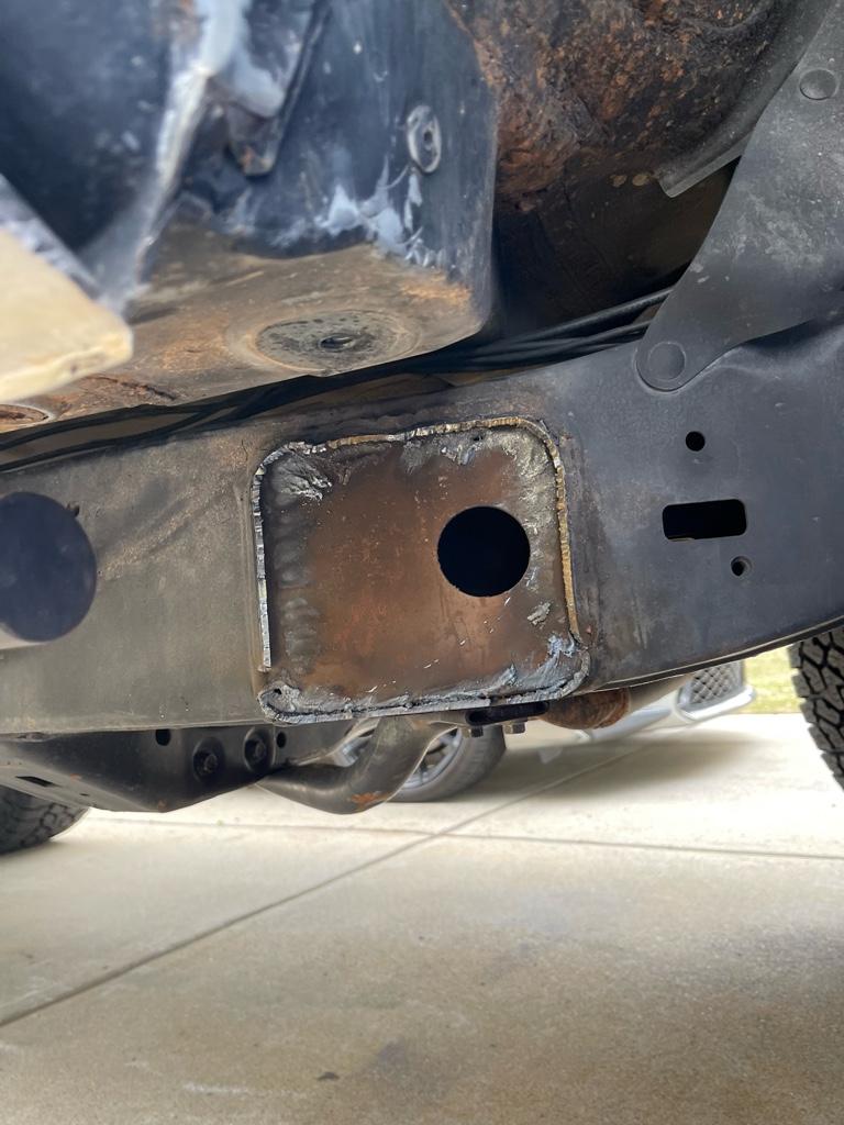

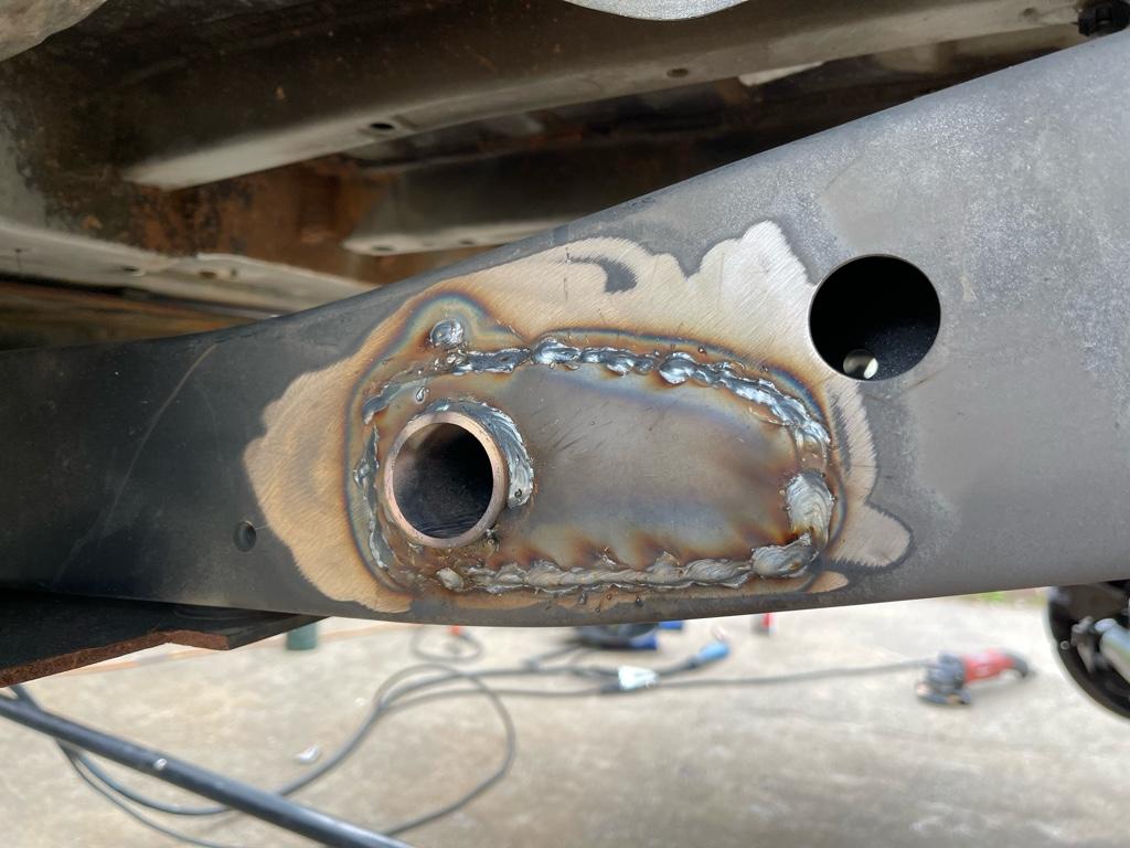

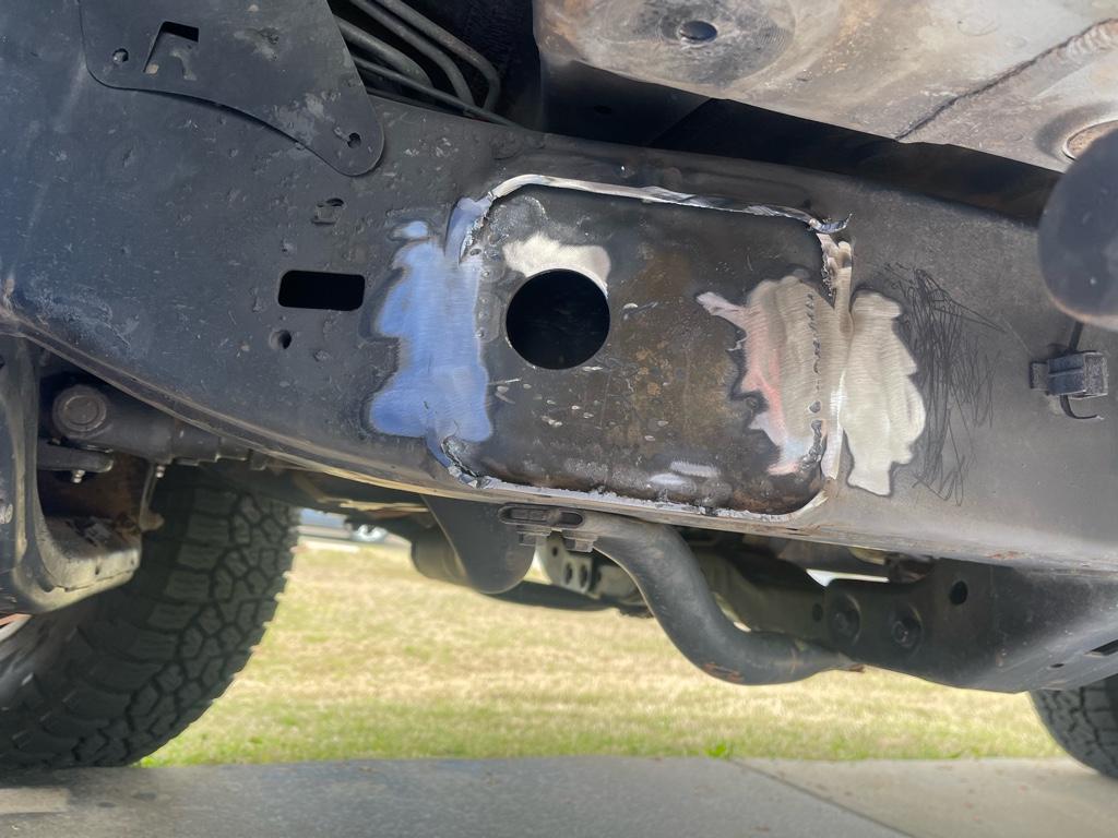

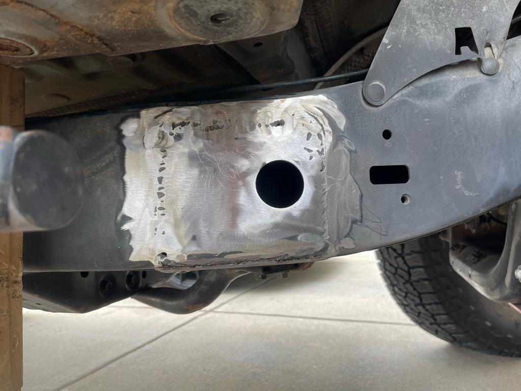

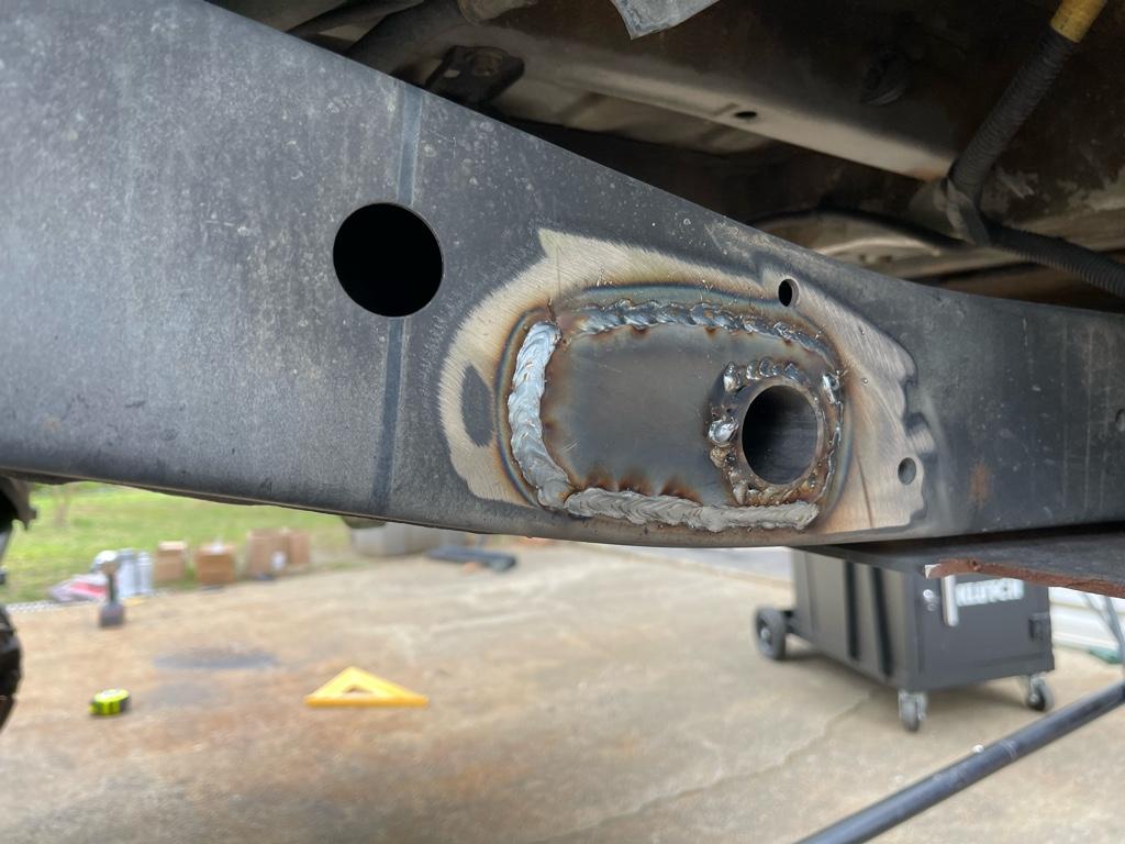

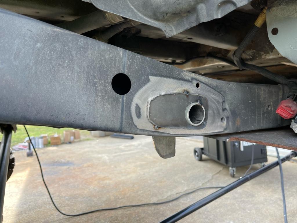

All this sway-bar talk got me excited to get it going.. so I took my lunch break to just dive right in after pulling a couple of measurements.. hopefully my thinking is inline what how it needs to land, because the holes are now in place lol. I know I can't go forward with it a lot, and moving back into the bumper wasn't looking promising since I would have to pull the bumper to drill the holes, and i REALLY didn't want to do that. the UP/Down location was determined by some components running above the tube, and also some rough mock-up of the arm swing as the shock approaches full bump. I figured this should be fairly close.. and the end links only need to be 12" total to match the shock travel.
The driver's side I drilled right for the 1 1/2" OD tube, on the passenger side I went larger in order to allow myself adjustment to square up the tube. I plan on cutting some square plates with 1 1/2" OD holes in the middle that I will use to slide over this tube and weld to the frame. Also looking to plate off a couple of the frame holes that are in the same vicinity to reinforce the frame since it will be seeing a tiny bit of added stress in that area.

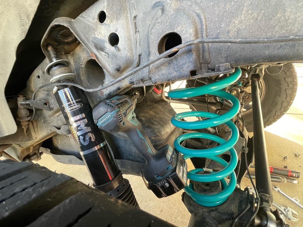

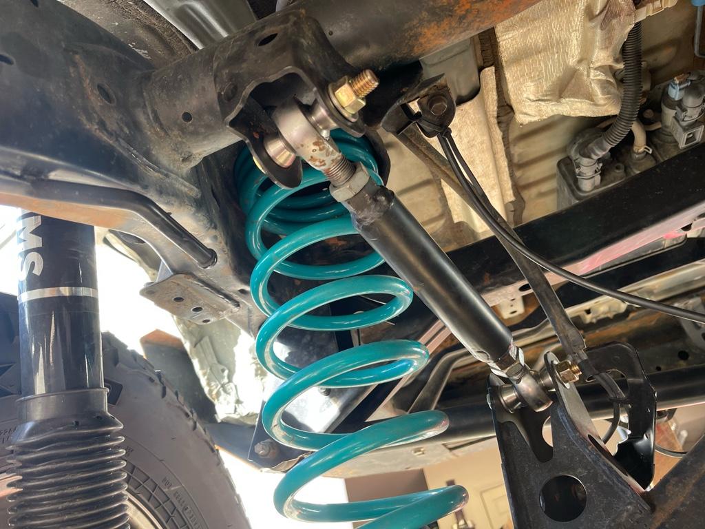

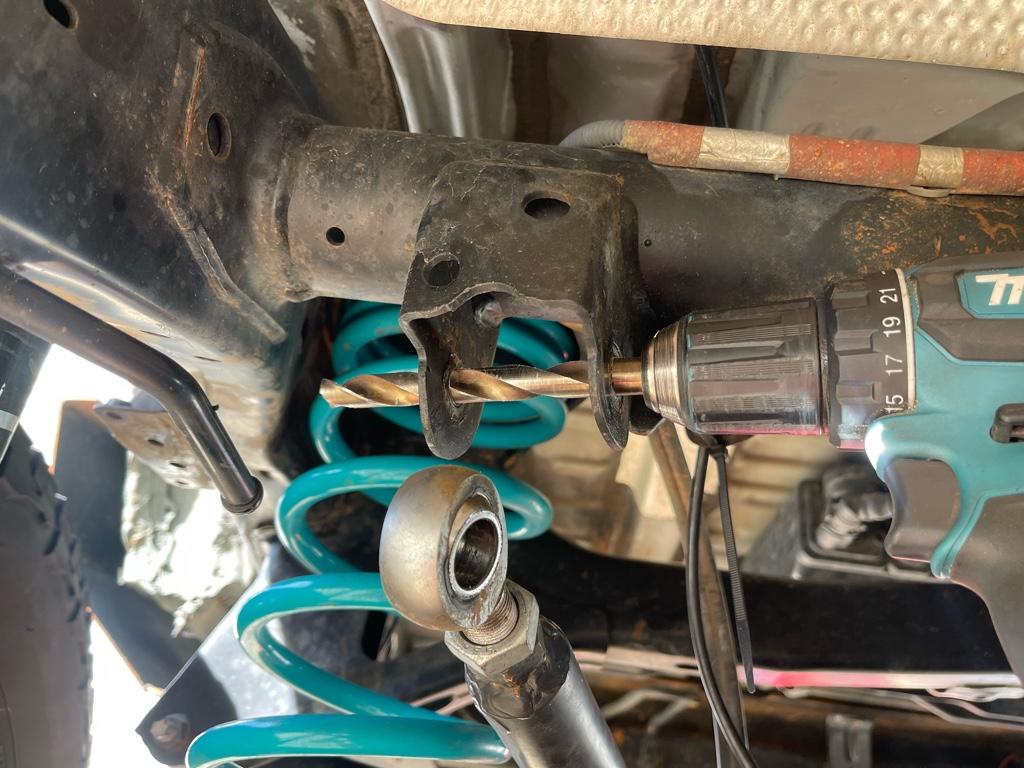

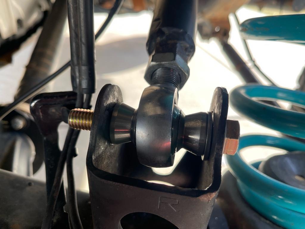

While I was at it I decided it was time to fix the clunking uppers do to the bolts being smaller than the spacer.. the drivers side took nothing at all to do, plenty of clearance to hit the holes with a 1/2” bit.
Had to throw in a washer on the inside to make up some of the slack but nothing crazy.
Nice and snug now. Onto the passenger side which has less clearance because of the tank..
For anyone looking to drill out the upper links, super doable, the drivers side front one is a bit of a pain and requires the shock to be moved out of place , but after that it was easy peasy
So the hole-saw bits I have went through quite a few projects by this point.. and while drilling the frame for the swaybar tube I managed to snap all of my drill bit inserts, as well as chip off some remaining teeth lol so I have a single 1 1/2" bit coming from amazon today so that I can make some support plates to secure the tube to the frame.
I drilled the passenger side one size larger on purpose knowing very well that I would not spend the time needed to accurately measure and lay out the holes (and frankly, even if I did, drilling laying down under the car would probably get these offset anyhow). The idea is to use the 1 1/2" hole saw bit to cut 4 plates that fit snuggly around the weld-in tube. I will then tack the drivers side in place and use the slop in the passenger side hole to square up the tube best I can. I don't believe this is HYPERCRITICAL to get 100% square, but because the clearance from the arms to the frame will be fairly tight, I don't want either side making contact as it goes through the arc of its motion because its not close to straight.
I also don't think the 2 holes adjacent to my new frame holes NEED to be plated since the new hole will have a tube going through it and welded on both sides, so it's not like the frame will be any weaker there, rather stronger if anything, but I still plan on cutting my support plates oversized so that they would also cover up at least one of the holes on each side.

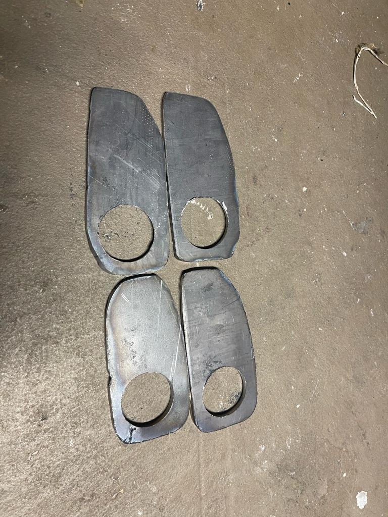

The plan for today and tomorrow is to cut the 4 support plates for the sway bar, cut the 2 gusset strips to reinforce the drivers side front diff mount I have laying around and cut off and clean up the body mounts.

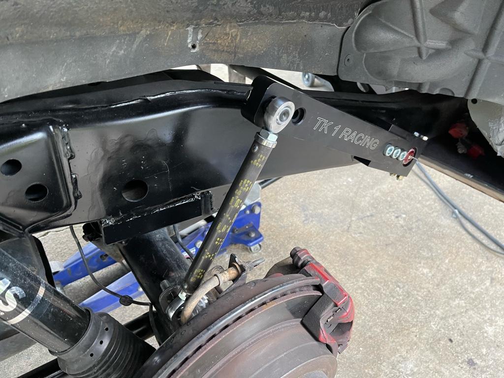

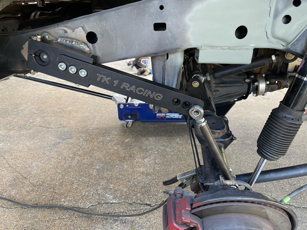

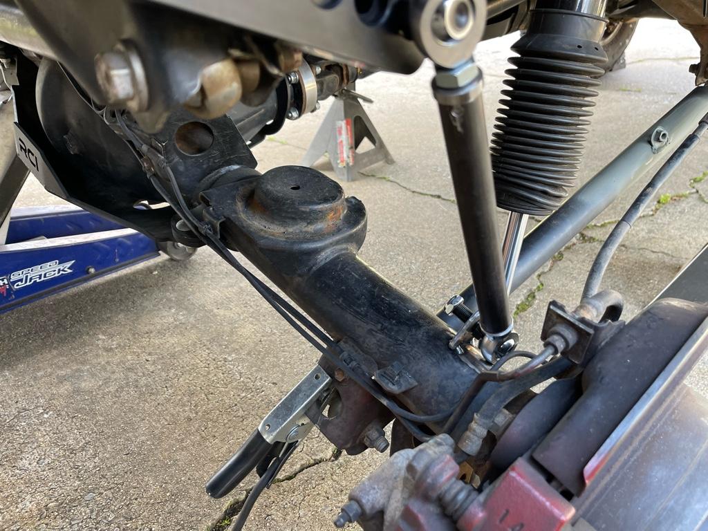

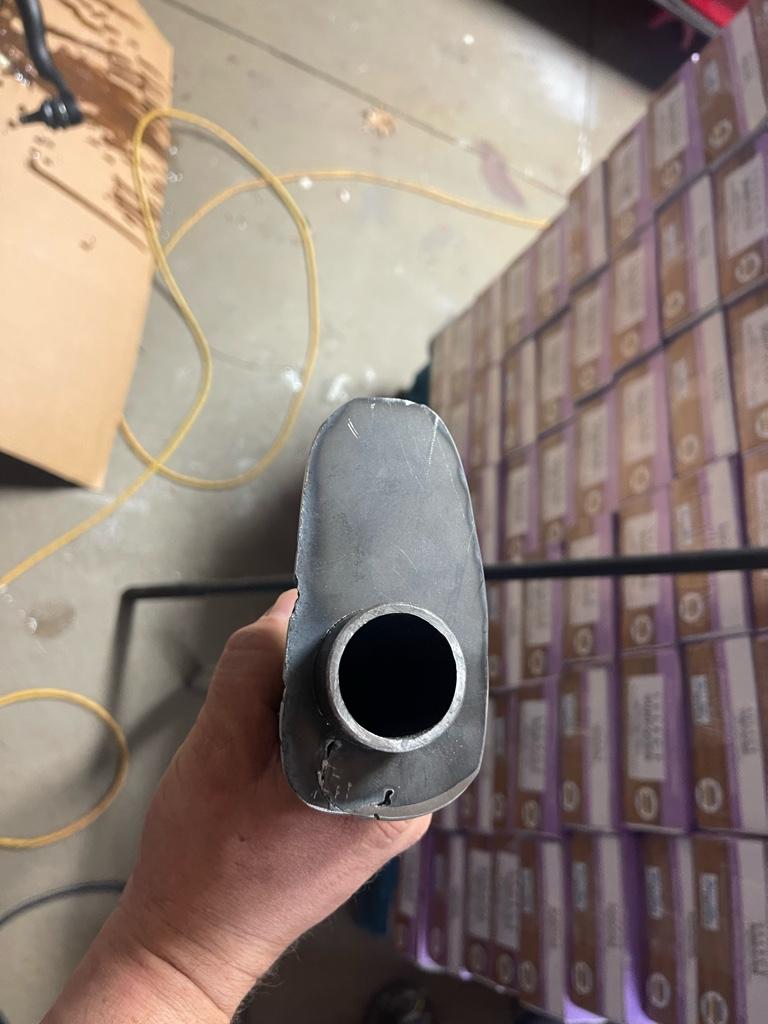

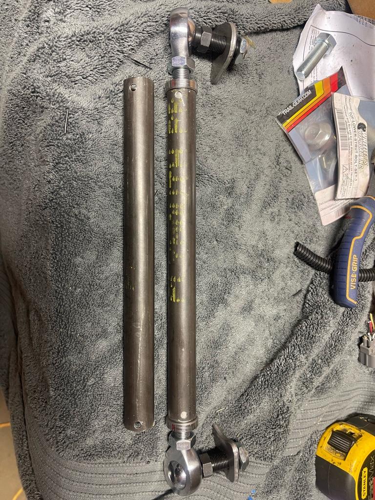

End links for the sway are cut and drilled for welding, 13.5inches overall with plus minus adjustment of 1 inch each way. I’ll mock it up like this and cut down if needed.

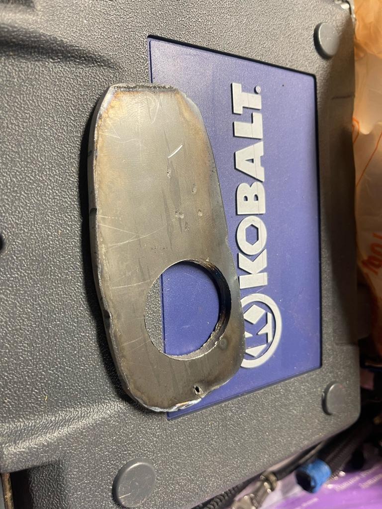

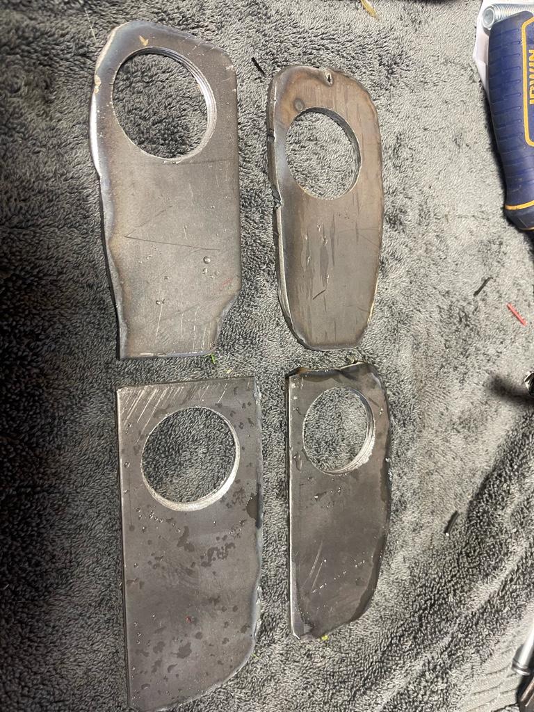

The plates for the sway bar tube are plasma cut and drilled. Not perfect all around but I didn’t feel like making too big a mess with the flap disc.. maybe later.. but you only see the outside ones and one at a time so I think it’s close enough. Function >form lol.

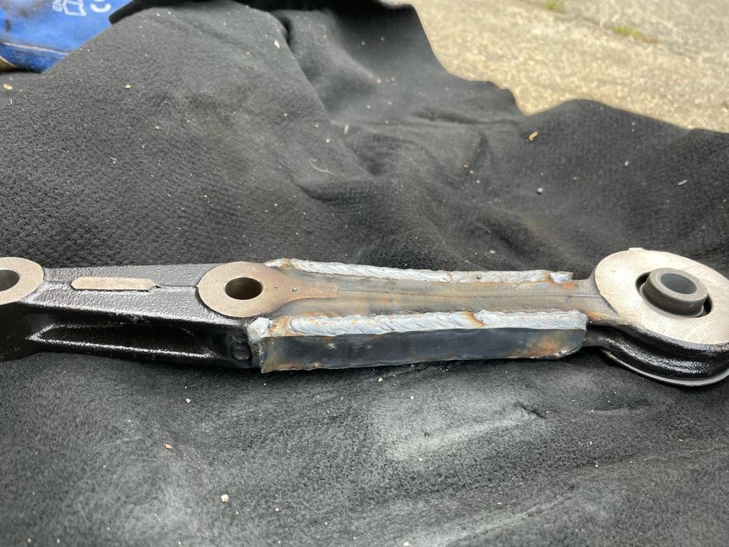

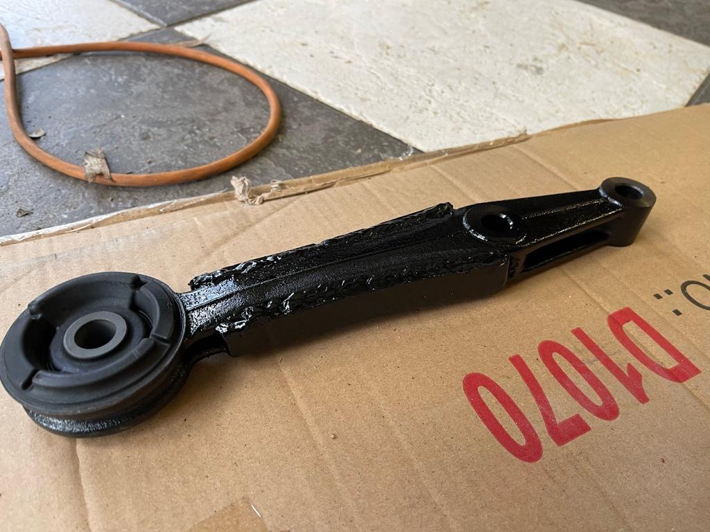

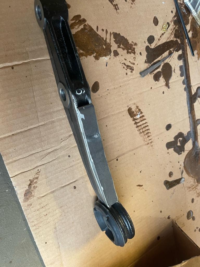

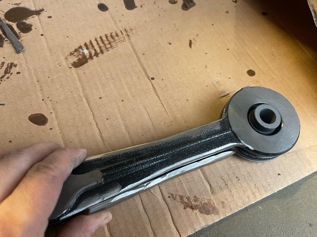

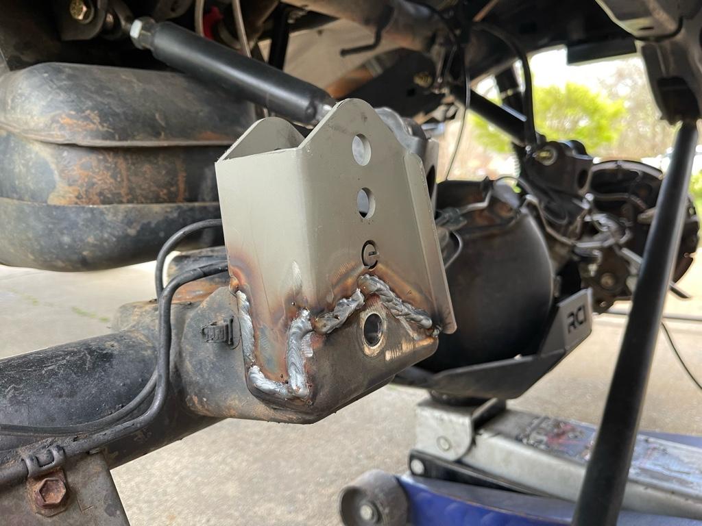

And I went ahead and cut and bent the support gussets for the diff mount arm I bought. Should be pretty stout. I believe this is the only ones that is at risk of failure .. the drivers side (I think I got it right?) only fails secondary once this arm goes. So I think I should be in good shape after this is welded and on.
Only thing of concern is the rubber bushing, going to try and keep as little heat to that end as possible.. maybe just a couple of solid tack weld near the end with cools down time in between .. we’ll see how it’s feeling when I get to welding. Getting exciting. May be able to knock a lot of this out by the time the weekend is over

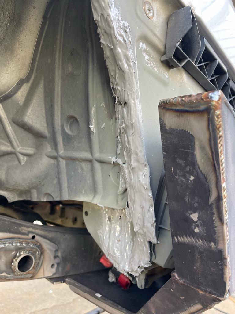

One other thing I plan to do either today (if the rain ends up stopping) or tomorrow is get the plasma cutter back out (it's stupid quick and fun, though definitely requires a ton of practice to cut straight) and chop off the body mounts and clean up the frame. I was going to wait to do it while I was at my parents place with the welder handy, but I don't drive it and plan on welding the relocated cab mounts by this weekend, so I don't see an issue with the rig sitting in the driveway for a day or two without 2 mounts in place. I'll measure the cab height and make sure I jack it back up to where it needs to be before getting the new one in place.

The ASB links are a great idea, looks like it will be pretty beefy. The TK system looks better than the Currie from what I can tell.
I've been thinking about my diff brackets as well. Where did you source the brackets?

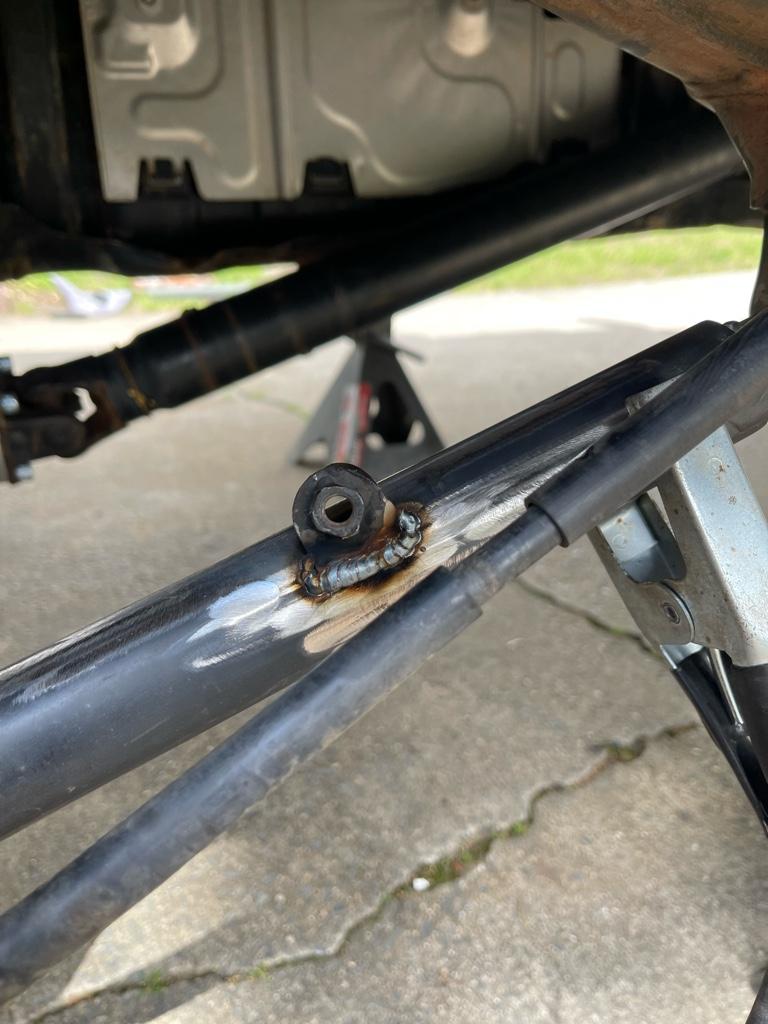

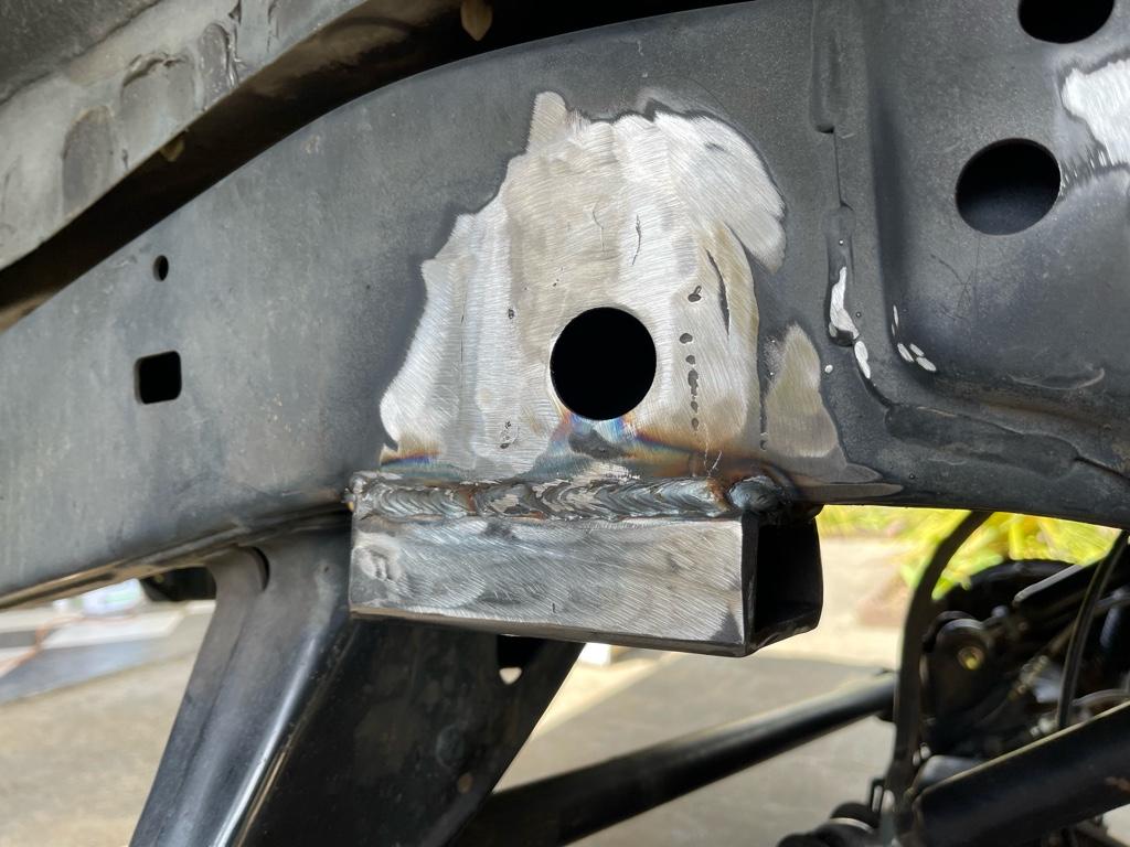

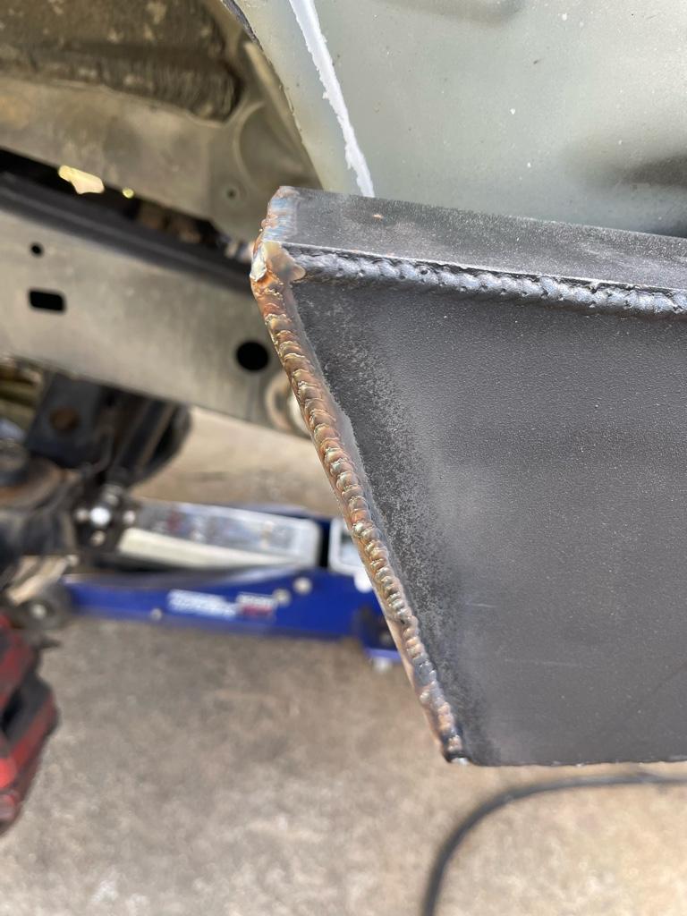

I started welding on my Cam Tab Gussets from MC. I really SUCK at this welding thing lol.
So I payed my 23 yr old neighbor who is certified and works on the Tig crew fitting all the fuel and cryo pipes out at the Space Center. He finished all the stuff I had prepped and tacked up, and even cleaned up some of my slop that I started and decided I was making too much of a mess.
He likes my old Hobart 175 mig, so I can't blame my poor quality on the welder. Practicing on a table is a whole lot different than welding vertical or upside down in tight spots in the wind.

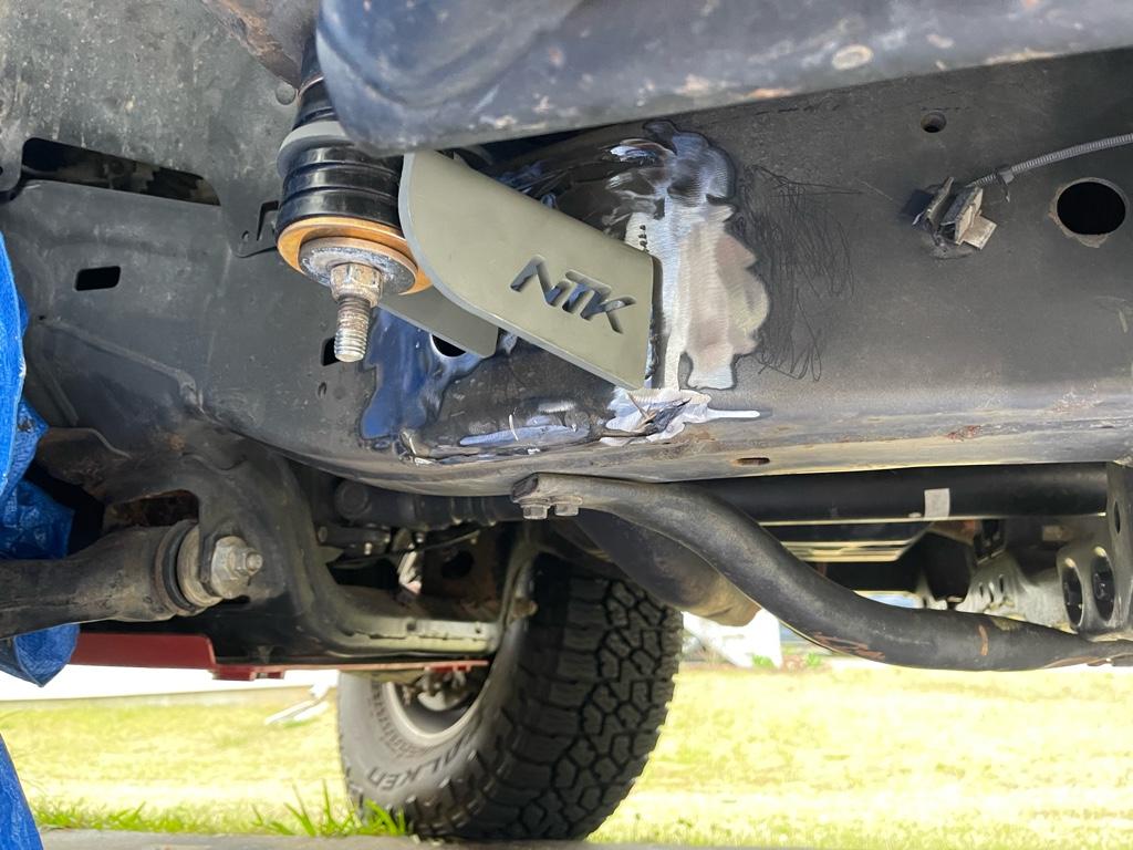

I picked up the mount online from one of the toyota parts vendors. I typically go after the cheapest option google will bring up. With this one I had to find one in stock and ready to ship since I didnt' want to wait. Looks like Toyota of Hollywood is where I got it from.

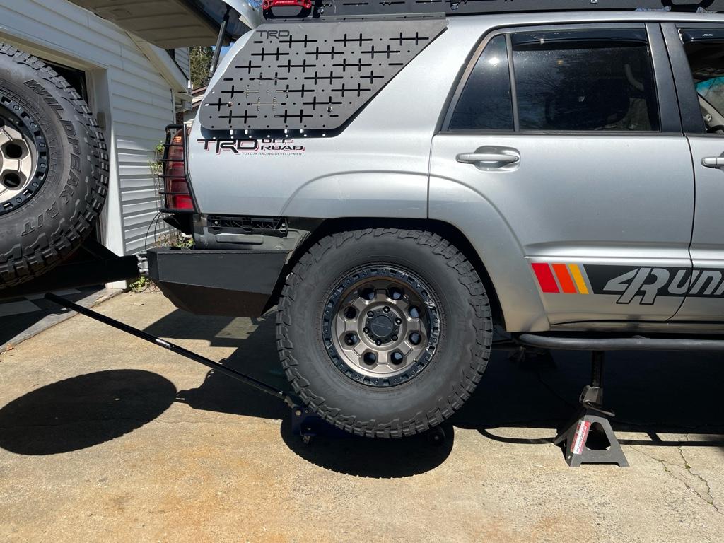

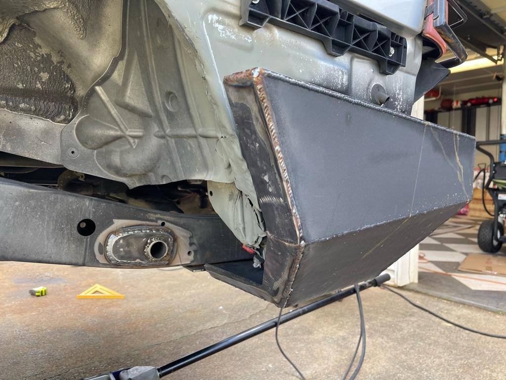

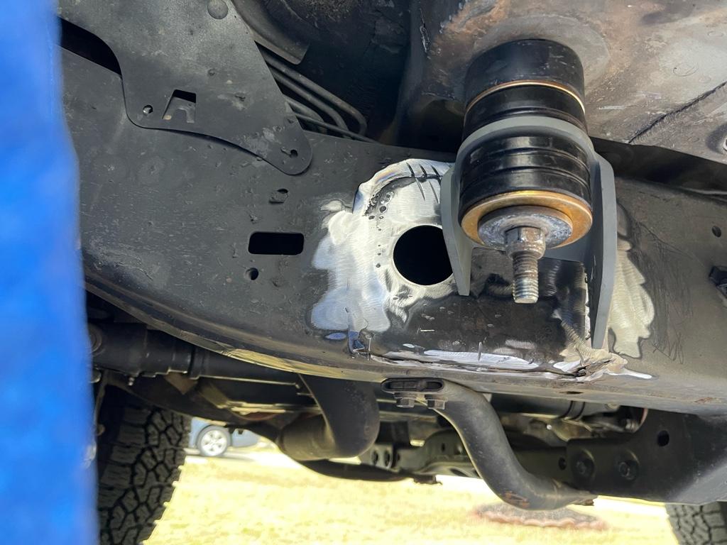

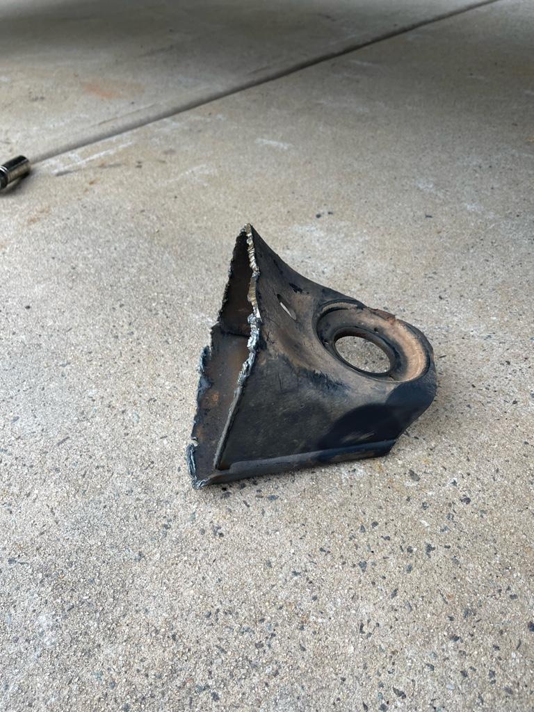

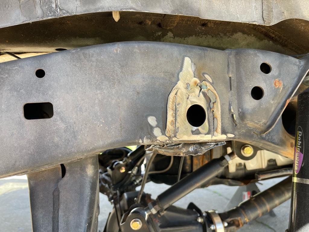

A little progress from today. The drivers side body mount is gone. It was a pain in the ass but definitely doable.. I think a carbide sawzall blade would have done the job less messy and painful.. but since I didn’t have access to that I went with my plasma cutter idea. Wasn’t all that terrible but I hate sparks plying all over me and having bit of metal stuck in every imagine place on my body. With that said.. there is certainly a better way to do it but it’s done lol. Aiming to get the passenger side done tomorrow.
Also decided to clean up and even out the sway bar mounting plates I made. They look a little more similar now
That NTK body mount is looking nice! Did you finish up the rear sway bar?
working on it.. won't have a chance to get to the welder until tomorrow or saturday, so I'm just working on prepping as much as I can to expedite the process once I can make it over to my parents house and get the welder out. really wish I had one at the house.. would be super helpful to know out little things here and there in the evenings vs. dedicating an entire day to go weld lol.
Stay tuned.. definitely looking to have it done before the weekend is over..

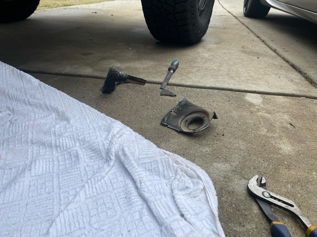

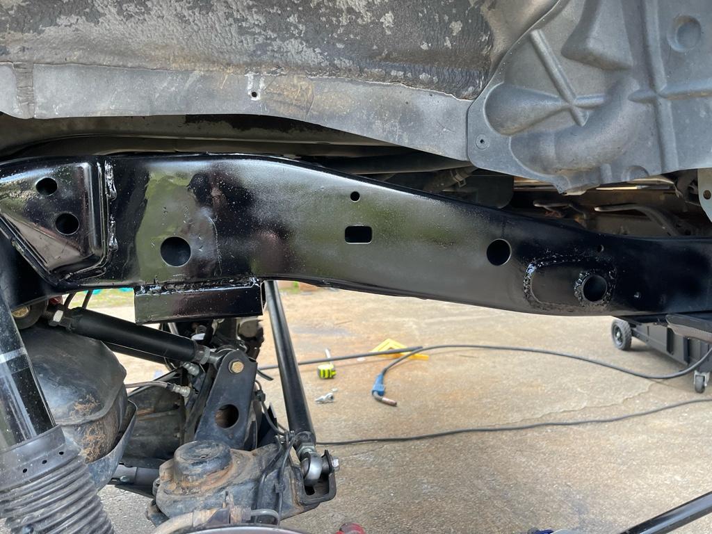

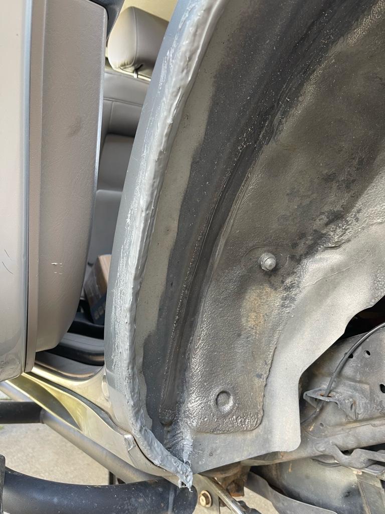

So attempt #2 went twice as smooth and twice as fast.. the trick? Jack up the body once you remove the rubber body mount pucks.. the body sags quite a bit and jacking it up gives an additional 2 inches of clearance to cut nicely across the top
Managed to get the entire mount off in one cut. Both sides are fully ground down and ready to weld.
