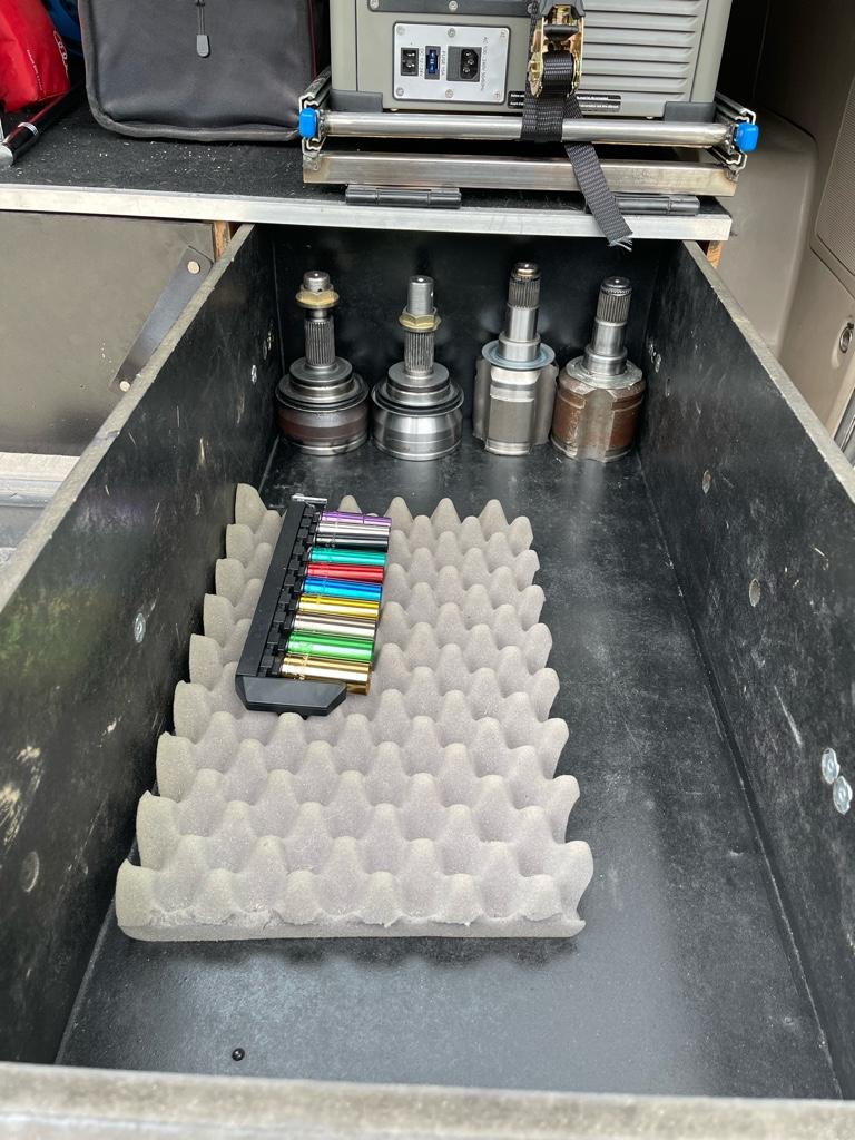

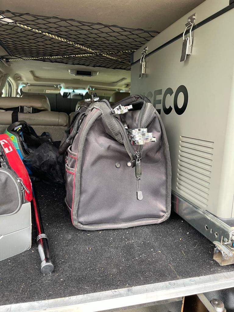

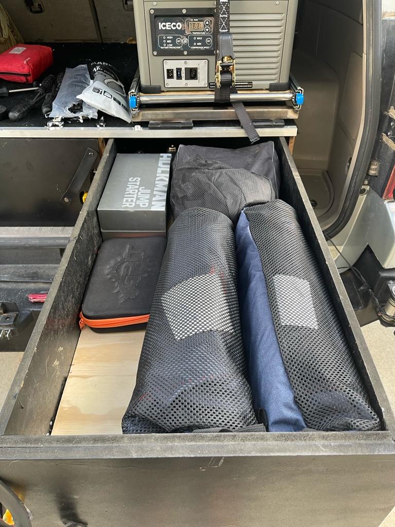

And onto my last rambling update... the last piece to my overlanding/offroading rig puzzle is finally putting together a trail tool kit. I finally acquired a set of tools that should take care of the more urgent repairs and am working through a way to organize them to carry them with me.. I quickly got away from a tool bag idea... packed it up.. and its HUGE and heavy and awkward and I just don't want to take up the limited space that I have left.. so my current idea is to utilize some of the unused/poorly used space in the right hand slide out drawer. My current plan is to use a trap mat to line the entire bottom section of the drawer to lay the tools down into, and then cut a wooden cover piece that will sit right on top and sandwich everything down. It will keep everything from moving around, and also still leave me with nice flat space for the remainder of the gear that will go on top of it.
The only downside, or two, to this is that I would need to have access to the drawer to get the tools out, vs just reaching in a grabbing my bag, and also would need to pull whatever is on top out first. But it's a sacrifice I'm willing to make to keep the out of sight and out of mind while leaving me with space for larger gear outside the drawer.
Everything should be here by Wednesday so I'm excited to get everything together and hopefully FINALLY get out and do some camping.

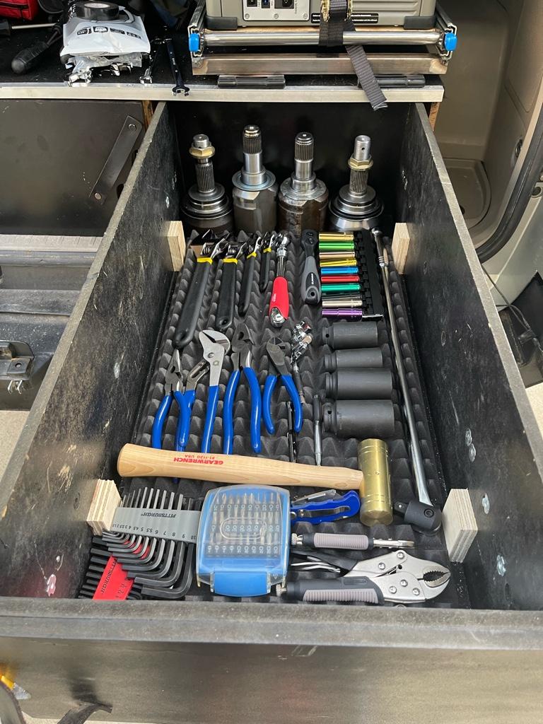

Edit.. here is a pic of the size of my tool bag bs what my vision is .. can’t forget the 4 stub shafts :)
I have that same tool bag thats in my truck 24/7. fits well behind the front seats. I never have any passengers so it works out.
For extended wheeling trips I also bring a small tool roll that gets thrown in with the recovery gear and spare parts storage tote. The tote gets strapped down on top of the sleeping platform.
It probably weighs 80 lbs.....

If it's just for a wheeling trip, I have plenty of space, front and back seats, like you mentioned.. unfortunately for camping trips it's a full house between my wife and 2 dogs in the back seat lol. So I'm planning for a worst case scenario to see if I can get get it organized. I do like the roll-up tote idea in the stock tool compartment. I can't wait to get it this loaded up and see what it weighs... I'm a bit afraid to see the actual number... like you mentioned.. I will probably be adding in excess of 140 additional lbs between the added tools and stub shafts, which aren't the lightest thing I'm packing..

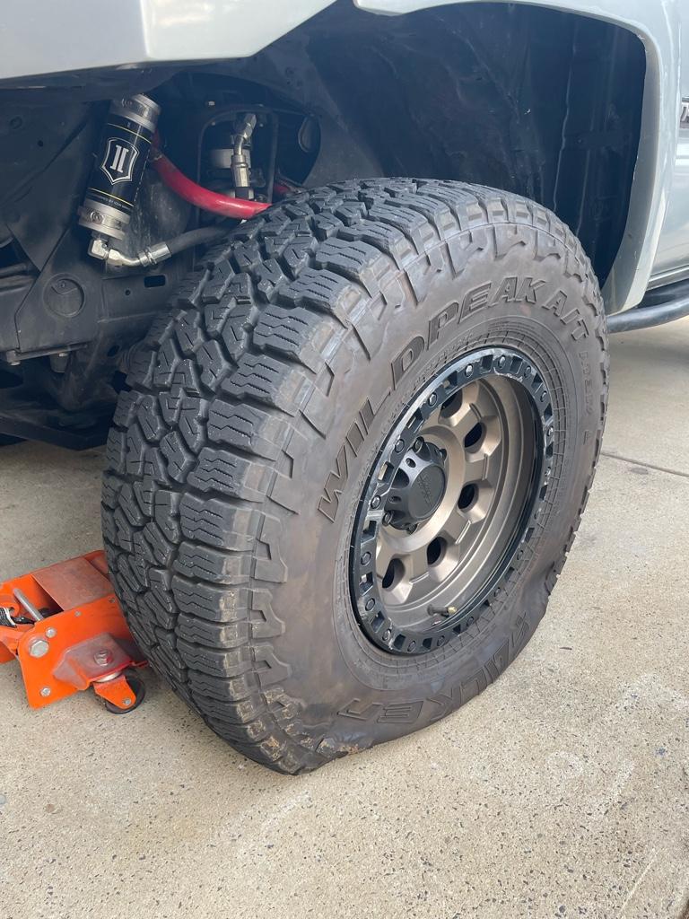

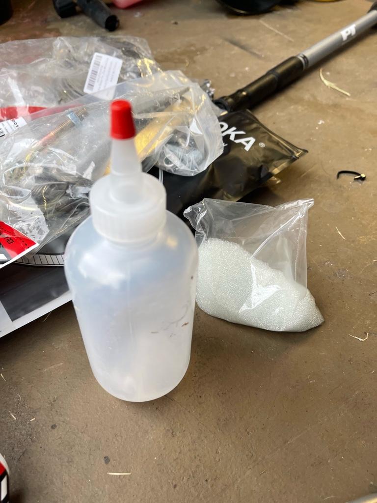

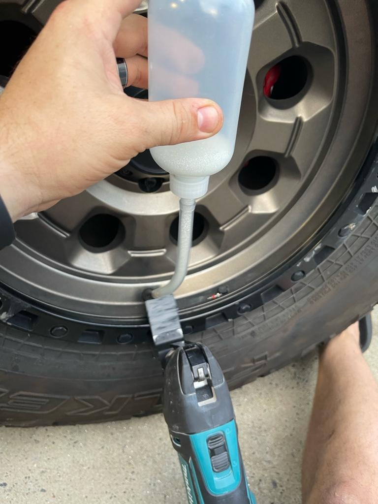

Counteract beads arrived today and I again was overly ambitious about a project.. what a pain lol
Long story short is that I ended up using a multi tool with some electrical tape on the blade to help vibrate the stem since it kept getting clogged with beads. All in all not TOO terrible but my spare tire that is now in rotation ended up having a much smaller inner diameter valve which made vibrating them in impossible. I did that one for about 30 minutes with the squeeze bottle.
Mistake number one was pulling off the weights from the wheels before test driving I think ..
Mistake 2 was probably not getting enough. I went with 12 oz as per the instruction but after seeing the amount of lead weights I pulled off I think I should have gone more..I have 4 6oz packs on the way and will add some.
I did a quick test drive and considering that I pulled all my balancing weights off the wheels it rode pretty decent. Just not AS smooth as I anticipated. Maybe leaving the weights on to start with was a better idea.. though they suggest not suing balancing weights.
I’m also running some elevated psi.. 40 in the rear and 38 in the front .. this was another big change and maybe that’s what I’m feeling as well .. I’m gonna drop it down some across both front and rear tomorrow and see how it does and then pour in the 6 additional oz when the packs arrive. That should net me 16-18 oz of beads, which is way high compared to their chart, but you also can’t go too heavy on them .. at some point it’s just becomes wasteful. Hate that I have to do it again but hopefully it yields a smooth ride from here on out.
Got my little tool stowaway finished today. Nothing fancy.. could have taken more time but I think it’ll work for the time being.. didn’t want to make it too permanent in case I really hate it in actual use.. I’d have to pull everything off of the top shelf to get access to the tools and then put them back more or less how I found them instead of throwing them into a bag.. so we’ll see. Like the idea, but maybe it’s only best in theory not practice lol.
I’ll have a roll up box wrench organizer that will go between the backseat and the drawer system too.
So a quick update on my wheel balancing situation... I'm ready to get new tires and go to 37's now. lol
I installed 12 oz of beads into all 4 tires. I "THINK" I made the mistake of pulling off all the original wheel weights. In order to remedy the situation, I bought some 1/4oz weights from amazon and spent some time trying to re-install some weight where I could see the old tape still. That did not seem to correct any balancing at all.. adding a bit more weights in places made it worse, now I am back to pulling all the weights from the wheels up front.
It's not super terrible, but I have a vibration that comes and goes and its kind of driving me nuts... I feel like I definitely wasted hours of work and $100 bucks with the beads since the balance isn't any better than it was with the regular wheel weights that were on there, not any worse. So anyhow.. I'm just lead to believe that these wildpeaks don't balance out too well once you get some off road miles on them.. which I did read before getting them that folks were having issues with.. who knows.
Annddd the last update i'll probably make on the balancing situation.. after I posted the previous update I had to take the rig for some errands, and the steering wheel shake just got on my nerves really bad. I was feeling it at 45mph.
Got the rig home and decided to rotate my tires front to back. Luckily, this resolved the steering wheel shake up front. I obviously still feel a bit of a vibration that comes and goes from the rear, but that is much more acceptable to me. Progress has been made. :second:
The rear set of tires included 1 brand new spare that I put on after my wheel-off incident, so I'm assuming it's just significantly better balanced along with the other rear tire that was also in better shape than the 2 front ones. I'll drive it around as it for now and see what happens. But log story short... though balance beads seem to work for some folks, I think my wheel/tire combination is just too far out of balance (as signified by the amount of 1/4, 1/2 and 1 oz weight combination i've pulled off from the previous balance) to work properly... I have 18oz of beads in all 4 tires and am not willing to keep experimenting with additional weights.. they get pricey and too time consuming, and not to mention.. I'm almost double the recommended weight from counteract's spreadsheet lol.:bounce:
