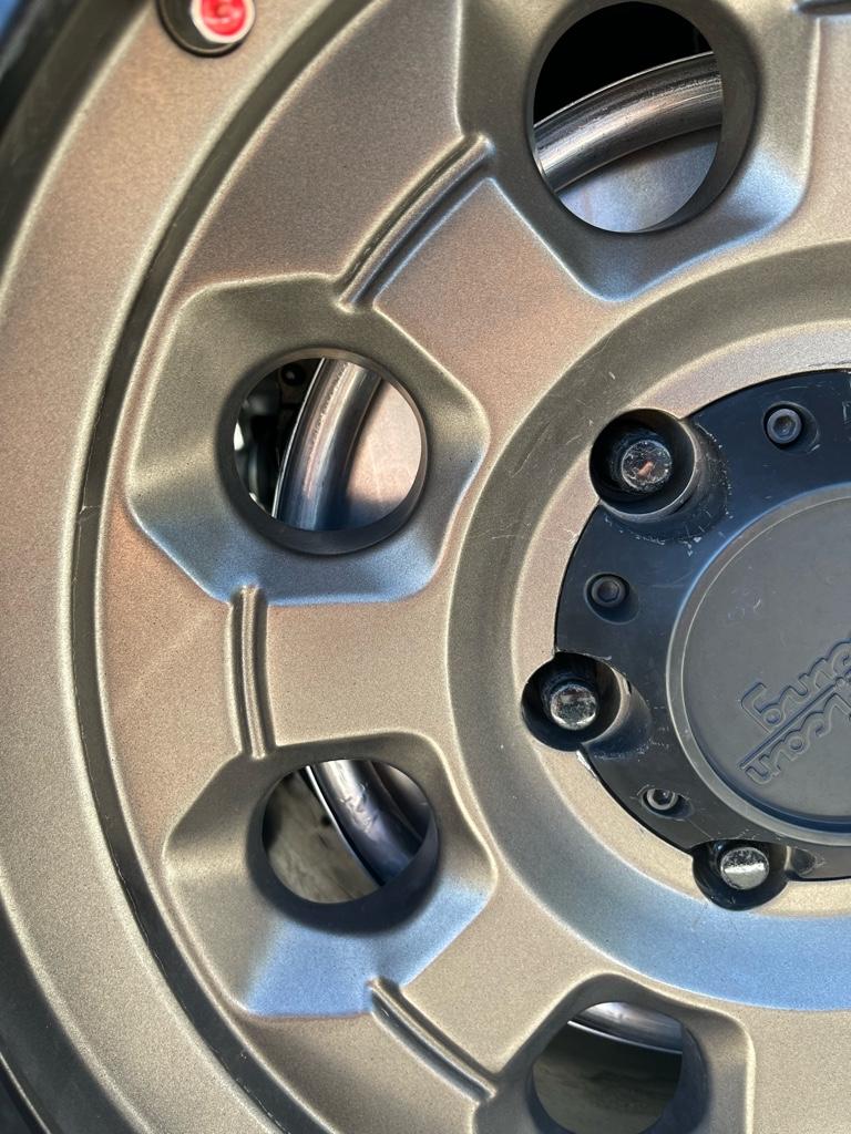

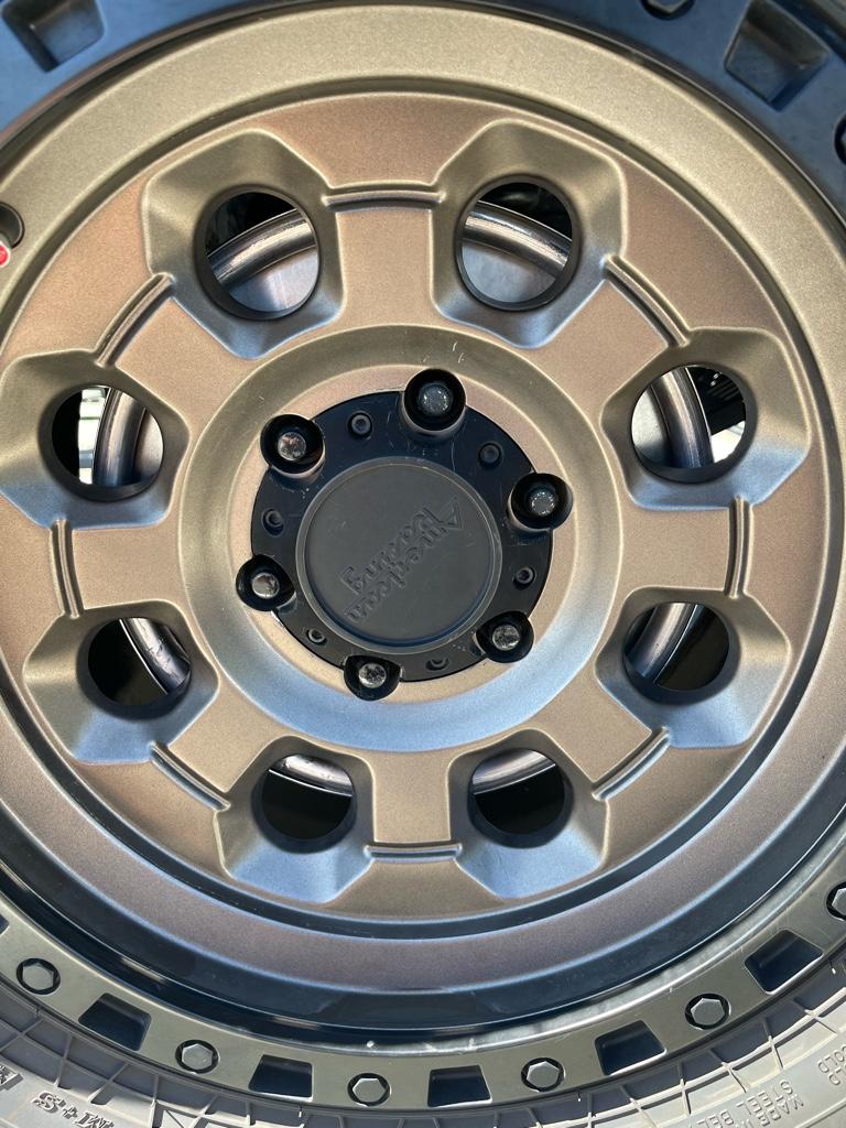

So after finding out about these centramaric balance disks.. I decided I had one last ditch effort for balancing..
Found a local set that fit to check which spacer I needed to run.. I can say with confidence that with the sport brakes I needed a 1.25” spacer.. the 1” did not clear… I also found out how thin the sidewall on the calipers are with the aid of a grinder… well.. 2 new calipers and a replacement set of 1.25” spacers that i traded a local member later.. I have these on.
Amazing… just about all of the vibration appears to be resolved after 2 quick test drives down the highway.. there is a tiny , almost unnoticeable vibration that still shows up, but overall it is just about all resolved..
They look a little funny.. but now I don’t have to worry about what my calipers look like I guess.. lol. You can also hear the beads rolling around under 15mph but it’s not bad, just thought it was interesting.. anyhow.. pretty stoked to keep trying this out and see how it goes..
