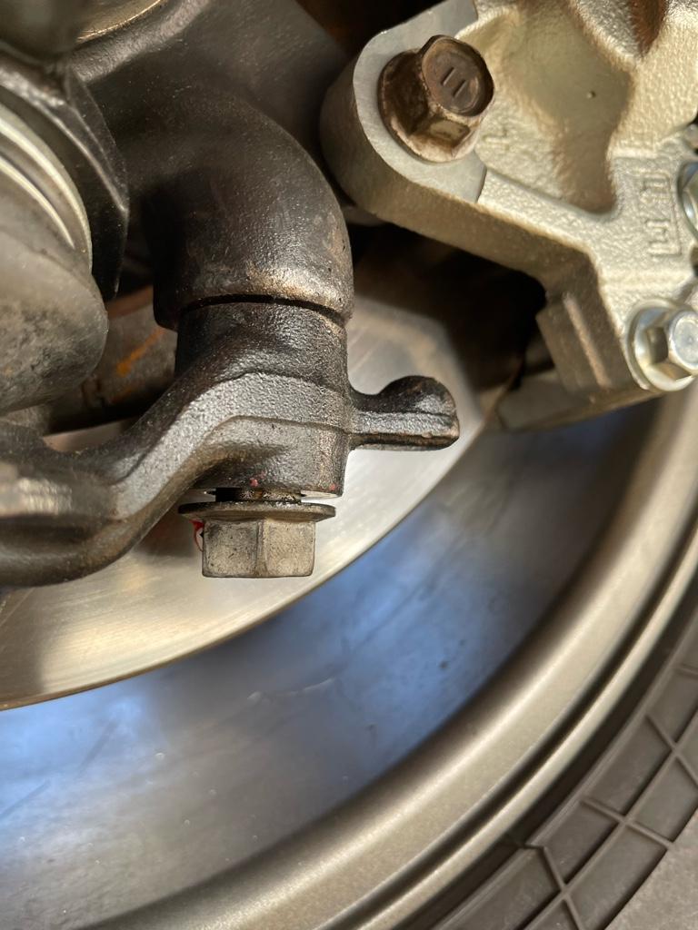

Have been having a bit of some interesting suspension offloading pop I kept hearing that I could track down... in the process of checking torque on the front spacers after 50 miles I just happened to notice that both of the bolts to the lower balljoint bracket on the passenger side were about half way backed out. Broken visual marker and all obviously... probably quite some time ago.
Talk about a timely damn catch. That would have been fun trip down memory lane once the bolts came all the way out. Time to go back through and doublecheck everything I have touched. Stay safe everyone.
Here’s an idea, instead of looking at supercharges and motor swaps.. I should probably quit being an idiot and torque suspension bolts and check them to make sure you don’t repeat some road failures, you big moron you.
I've been lucky with just tightening the snot out of those bolts with a 18" breaker bar.
The head is big enough you might be able to drill a thin hole through and wire tie it to the ball joint 'cradle'. Might be hard to drill through.
