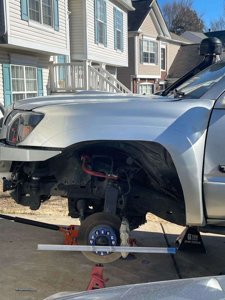

So now I'm questioning my own suspension with the modified Tundra Rack. I've been getting some bump steer ever since I installed Dobinsons 749V rear springs. I have Kings 700lbs springs up front. Running a little stiff, but my rig is heavy. Looking at the Iron Man rear springs for a 3 inch lift, the free height of those springs is 420mm and the Dobinsons free height is 500mm. So maybe you think I should also look into those Iron springs to help with bump steer? I do have a slight rake from the rear being lifted, but levels out when I have all my camping gear with the 749V springs.
I'm a little green on this and suspension geometry lol.
I'll apologize in advance if anyone read through the last 3 posts of blabber :focus:
I'm every bit as green as you are with this. Mostly speculation on my side, but does seem to make sense lol.

But yea, I would definitely take a look and see at how much toe-in you're seeing from ride height to full droop. I just throw some painters tape across the tire, mark the centerline and throw a jack up against that line, jack it up and measure how much the line moves from the pre-set jackstand edge at full droop. Even factory will have some, so a little is anticipated, but if you're seeing anything like I am with the current setup it's troublesome haha. Ideally, you would need to pull your coilover out and be able to fully cycle from full droop, through ride height, up to full bump and see what it does.
Got 2 inches of apparent lift and lowered the front suspension, win win.

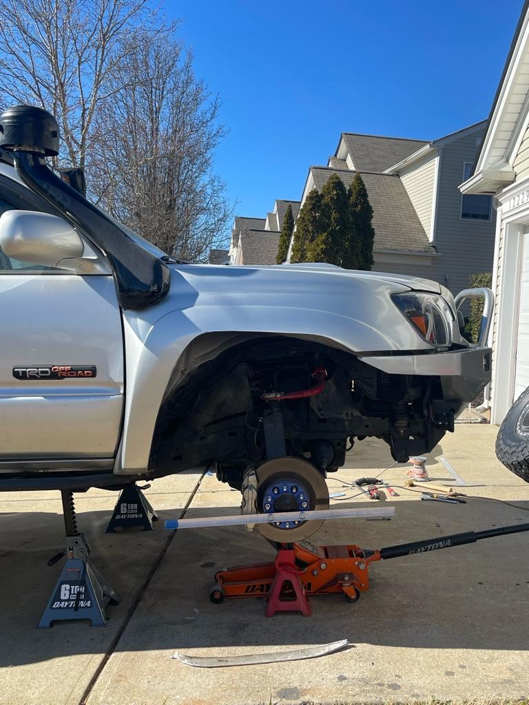

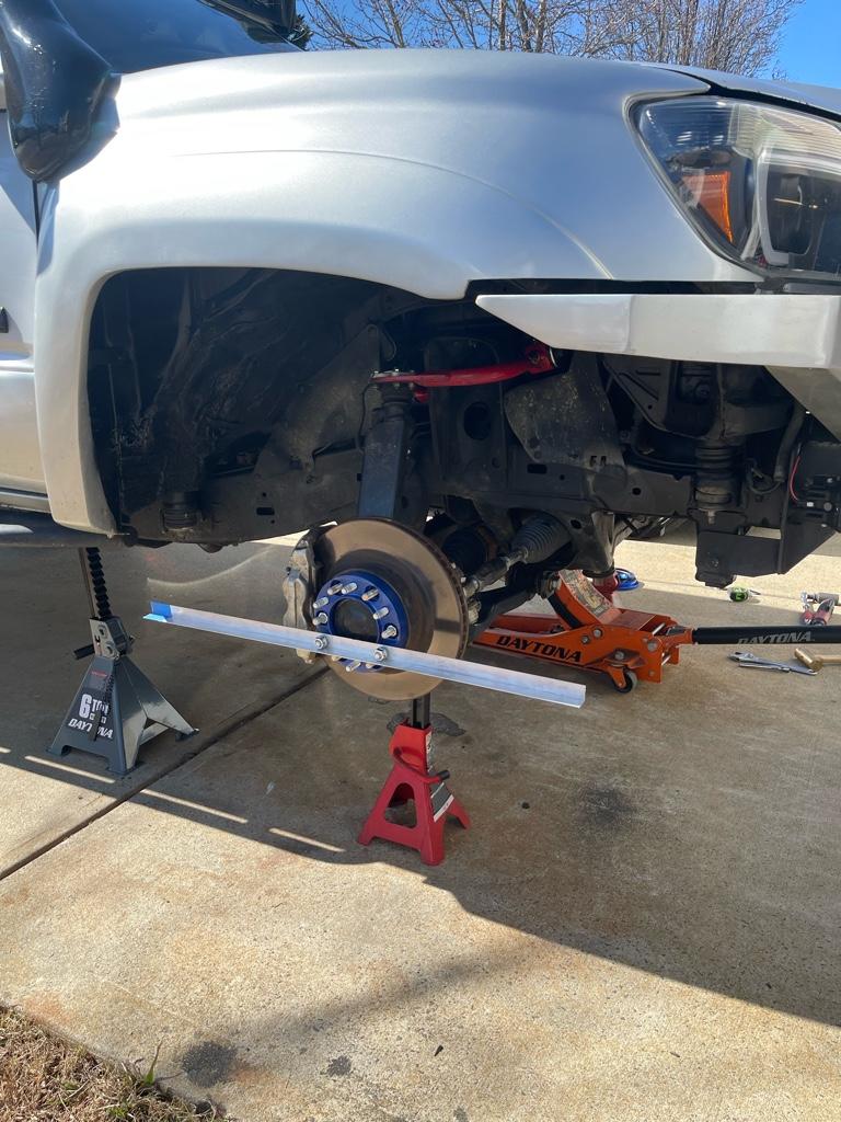

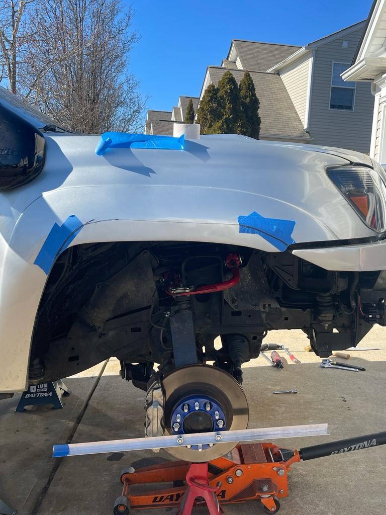

Also doing a dirty alignment to get her road worthy once the shocks deliver .. jacked up both tires to where I think I’ll aim for with front ride height and pulled front to rear measurements. I’m certain it’s far from perfect , but should get me close at least.
I targeted 0 degrees of toe with even spacing front to rear since everything down travel from this point will toe in. But hopefully not very much with the heavy rear springs out for delivery.

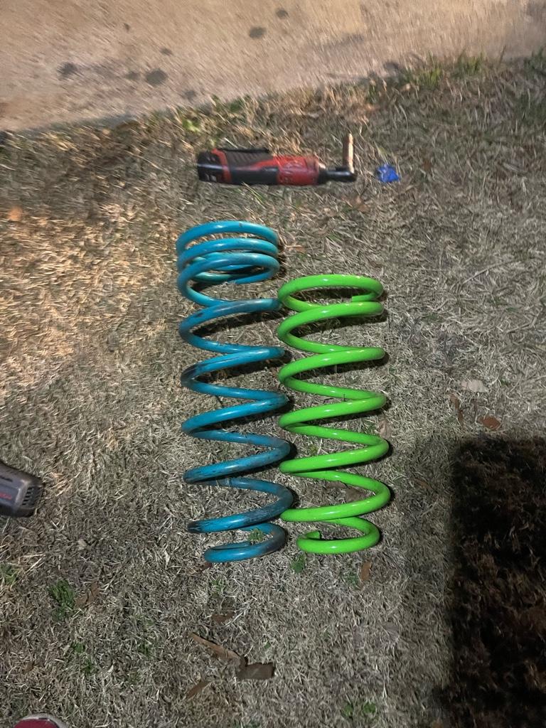

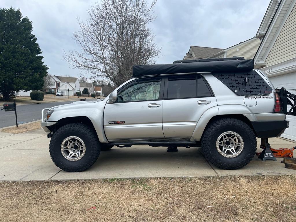

Got my EMU coils and spring spacers. Got both installed along with my previous Dobinsons LT shocks. Gained a bit more height than anticipated.. probably close to 3 inches from my measurements. I know the springs will settle , but I’m very likely going to pull the hard mounted upper spacer off and just leave it with the new springs and my 2” urethane spring spacers. Should get me the needed 1-1.5” more that I was looking for.
Happy to report that jacking the rig up in the air , even with them 2x down travel, the springs stay in place .. I don’t think I need limit straps. But I might entertain the idea just in case.. it would SUCK to drop a coil when out and about.
Now I just need to re test my previous icons up front and dial in the added height there and it should be good to go…
Oh and in this picture I’m sitting fully on my bumps with no shocks or springs, 1” of clearance all around.

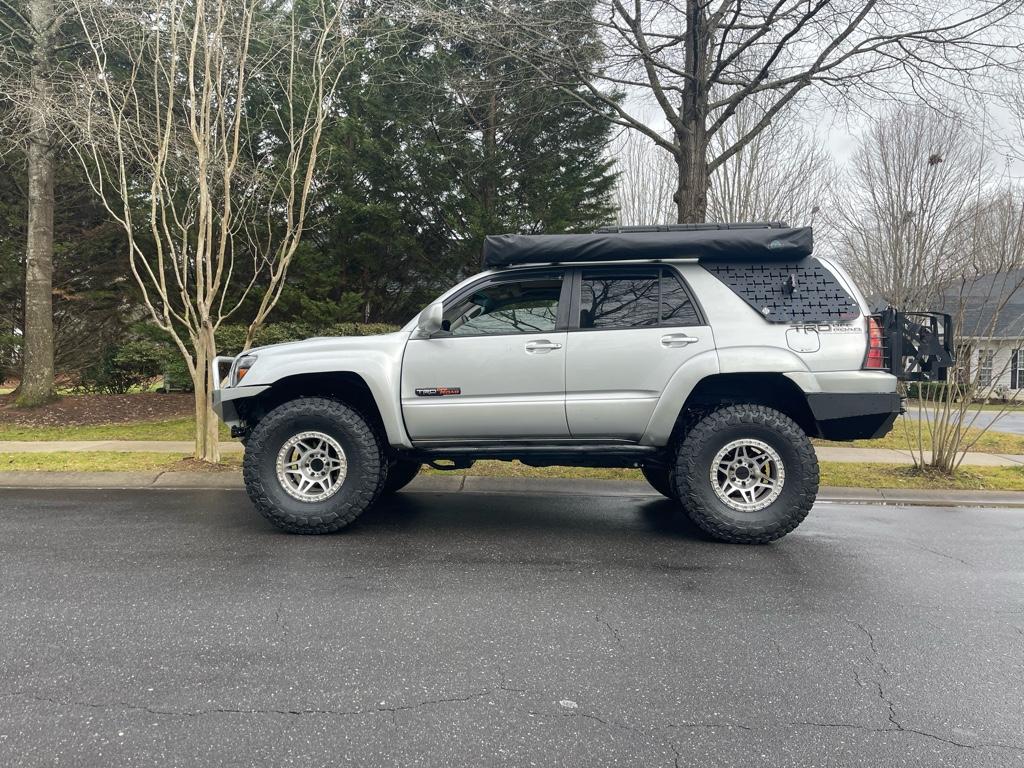

Spent today reconfiguring my suspension.

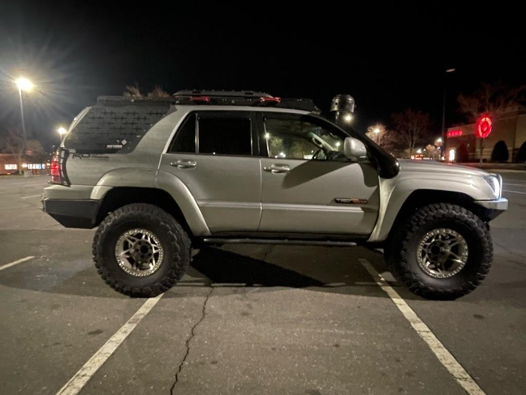

Dropped the rear lower and threw in my icon 2.5s up front and raise it a bit. I think I’m finally at a livable hieght that doesn’t scrub tires under acceleration. I will say that the icon shocks are a lot softer on both compression and rebound so the same rear setup tends to squat more under load just because of the front shock difference.
It’s still got some weight to be added in the rear with the spare and these OME springs will for sure settle some but as it sits there’s a little bit of rake which I don’t mind for when I pack out fully for camping.

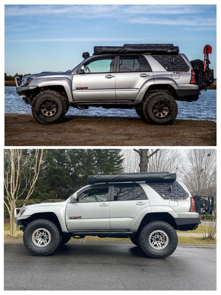

Did a bit of comparing to my old pictures just before the wheel swap and I think my mind is finally at ease with the current stance.. I forgot just how much rake I was dealing with prior to swapping over to the new setup and jacking up the front like 2 inches.
As it currently sits its not visually idea for me.. I would love to bring the front up another inch, or more, but the reality is that I'm limited by bump steer on the lc200 rack setup. If I could rework the spindle to be able to mount the outer tie rod an inch higher I could go up, but that's a different project for a different day (or year even). I don't think it's worth the effort at this time. Not to mention it's quite possible these OME springs will settle a bit more in the rear giving me a bit less rake. Plus I still don't have my spare mounted AND it's fully unloaded without my camping pack-out. I could very well be fully level with it packed.
I put the rear sway bar back on so as it sits now my setup is:
-Icon 2.5 front with no sway bar (due to impact on the inner tie rods at droop+steer lock)
-Dobinsons LT rear shocks with EMU 899 heavy springs (1.5" daystar spacer on the drivers side to correct lean) with factory sway bar
now I just need to sell my brand new Ironman setup.... which I'm still on the fence about lmao.. I did like the ride quality being stiffer and had next to no squat under acceleration.. but the biggest thing was at my desired ride height in the rear.. I had only a few inches of downtravel left.. and I'm not splitting up the kit just to run the front shocks :lalala:

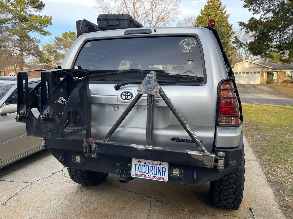

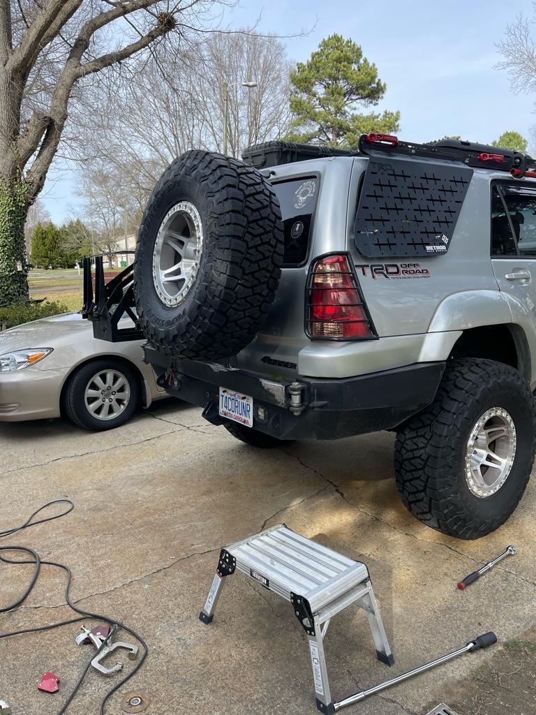

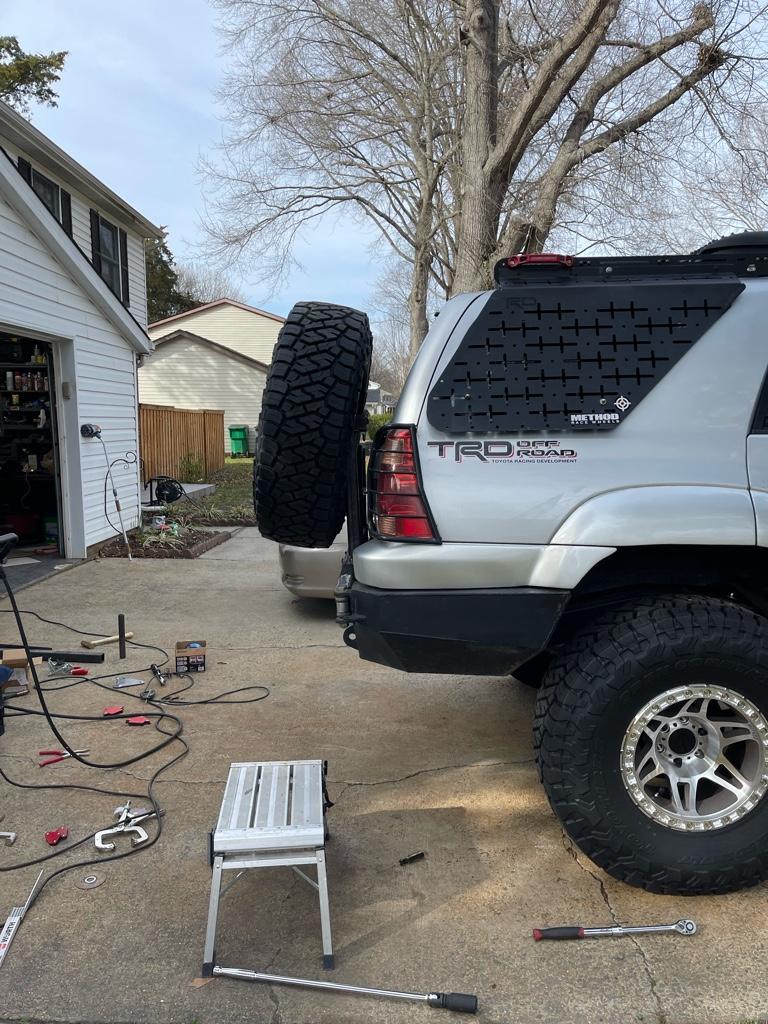

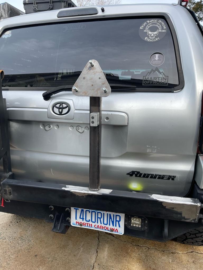

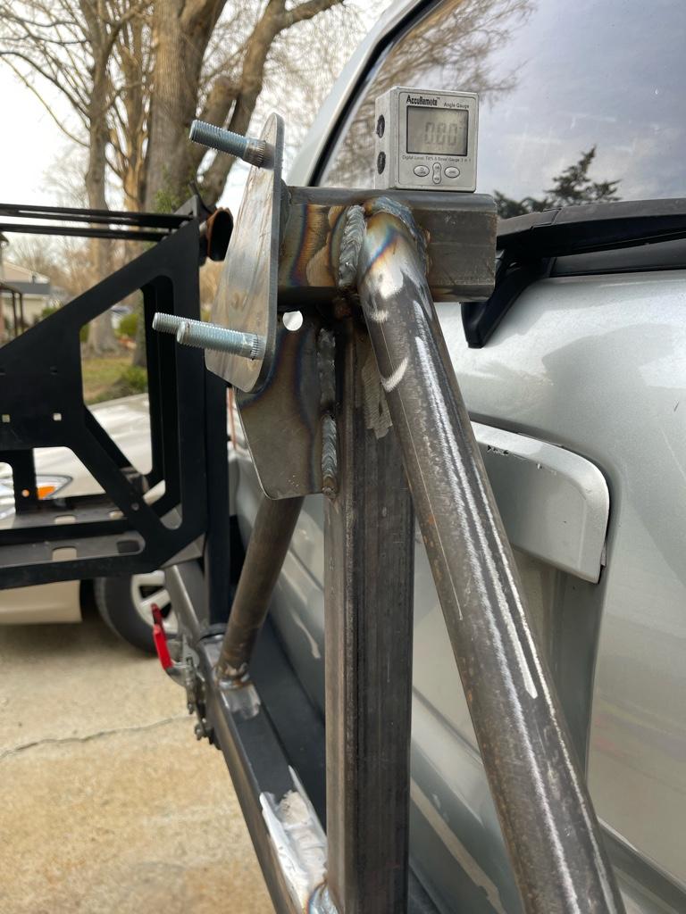

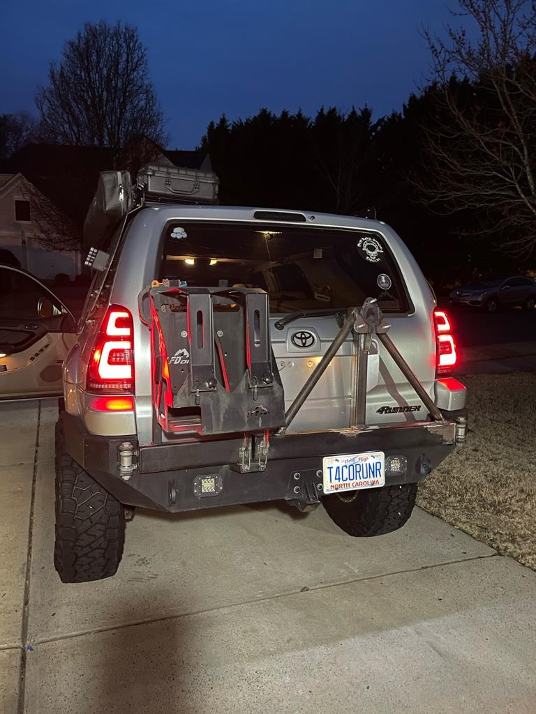

Did a little cutting and welding today. Still need to rework the latch mechanism and weld on a lockout , but man.. super stoked about how it came out . Sucked in as far as it will go against the tail gate, up in the air and with a nice angle to it.
Oh yea .. I also finally fell for the recent tail light trend .. quite an upgrade in looks for sure
Spent some time yesterday replacing the now-sloppy heim joints on the tire carrier swing out side (luckily I had 2 spares from the bulk purchase the first time around). Got everything cleaned up and lubricated back before assembly, and made a slight pitch adjustment so it closed in more level. I have a feeling the main runner warped just ever so slightly when I ran the super hot bead for the new upper runner.
Also took a bit of time and redid the landing pad/latch mechanism. Instead of the soft rubber pads, I got some HPDE sheet and built a new landing pad/stop that wont wear out/sag like the rubber did, but also made a slight adjustment so that the latches pull straight up when locked. Before the hooks sat a bit further in and made for a slight angle pull when closing. Super happy with how solid it all came out.
The plan for today is to trim off a bit of excess on the new carrier, sand, prep and paint it while I'm on my lunch break and hopefully give it enough time to slap the spare on after work. I haven't fully decided yet.. but just as a back-up safety measure, I may run a strap through the tire and around the upper carrier member and had tie it to the bumper.. that way IF anything does fail down the road (which I can't imagine happening with how solid everything came out) it alteast wont go bouncing down the road :ballchain:
REALLY starting to fall in love with the changed up look, definitely made the right choice across the board.
