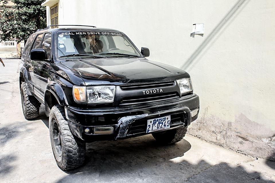

Here is mine with a kind of TRD Pro grille.
My front bumper is off don't pay attention
That grill is crazy. I still want to do a Satosh at some point, just need to find a 96-2000 grill and some time.
Just fyi you need a 96-98 grille. The 99-00 grille is similar but would require a lot more body work to make it look good.
