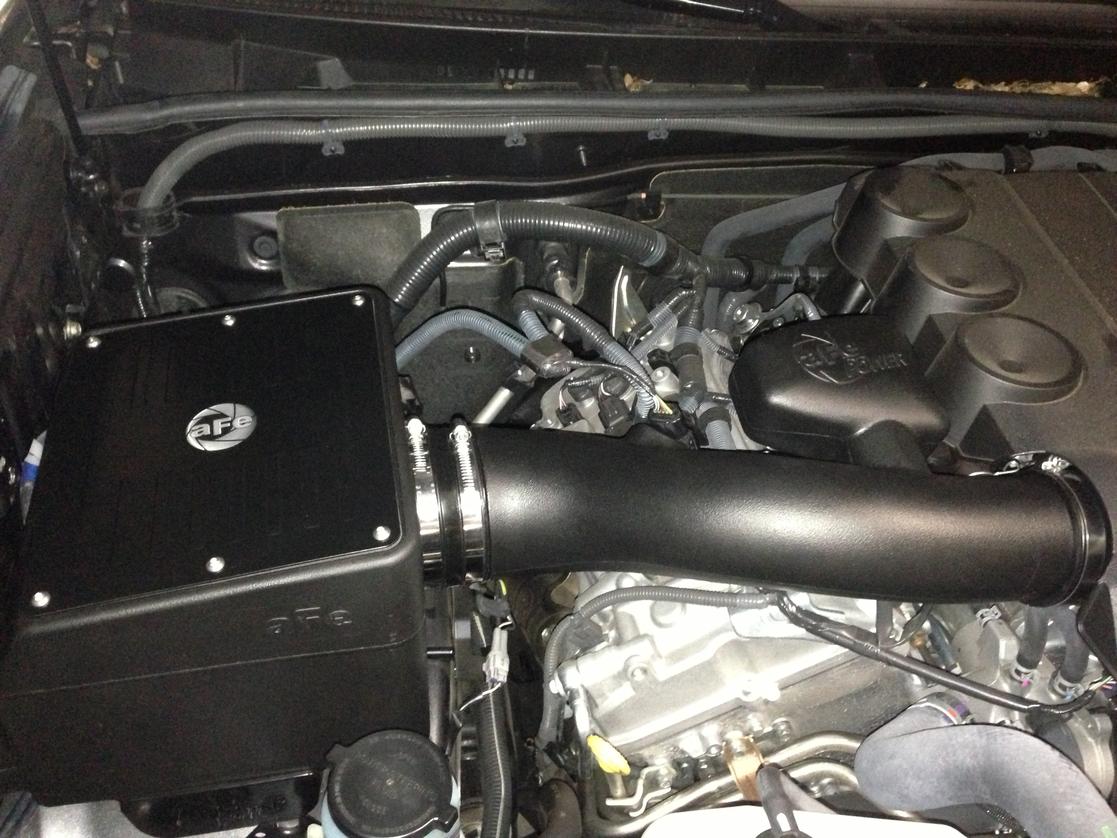

Well, it's finally installed. The seal trim actually wasn't too bad to install like everyone said, it just needs to be pushed hard to seat it on the inlet area. What made it easier for me was to start one end in the middle of either the top or the bottom, seemed like it held only the inlet hole better while putting the rest of it on.
Took me longer to install than I thought it would, but everything is made really well. Will let you know after I drive it but the rev sounds a lot better than stock.
