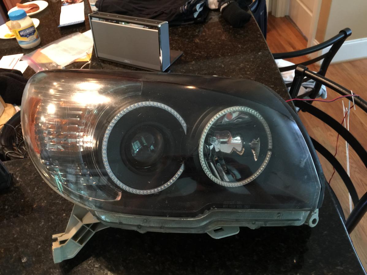

Well my is melting/warping around the projector... One side looks exactly like steveandstaci's picture a page or two back. I don't think I can get a refund due to the fact that I have modified the housing and installed halo rings. It's really frustrating that you can find a perfect product anymore.

Well, the melting and cracking happens 06-09 due to the sun light reflecting off the projector making the projector focus on a little part of the housing just like you holding a magnify glass out in the sun. I'm bulbs fit pretty good in the housing I didn't have to do any modification. I don't know about the 03-05 headlight.

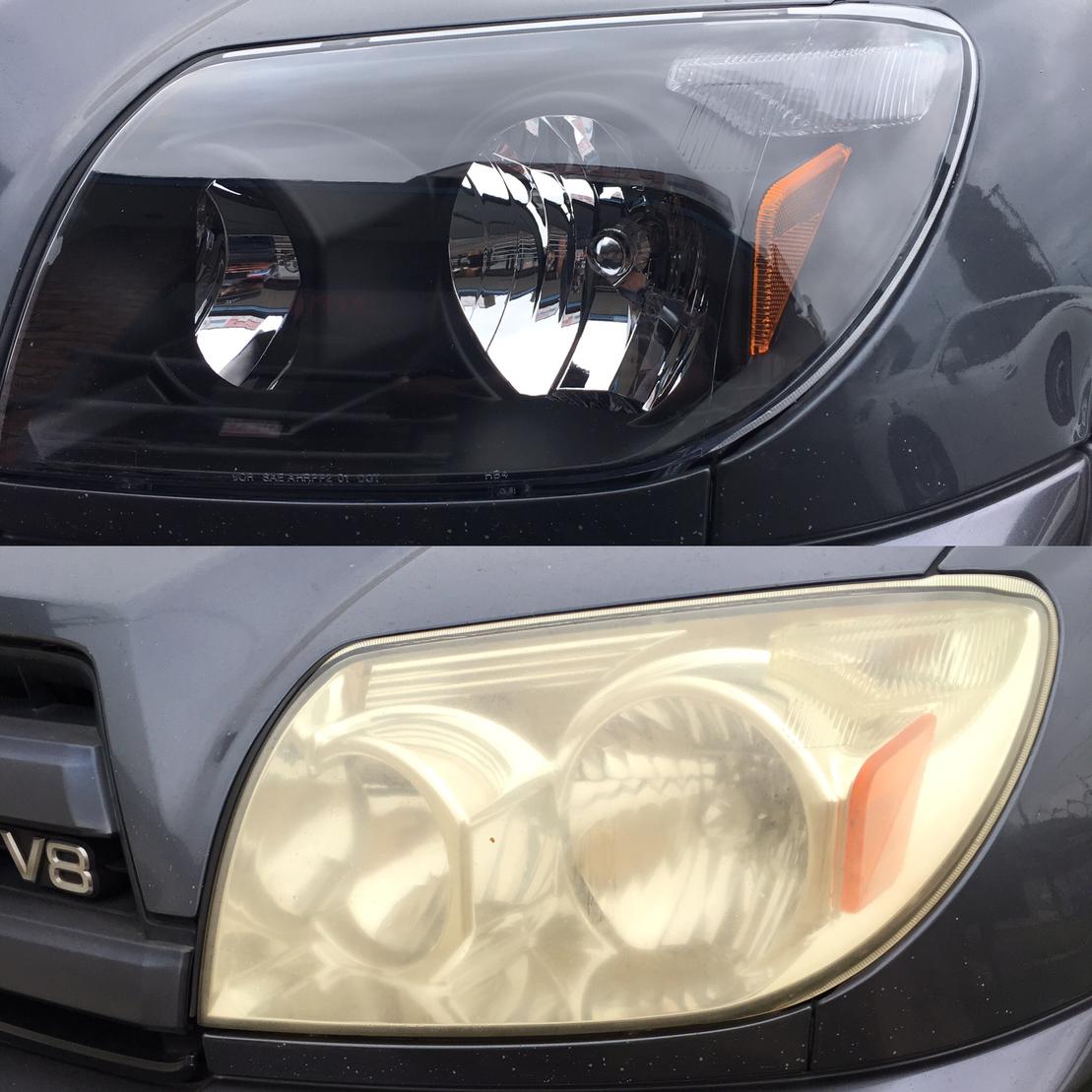

Hi folks. I am new to the forum and to the 4Runner. Just bought a 2006 and the headlights need replacing. Both are yellowed/cracking and one has almost constant internal condensation. I really prefer the look of the black headlights, but, having read this entire thread, the quality seems hit or miss. Does anyone have any success stories to share? I am ready to replace mine, but am reluctant to order the aftermarket lights. :(
Pics of my current headlights:
IMG_2557_zpstgbhj2xr.jpg~original
IMG_2556_zps4npc8pni.jpg~original

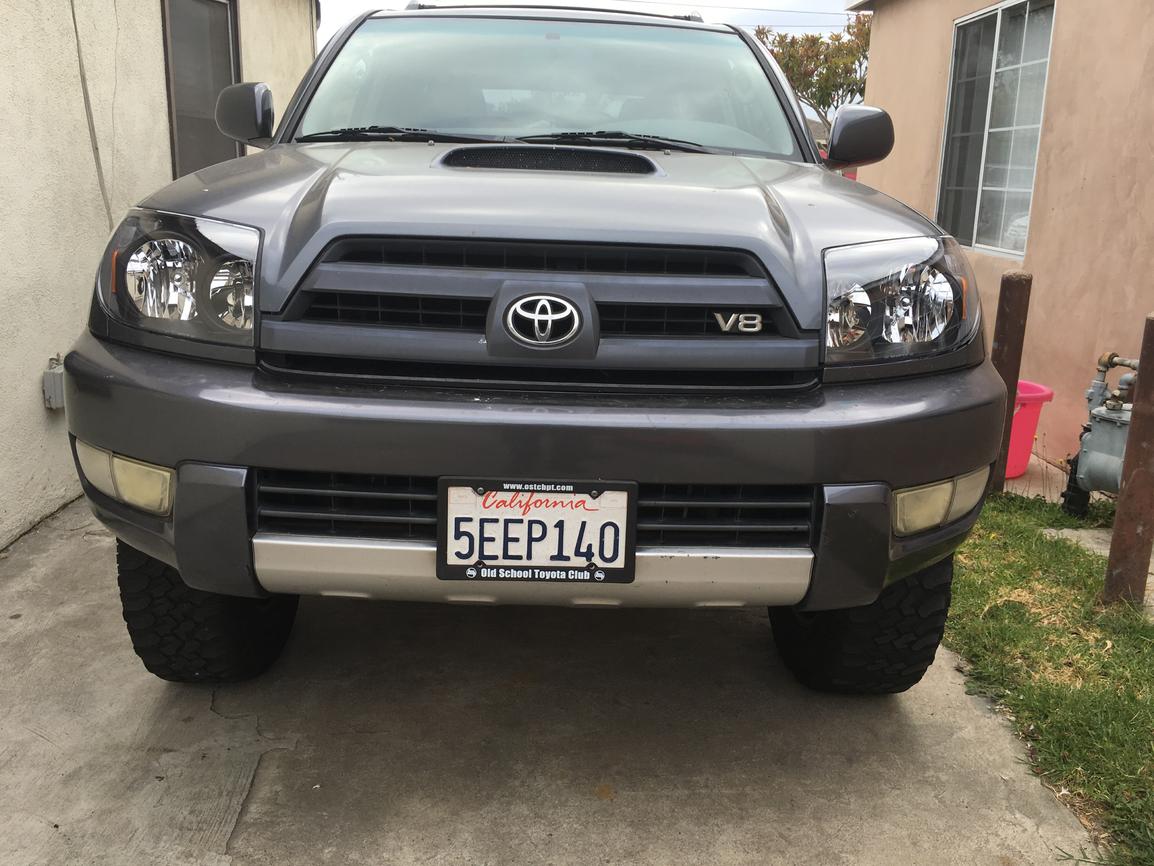

I'm finally in the midst of replacing my headlights with aftermarket Spyder lenses. The passenger side went well, but I ran into a problem with the driver side.
There's a few threads on updating from '03-'05 headlamps to '06-'09 units, but I'll give you a rough list of what you'll need:
  • New Low Beam Bulbs (the projectors use H11 Bulbs vs. the old 9006/HB4)
  • H11 Connectors with pigtails to splice in place of old 9006/HB4 connectors
  • New sockets for the turn signals (they use the same socket as the '03-'05 turn signal assemblies in the lower bumper; you will have to make up your own wiring if you want them to work, but I recommend them to seal the housing at the very least.)
  • Weatherproof Butt Connectors to splice the wires (these are the ones you heat up with a heat gun and they melt and seal the joint, very much desirable in this appplication)
  • New filler panels that go under the headlamps (I would use a website like partsouq.com to get the part numbers and/or buy the parts.)
That's a rough list of what you'll need to make them work.

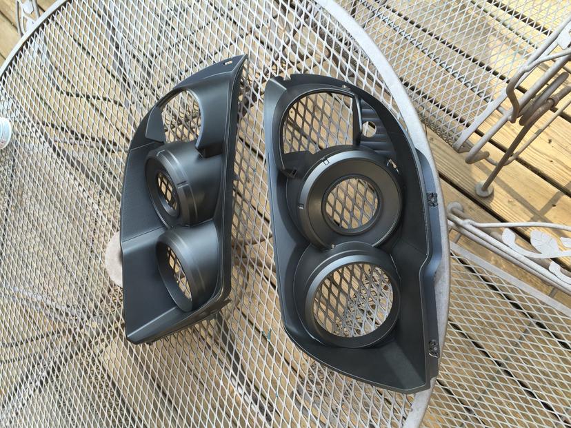

Plasti Dip

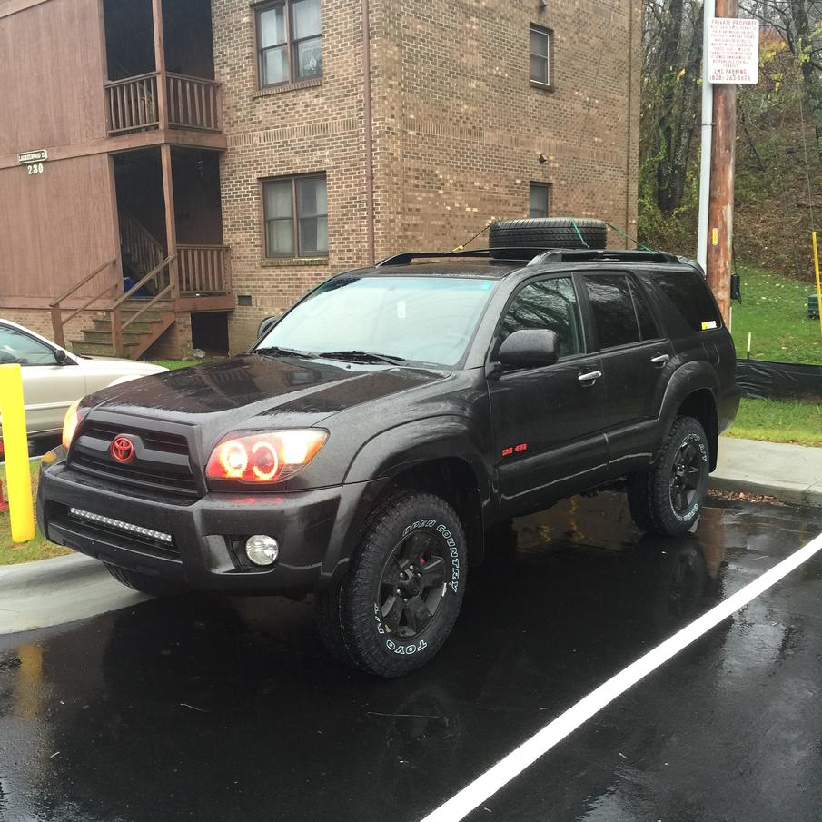

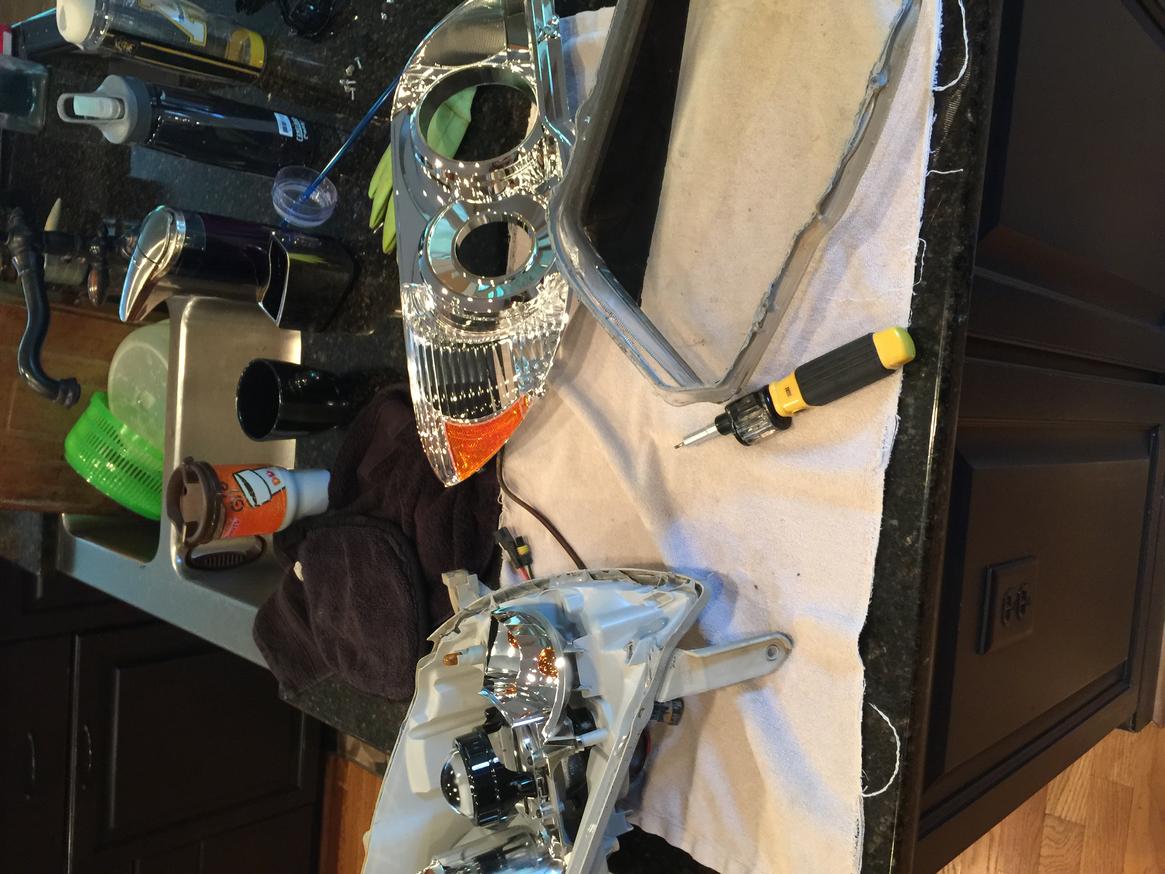

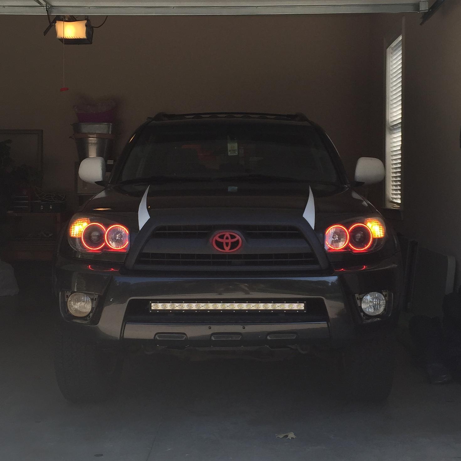

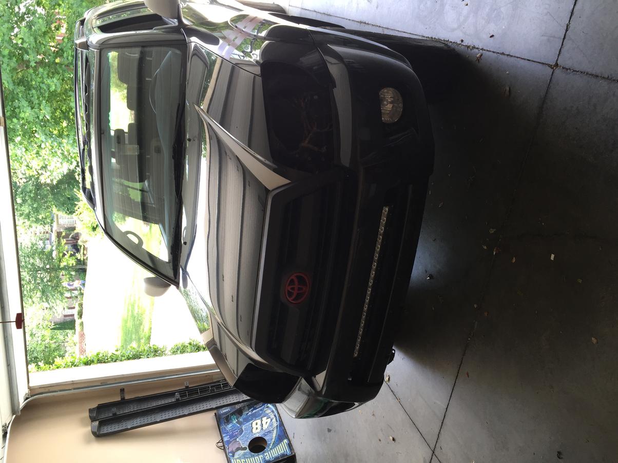

Hey all,
I know the thread says "aftermarket" but this was all homemade. Let me know if you have any questions.
