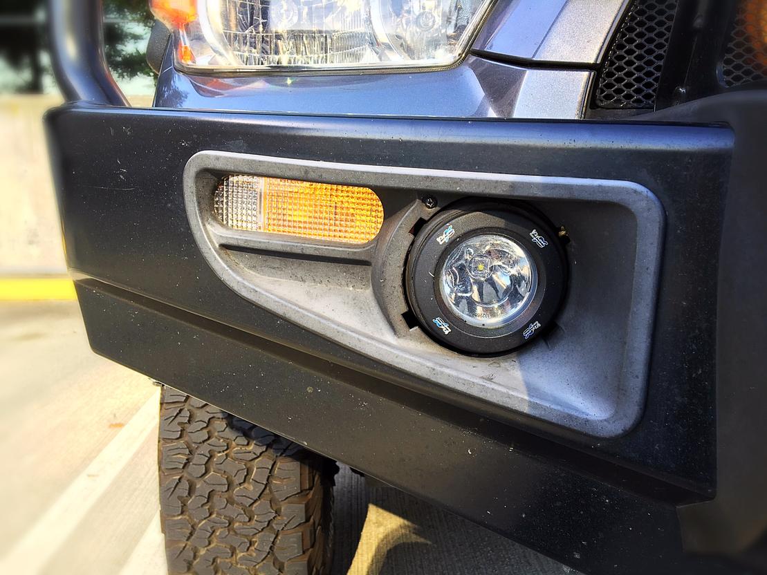

I made my own setup using a few different components I already had, including the ARB fog light kit.
Works great but if I add it all up it's probably about $400 +/- from memory. Each part was bought independent of the other at some point in time. The blinkers are LED and the fogs are LED - now if I only had a picture, lol
Here is my setup...used the default blinker but removed the internals and retrofitted with a VLED V3 Triton (which is sealed). I had originally used LEDs meant for semi-trucks and used silicone to mount them (worked great) but these had individual LEDs burn out rather quickly...so made the switch and went back to the ARB lense.
On the Foglight I used some Vision-X fogs meant for the Jeep JK (direct swap kit) and leveraged the ARB fog kit housing (removed the light part) and retrofitted the Vision-X to fit inside so I could retain the mounting and ability to aim the lights
