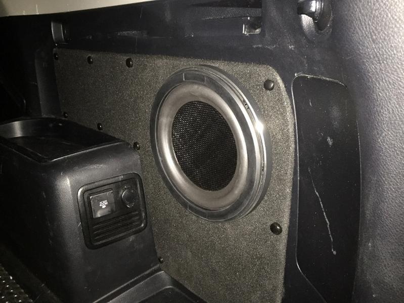

This was the solution to the subwoofer placement issue I had. I didn't want a huge box held down by straps. I used a local sound shop to create this custom enclosure for an 8" sub. Its driven by a nice Phoenix Gold RX600.5 amp under the driver seat. It's a custom fiberglass enclosure. My installer has a template for it in case anyone in the Las Vegas metro area is interested in having one done. This provides plenty of thump and doesn't impact the space in the cargo area at all.
How's that working out for you? Looked at having something like that done a few years ago but the shop said there wasn't enough air space behind it for an 8" sub and ended up building a custom enclosure for a 6" in front of the power outlets back there where the D ring sits.
I am happy with the sound and location of the sub. I discussed the merits of a sealed sub vs. a ported one. This is a sealed set up. The bass is tight and thumpy which is perfect for my rock and country music listening. Down the road if I decide to go with a larger sub we would bump that panel out and make it more flush with the wheel well to incorporate a 10" driver. For now I am beyond pleased. The finished system is light years ahead of the factory system. :guitar3:
