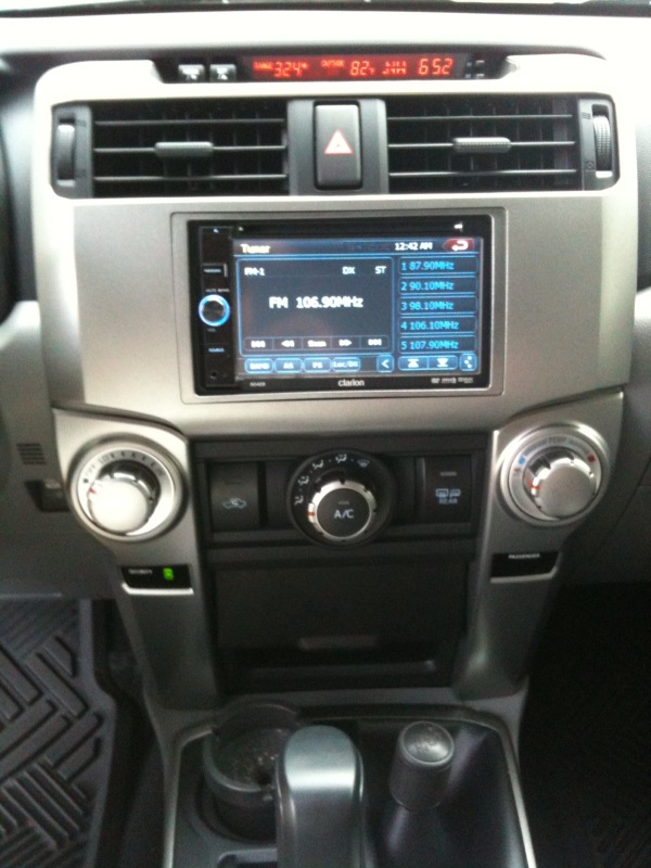

Installation only took 2 1/2 beers...I am impressed with the quality of the Metra kit. The only thing I am not thrilled about is the fit of the trim ring that comes with it. You can see it is somewhat "bowed" and it isnt flush in some areas. Overall, it was a pretty simple install. The only problem I had was that my new Clarion touch screen's...touch screen didnt work!!!!!!!!! Minor setback. The place I bought it from was out of them so they lent me this older unit. The dash is probably one of the simplest I have ever taken apart...and I used to do auto body. I think I might paint it flat black before my new unit arrives.

Kevin, thanks for the pic. Looks good but I see why you might not be happy with the trim piece. It appears it may be a bit too big causing the bowing. Have you given the feedback to Metra? Could it be an install issue? My guess is not and that it's a tolerance issue for Metra.

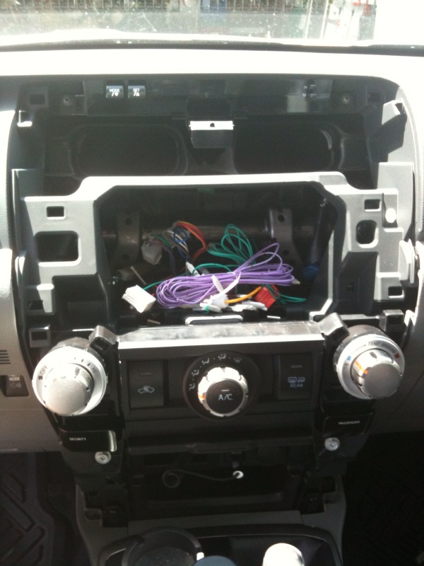

It is somewhat open. There is some useless plastic in the dash that has some voids. It could probably be modified to fit various things rather easily. I will snap some photos when I swap the HU out again.

Here is what it looks like...the 6 small rectangular holes (3 on each side) are for the dash clips.

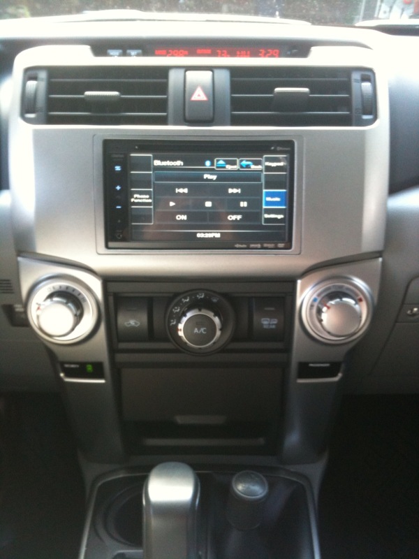

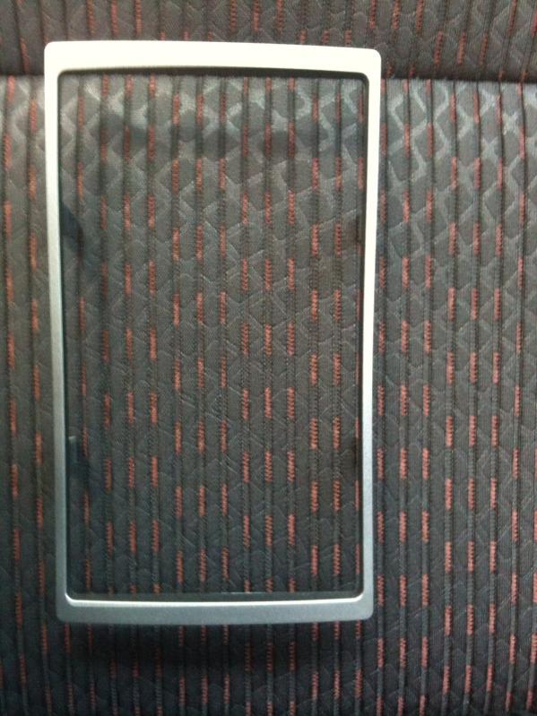

Here is the somewhat final outcome...the use of the Metra "brackets" is essential to the flush fit. However, these are just plastic pieces that clip to the dash kit and screw to the HU. I dont like this because all it takes to remove the unit is pull out some plastic...no bolts!!! The further out the unit sits, the better my trim piece looked, but you can tell from the photo that the piece is not true. I used a heat gun to warm it up and it shaped it a little better (the pic of the trim is before I heated it). This weekend, I plan to try and incorporate the factory brackets by using some washers or bushings for a little security.
