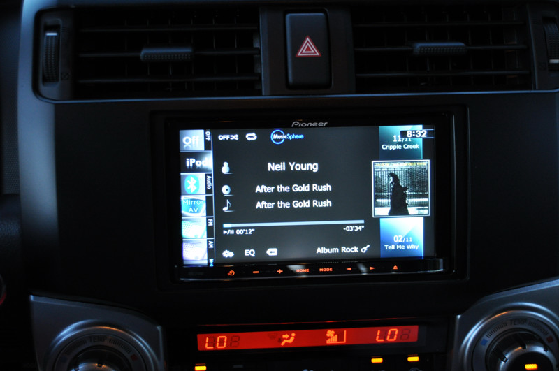

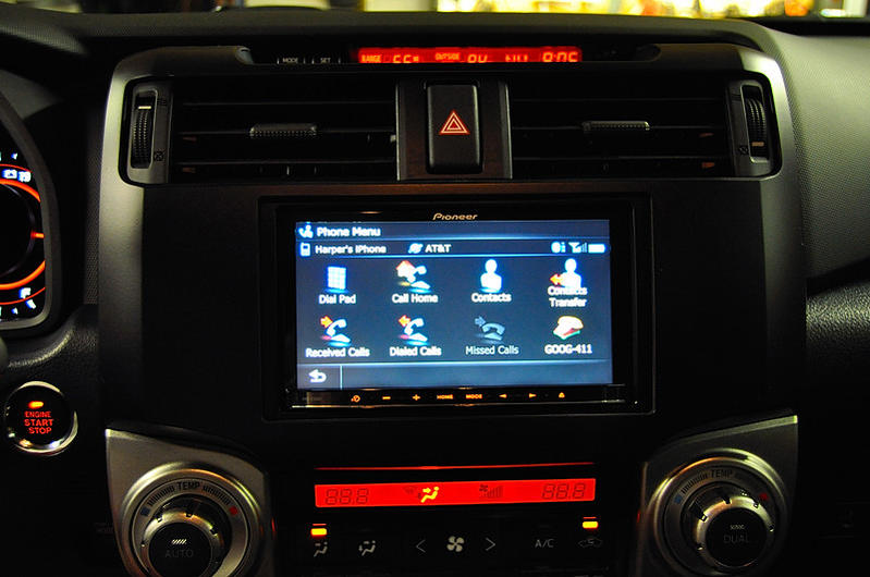

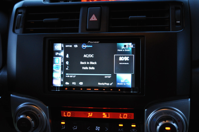

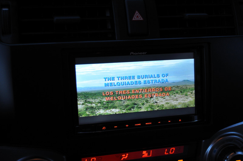

I installed my AVIC Z120BT nav over the weekend. It was not a day at the beach as I had to use adapters(TYTO-01 AND Axxess AWSC) to use the Factory JBL amp and 15 speaker system. All speakers and steering wheel buttons work as before. Don't ask for a step by step as I just followed the directions and the wiring diagrams.I got lost a couple of times!I have wired stereos before but not using existing factory amp and speakers so I stumbled thru it in about 6 or 7 hours.
Ended up painting the Metra dash kit like doodman was going to do using satin black Krylon fusion and satin clear . Looks way better IMO and going to do the 2 silver parts under the nav too.
Oh yea , the "Party Mode" still works so the switching must be in the amp as I used the existing JBL amp. I also did the yellow wire parking brake bypass per youtube and everything works while in motion including dvd playing, all handsfree phone stuff and nav programming.
For anyone doing the JBL upgrade to aftermarket in the future, the speed sensor wire is a green wire, pin number 5 on a 20 pin NAV connector. What differentiates this plug is it's a 9 over 11 pin connector . Took me awhile to find it in the wiring diagrams. I did'nt need to find the reverse wire because the factory camera would'nt work so no camera yet.
Absolutely lovin' this Pioneer and glad I changed my mind from the Kenwood!The new Pioneer Z120BT software works flawless with the iPhone and iPod and even streams Pandora thru the HU and has a free app for it.
