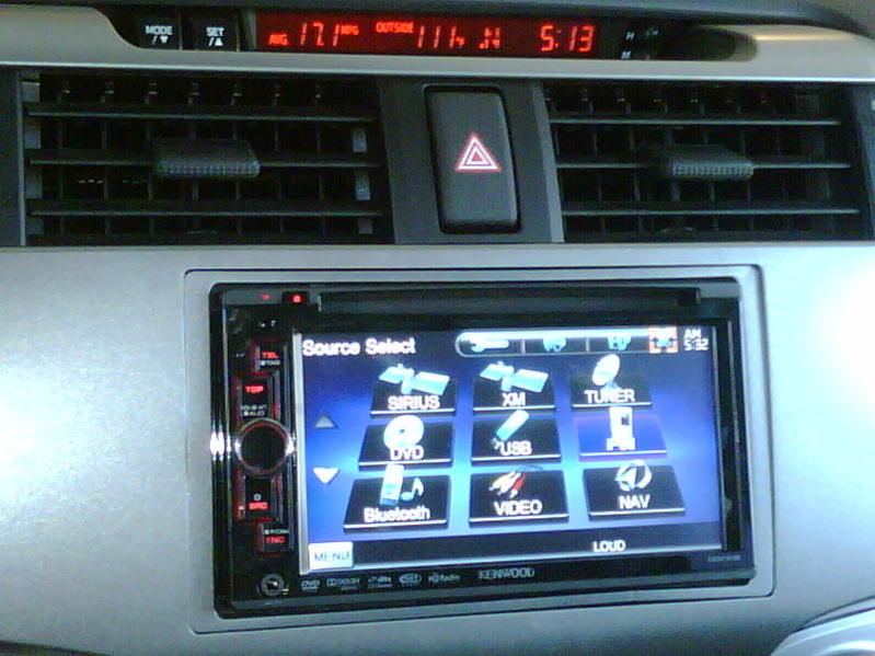

Well I finally got my Kenwood 516 installed. It has the ipod cable and the Nav module. It works pretty sweet and alot smoother than last years model. I ordered it from Crutchfield and got the adapter for free.
For the Bluetooth, unfortunately I had to use a separate Parrot kit, since those are the only ones that are compatible with Nextel's direct connect phones.
All I need now is the steering wheel control adapter, some speakers and an amp down the line and I am good to go. And yes, the temp is reading correctly, a beautiful 111' in S Cali.

Fits perfect. I am really happy with it. The 2010 Kenwoods are so much nicer and easier to use than the 2009 or older.
