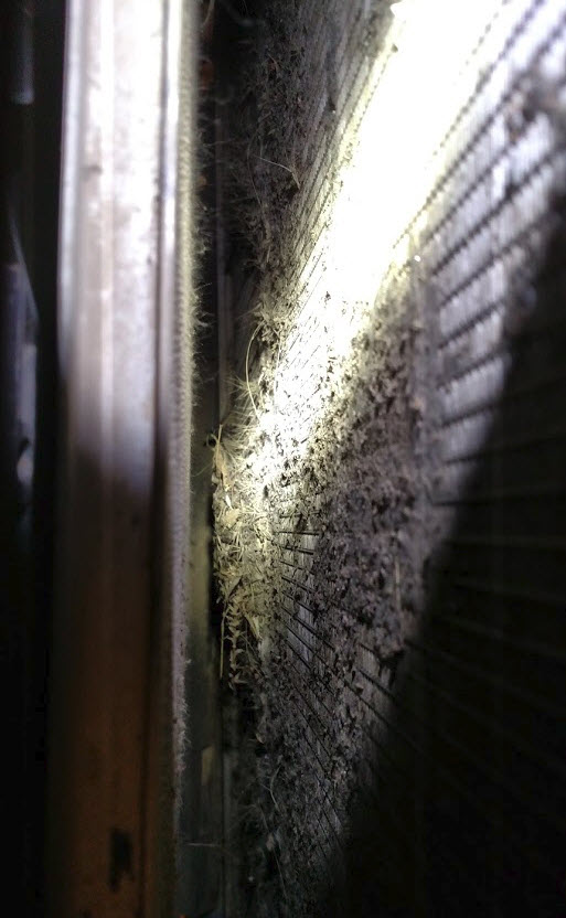

Found the problem today. The simplest answer was the correct one - lack of airflow over the condenser.
For the last few weeks, I have noticed when sitting at idle, or at low speed with a tail wind, the coolant temps would climb near the red. Moving faster or revving the engine would make it cool back down.
The foam that is meant to seal the gap between the condenser and radiator had deteriorated and was allowing the fan to suck dirt and debris in between, causing the lack of airflow. I had already knocked a lot of it out before thinking to take a picture, but there was about a 1/8-3/4" thick cake of crap on top of the radiator in the approximate shape of then fan, not to mention the crap packed between all of the fins. I'm kind of amazed that I didn't have more/worse symptoms before now for how bad it was.
