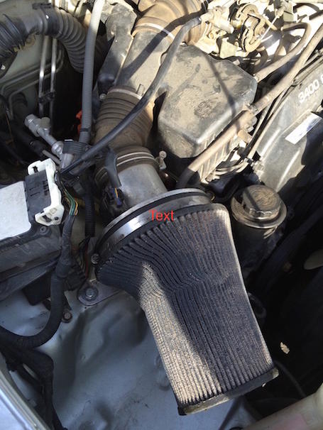

Just bought a 4Runner a couple months ago and am new to the forum. I had a intake question and was hoping you guys could help.
I bought the T4R with a after market Downey intake already installed. The filter is shot and needs to be replaced. Downey is apparently out of business. So I was going to measure the current filter and replace it with similar sized K&N filter.

I would try and go back to stock if you can get the factory air box for a decent price. Used ones usually aren't too much. New or aftermarket ones can be a little pricey, but I don't think I have seen them cost as much as a K&N set up. The factory intake is plenty good enough for our trucks, especially if you aren't one for modding. The filter element will also be a little more protected from the elements in the factory box from mud/dust when you drive down those fire roads. That set up, with all do respect, looks like junk.

I think you should also go back to stock. Those "cold air intakes" actually suck in more hot air than the stock intake, increasing intake temperatures and retarding the timing. Our stock intake isn't super restrictive either, especially with the newer MAF setup.

Thanks for the input fellas. Im going to go back to stock. Ill stick with Toyota engineering. Not saying there aren't benefits to after market. But Im more comfortable with OEM.

Exactly. Unless you build a box around the filter/intake to isolate it from the engine bay heat, and make sure it gets air from the fender well hole (where the stock intake gets its cold air) you are feeding the engine hot air, which will, as gamefreakgc said, cause the ECU to retard timing and cost power (and possibly richen the mixture, costing mileage). That's why the 'deckplate mod' is really counterproductive (as are most cheap intake solutions), but that's a different horse that's been beaten to death. I'd find a stock airbox - better filtering, cooler intake air temps, less chance of a problem (like a cheap filter that doesn't filter well) from an aftermarket filter setup. Now if you were building a performance car and built an box around it, etc. I'd go with the K&N filter . . . but the only way to help these dogs go faster is supercharging or turbocharging.
