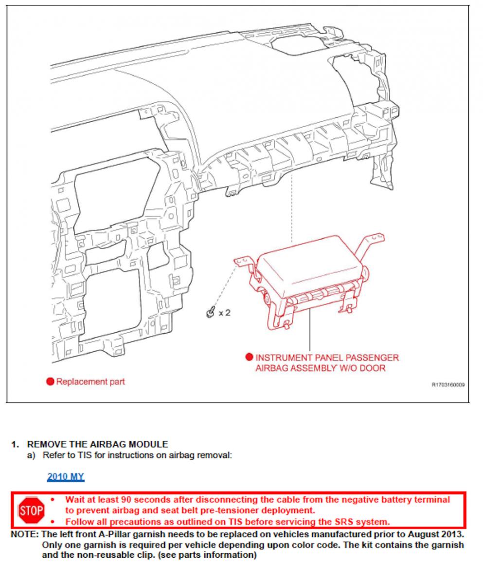

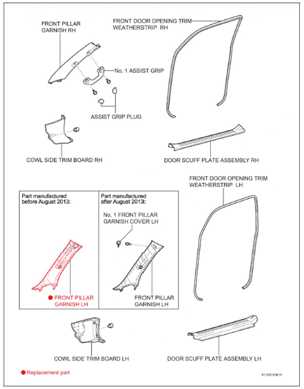

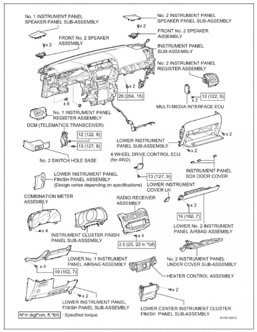

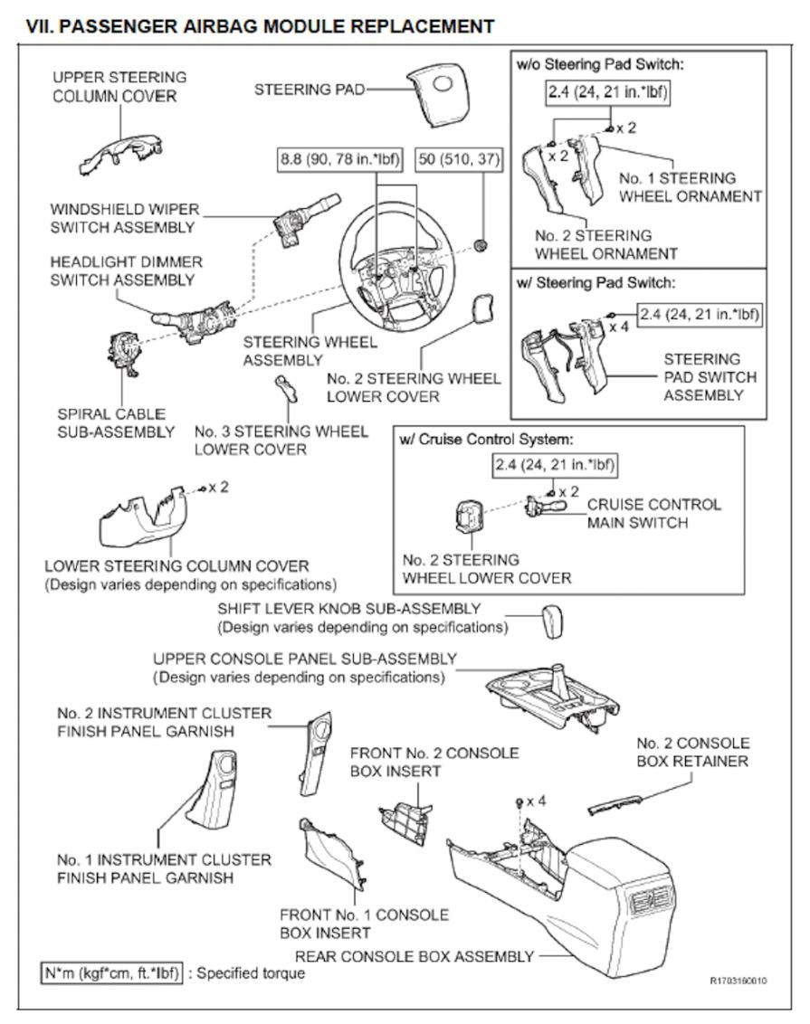

Here's what the TIS shows for a 2010 model though I can't imagine they did all of this disassembly and reassembly in 3 hours.

I don't get why they have to dismantle the steering column and center console, if they're only replacing the airbag assembly?
I seriously doubt they do ALL that for the recall.
That shows driver side and A pillar curtain as well as the passenger bag.
