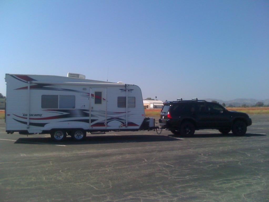

I also bought the Airlift 1000.....I installed them myself and they did leak in the beggining, found a real thin slice in part of the line....repaired it and as good as new.....I got them for my trailer, so when I go offroad I can disconnect the weight-distributing hitch with sway control and use the airbags so theres no damage to the sway control......I do find myself using it more and more just when I have any kind of weight back there as well.....its pretty awesome....
The pic is with 30 psi in the bags and about 650 tongue weight if not a little more.....
Awesome looking rig and it sits amazingly level even without the bars! :bigok:
:cheers:
Thanks, yeah it def. does its job......I think I'm gonna add the compressor to make it a little easier though.....I have my other compressor mounted in my engine bay but like the idea of a switch in the cab with guage.....

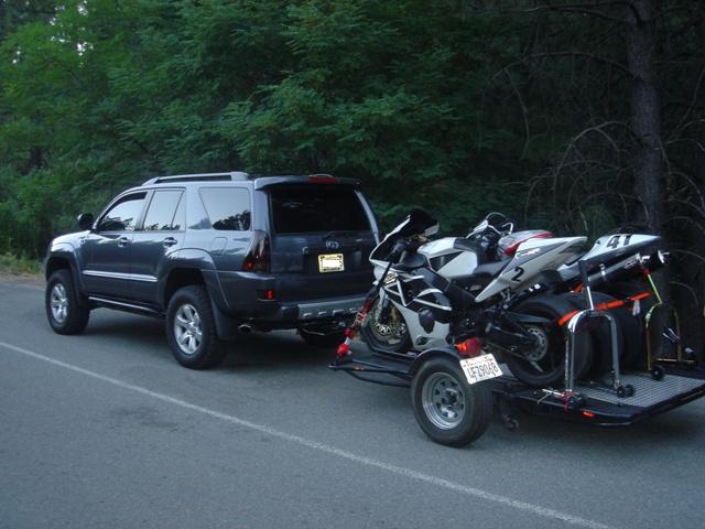

Nice, I have the same bags as you do and use them when I do track days and such. Without the bags, there is a little sag with just the bikes, but it squats if I hook up a trailor or toy hauler. I plan on throwing a tank underneath somewhere so I can air up/down when I'm on the track on trail.
Looks great! Are you running a lift in the front too?
:cheers:
Yep! A modified lift I guess you would say. It is a revtek lift all around from a few years back since X-REAS is still in place. Just waiting for an excuse to swap out to OME. With just the stock Revtek in, there is a slight downward rake in the front. It drove me crazy so I added a larger topout spacer to sit completely even. Well, when I tow I drooped a little in the rear (which is why I got the bags).
What PSI do you run when you are not towing? I think I sit at a steady 8PSI when not towing and then air up to even it out whenever I am towing. Its such a sweet mod! :bigok:
I run a little more. I don't mind the firmer ride. I target 15lbs on the left and 10-12 on the right. That seems to ride and handle the best for me without being too bouncy. I run the left a little higher as the gas tank, the battery and me are on the left side. ...it is a sweet mod.
