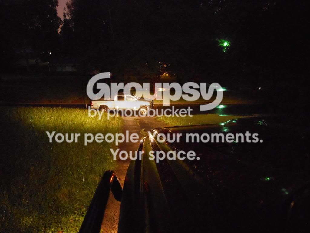

You're gonna love the lights. I used the IPF buckets instead of Roundeyes, but either way the H4 is such a huge improvement over the sealed beams.
:reddance: Sweet. I was looking at the Hella Vision Plus conversion but I decided on these. My Hella 500 fogs are brighter than the sealed beams I have now.
I got some shots of my lighting to compare with the Roundeyes when I get them installed
Sealed beams
Hella 500 fogs
Sealed beams + Hella fogs
Hella 500 55w 6000k HID driving beams
Everything on

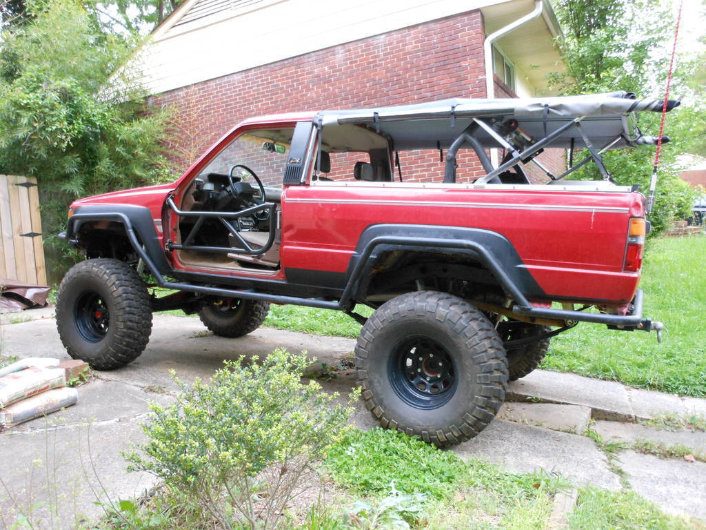

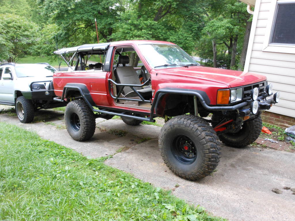

Nice build! I have a 1" body lift in mine, which makes the triple sticks a lot easier to fit in. Minimal cutting.

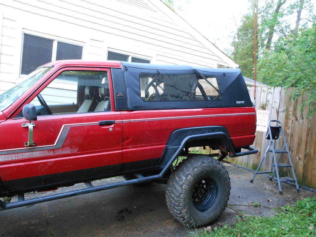

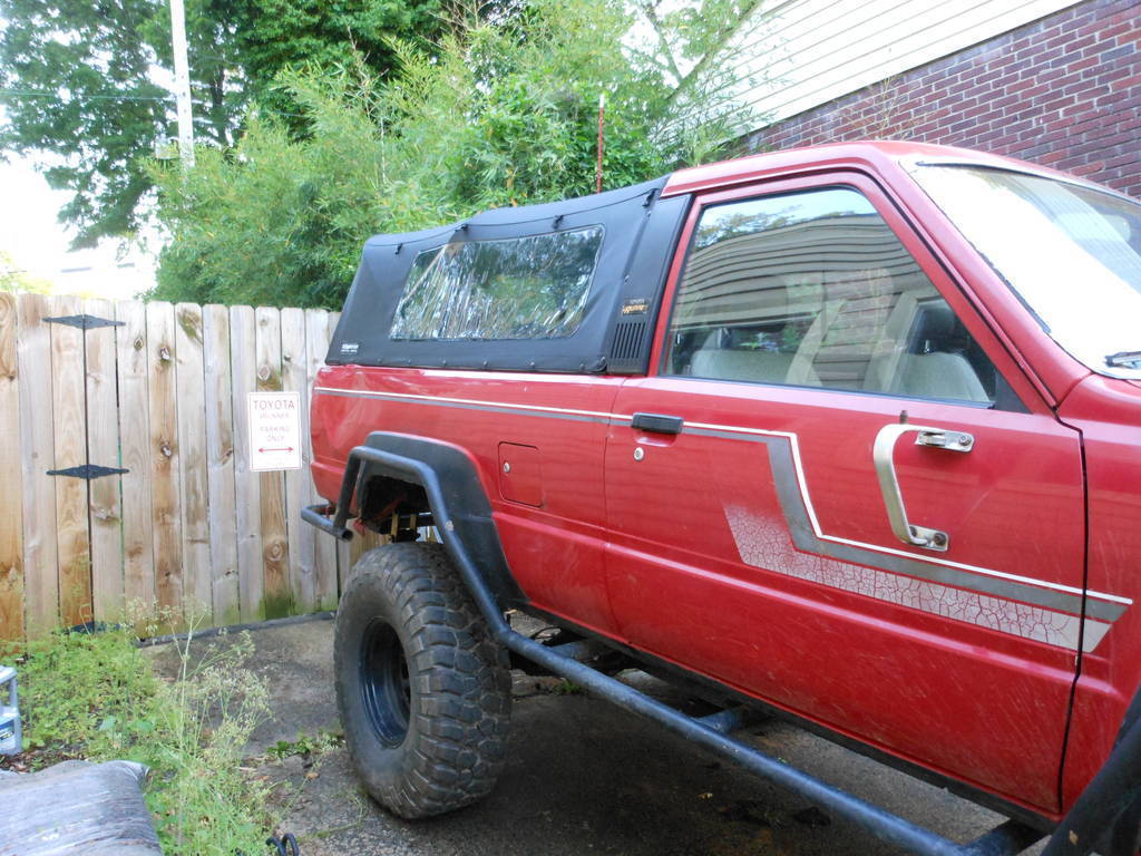

How do you like the Softopper?
Very nice!!
Thanks :cheers:
Thanks! I noticed that in your build. I almost stopped my install to order a body lift lol.
I LOVE the Softopper. If and when the Bestop Supertop on my Tacoma wears out, I am replacing it with a Softopper. Excellent quality, looks, and function.

Damn. This build is sweet. I'm super jealous of your triple stick/dual cases. This area of the site is dangerous. Every time I come here I'm like "how much would it cost me to build a 1st gen crawler?" Its almost like going on dezertrangers haha

I spent the last couple evenings scrubbing and cleaning my Softopper. It was pretty filthy so it was a lot of work, but worth it.

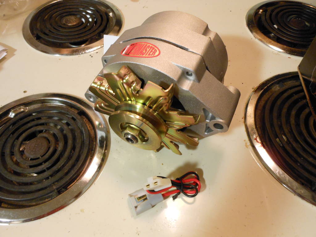

My alternator and GM 2 wire harness showed up. Hopefully my bracket will come soon.

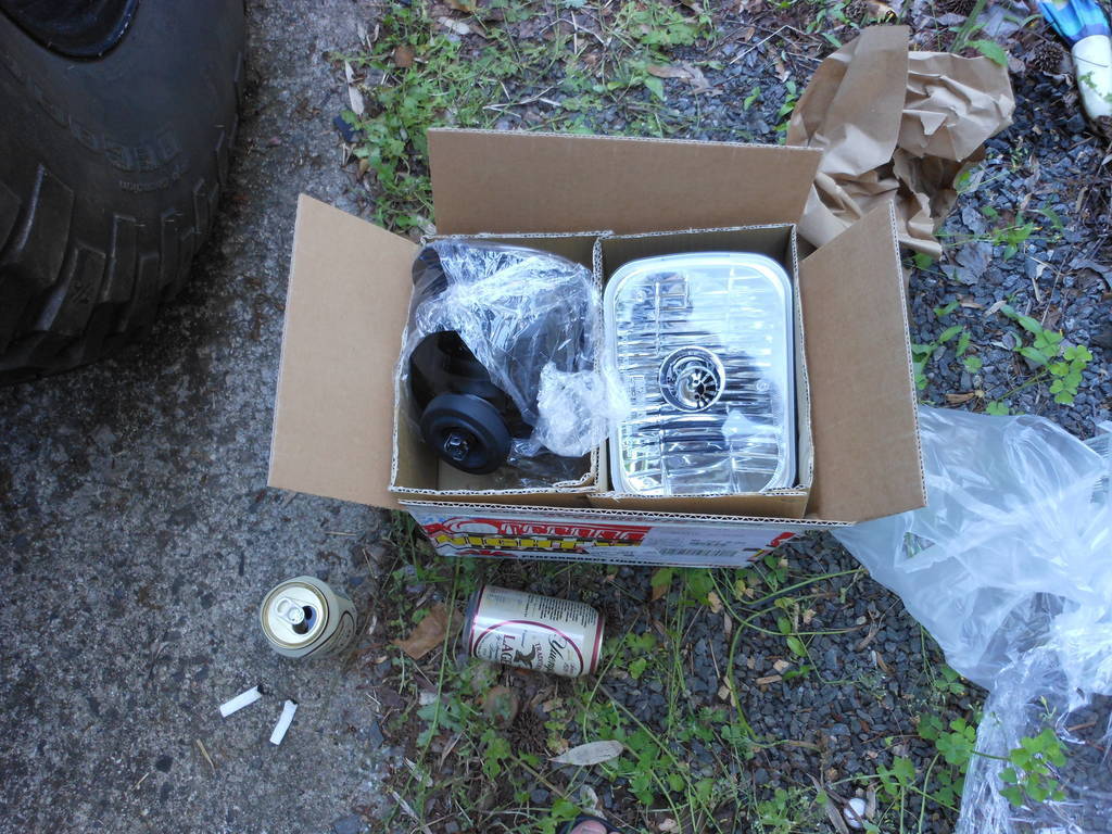

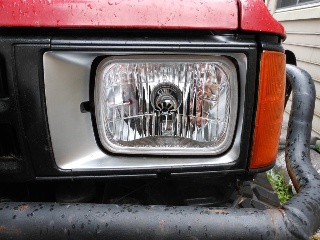

I recieved my Roundeyes H4 headlights and installed them, but won't be able to test them until Thursday. :rain:
The Roundeyes are working great, I got the harness put in from rallylights.com but I still need to get them aimed 100%

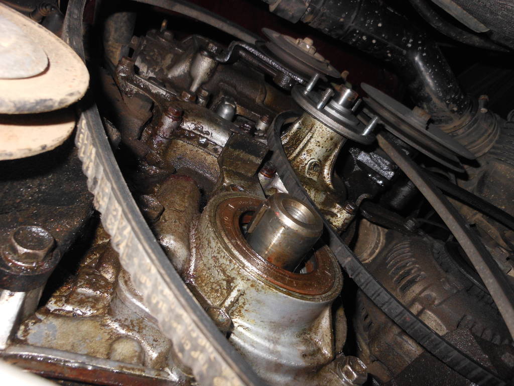

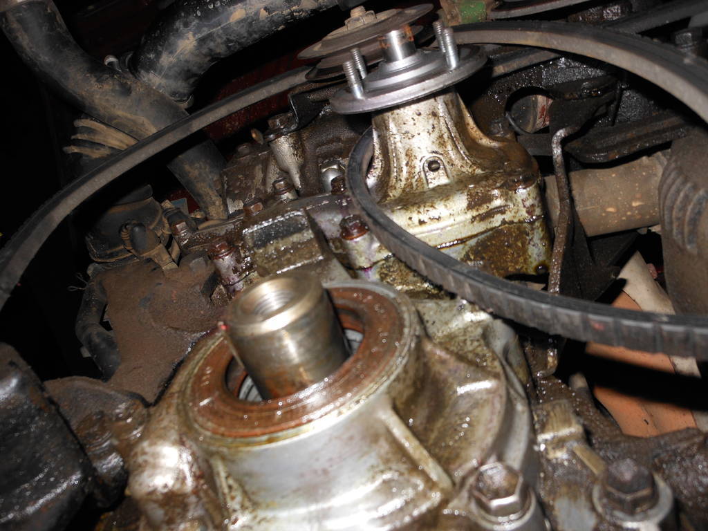

Right now I am taking the front of the engine apart to replace the front crankshaft seal. She has started leaking pretty bad so I figure I can fix that and have plenty of room to swap in the new alternator. I will get some pics tomorrow hopefully when I pickup a puller tool, I am hoping I do not have to remove the radiator to get the crank pulley off.
My crank pulley came right off, but if you have to put a puller on it you'll want to pull the radiator.
FWIW, if you pull the radiator you can disconnect the PS bracket and then the coolant hose immediately over the alternator and pull it straight out the top. I don't like trying to wrestle it out the bottom, so as long as you've got a reason to pull the rad anyway I'd do it.
Thanks KidV! Sure enough my crank pulley pulled right off too. I wiped off some of the motor before I decided to start taking it apart but I noticed most of the oil puddling was just behind the crank pulley below the seal, it has been wiped off in these pics.
