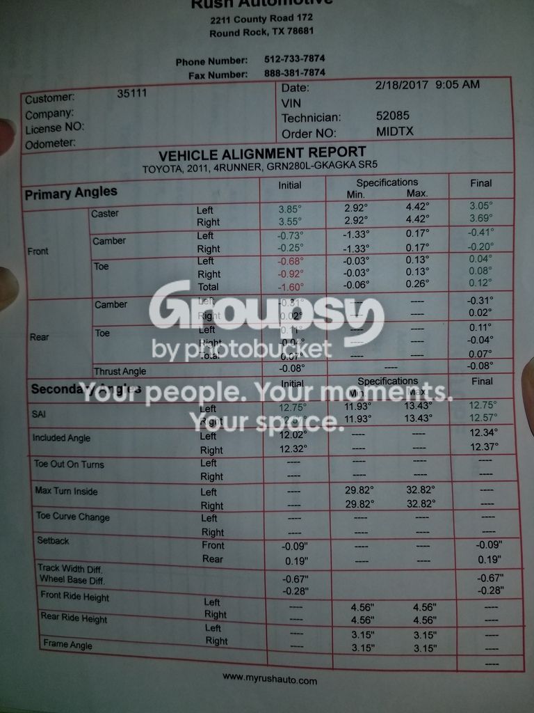

I lifted my 4Runner in February (Toytec Boss w/ UCA's). I got it aligned the next day. The other day hi noticed that the inside of the front tires are wearing uneven. Can someone look at my sheet to see if adjustments can be made?
Your alignment numbers from back in February look good. Since you had this alignment done the day after installing your lift, there may be a chance that your suspension "settled" (possibly losing some of your lift) thus changing your alignment numbers (more negative camber). Also depending on which UCA's you installed....especially if they were SPC, slight chance that you lost some camber (causing more negative camber) if the camber adjustment nut (big 1.25" nut on top) wasn't torqued down enough.... not sure how other aftermarket UCA's adjust for camber.
Both of these could potentially cause more negative camber which could cause the inner tires to wear prematurely.
Might be a good idea to have it realigned.
Okay, so I have now had my 4Runner aligned 3 times now. 1st was 2 days after I installed my lift, 2nd was 5 months later when I noticed the inside of the front tires were wearing more than the rest. I rotated the tires from the front to the back. 6 months later this January it started pulling to the left and the tires are wearing on the inside again. Here are all three alignment sheets. What do I need to do? Is there somthing they are not adjusting that they should be? I have a Toytec Boss lift with SPC UPCA's. Any help is much appreciated.
