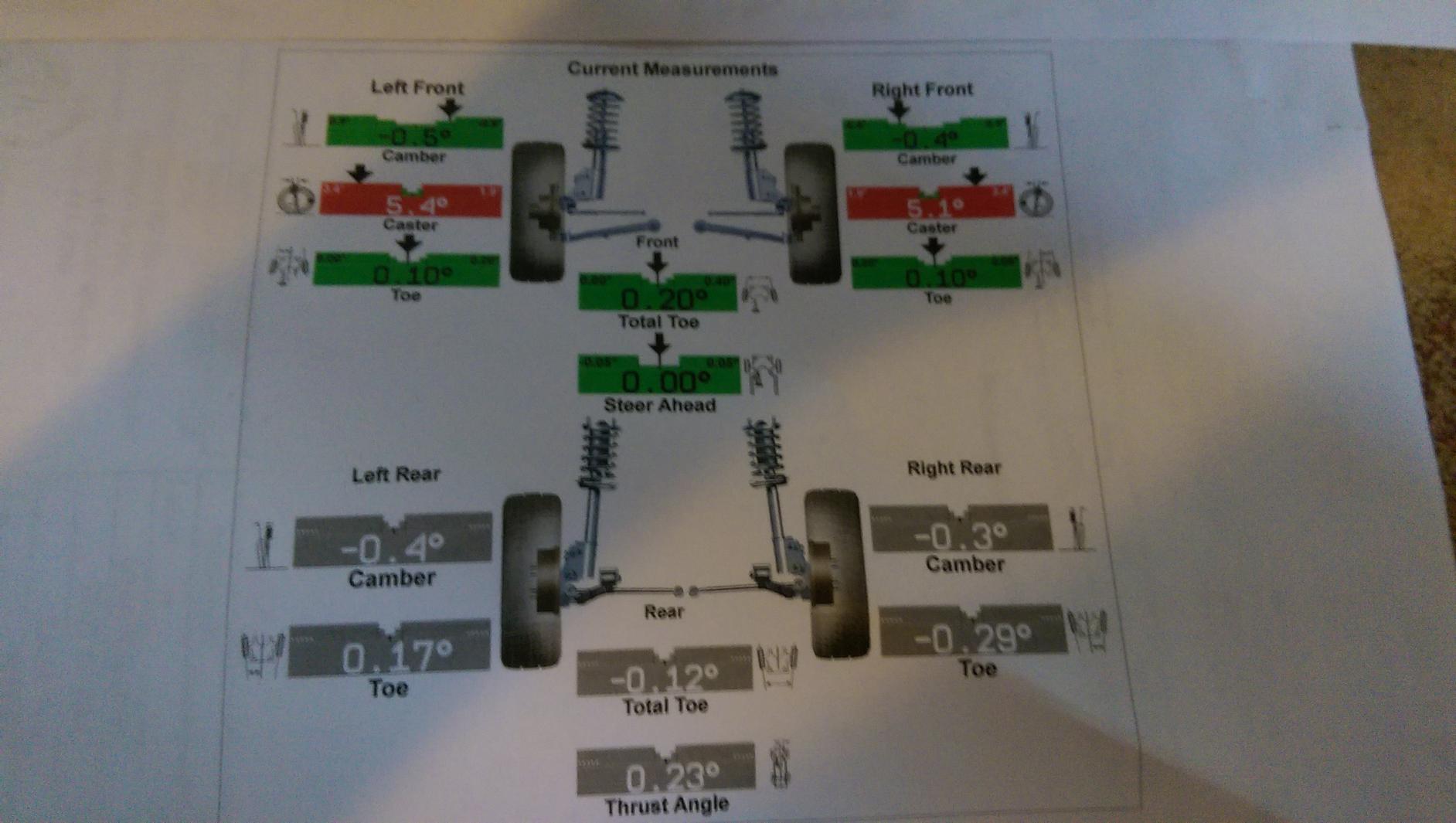

Got my 4runner aligned today at firestone here are the results it doesn't look like they did much? All I'm trying to do is fix the pulling to the left after braking and Lil durning braking I've replaced the front left caliper

Which lift are you using? You need about 3 degrees more caster. I hope you got the lifetime alignment. I regret not doing it with my first alignment. Also, you're on the higher side of allowable toe, which will result in rapidly accelerated tire wear. If they can't get the caster any higher, I'd look into adjustable UCA's.

Either way, with 3" of lift, you're at the upper end of OEM caster adjustability. It looks like they sacrificed all of your caster so as to avoid having positive caster ... \ /. Snap a quick picture of your lift, it'd help to see what you're working with. SPC UCA's run about $380, and this is arguably the most affordable solution to your issue. Unless of course you go back to stock suspension.

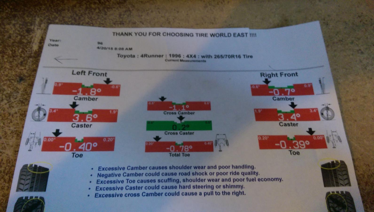

So just got back from alignment shop. Had a battle with them. One side they could get aligned with my new SPC UCA's. The other had a camber of -1.8* full maxed out. They told me they needed to flip the ball joint completely around which SPC does not even say you can do and they wanted to charge me $200!!! Just to unload front suspension, loosen one bolt and flip it around. I was like hell no!
Drove home, flipped the ball joint around and camber was way off it was not even funny, looked dangerous to drive. So I set them too the +2* setting and hoped for best. Once I got there they said it was wrong again before trying and when they went to align they got it to work!!! LOL
Loading pics now. And to the OP I would take it to them again, those numbers look pretty bad after looking at my before and after.

And for the record, the alignment shop made your alignment worse than it was when you showed up!

That's what I initially thought too, but I put myself in place of the tech. He at least evened out the camber and slid the right front tire ahead of the left front caster. IMO, its not horrible, but it could definitely improve withh some adjustable upper control arms. You should have seen my before specs :D

Those last readings are what you're riding at now. That caster is way too high. Everything else is dead on though. What are your SPC UCAs set on?
