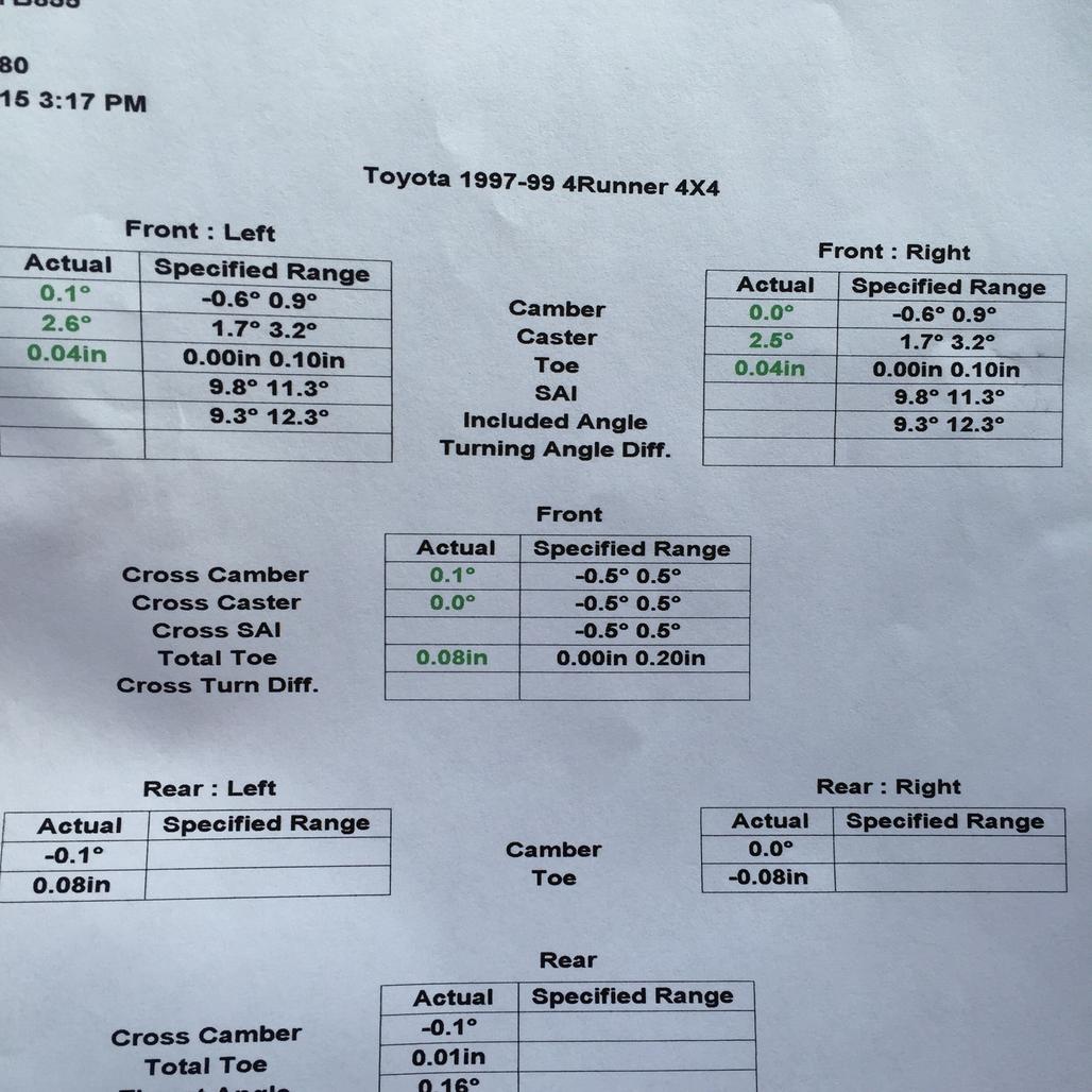

Dang... Did you see my new alignment photo? What would cause such a change ?
Just wanted to share my alignment specs. 98 4runner auto 4x4 3" lift toytec/eibach springs/tundra 5100 in the front and ome890/5100 in the rear. 1" diff drop, stock ucas, stock tires, 2"bl

It seems like this thread has a great deal of knowledge about alignments so hopefully you guys can chime in.
Info:
I recently completed my frame swap on my '97. (new frame is a '99)
I have OME 3" lift with 881 front and 891 rear
285/70/17 tires on FJ 6 spoke wheels.
I put 1.25" spidertrax all around to solve the tires rubbing badly on the UCA
We couldn't get the 3 top studs of the driver side shock top plate off, so we had to cut them. (not realizing that the original studs were longer than what autozone gave us in the replacement top plate) So I had to reassemble the driver side shock without the 1/4" aluminum spacer at the top of the spring that came with the OME kit.
I took it to the dealer to get aligned and they told me the spacer shouldn't matter ( I am fixing it soon, but have to find the longer studs first)
I had very little rubbing before the frame swap (only at lock really), but after the alignment it is really bad on the limited flares towards the bottom. I can barely back up and turn my wheel at all without it grabbing the flare.
I know nothing about alignment and everything looks good except the caster on left side.
Is this what is causing the rubbing issue?
Would the top spacer not being in there have anything to do with this not being in spec like the right side?
Is this how I want the numbers to be for my lift and wheel tire combo?
Thanks guys!
[MENTION=67311]chewybtc[/MENTION]
Is it only on the drivers side? Your caster is so far off on that side, yet your passenger side is in spec, even with your lift and stock UCA - Most likely because of your spacer situation
