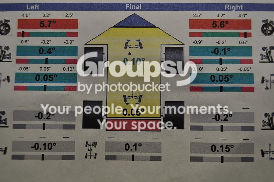

This was my last alignment printout with Total Chaos UCA's maxed out for caster and coming from LR UCA's......You want to look at the "FINAL" specs...
Picture023-6_zps249a7aa7.jpg~original
Alignment sheet with Light Racing UCA's a couple of years back....As you can tell I like more +caster which makes for stiffer steering and better straight line tracking while still keeping toe and camber within specs. I started with +4 the first time and went up from there.
Picture016-7.jpg~original
