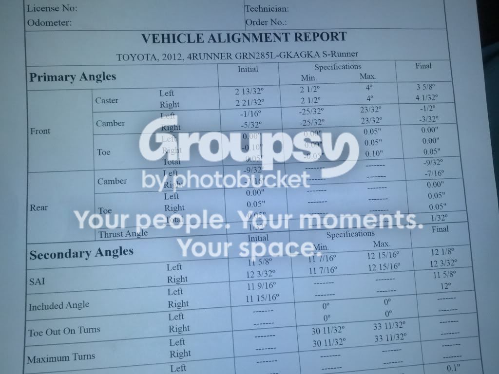

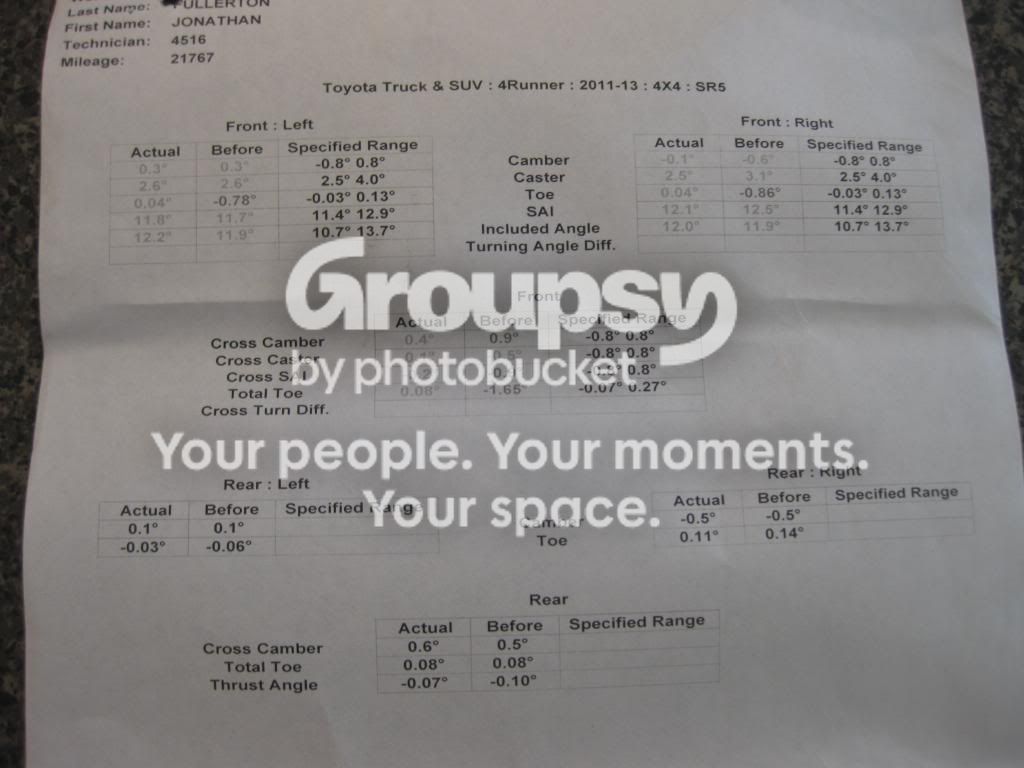

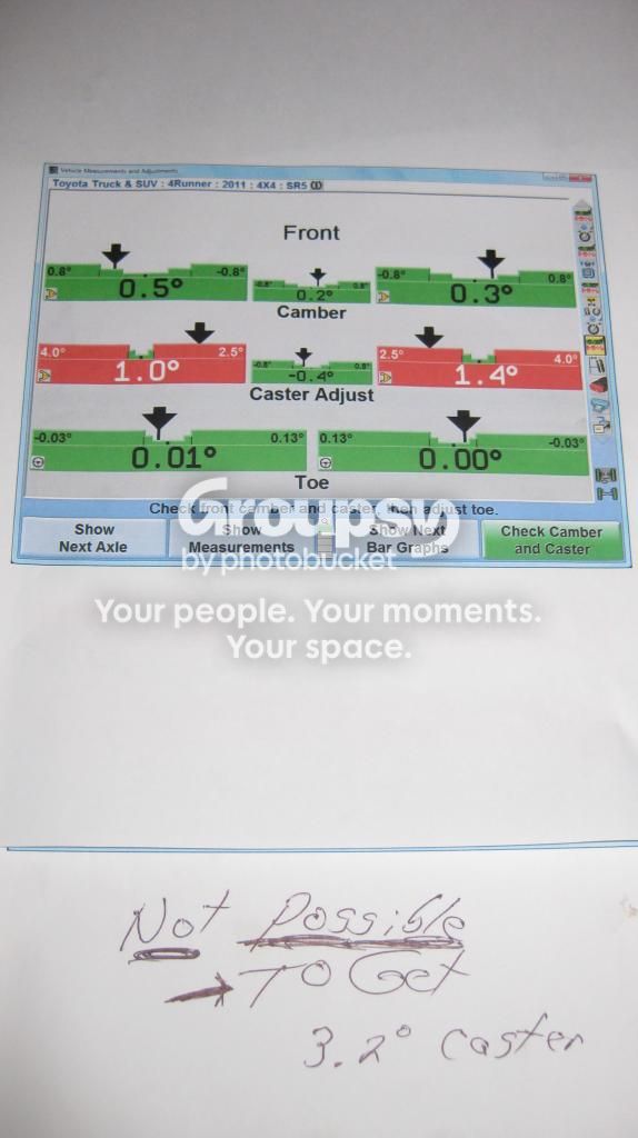

here are mine, I've been running the same 5100's, and Total Chaos UCA's the whole while.
1st attempt (independent shop)
IMG_0710.jpg~original
2nd attempt (dealership)
IMG_0488_zps9a50c277.jpg~original
3rd attempt (8 hours away)
IMG_20130705_143812_zps90e2e9ca.jpg~original
I'm not sure what the issue is, whether they're using different equipment, if they're just lazy, or what the issue is. Even the last guy who got it damn near +4 said he had a hard time getting it there.
looking at these again, the dealer tech clearly didn't even read the notes that the service coordinator entered, since I asked for +4, and instead caster went down from 3.1 to 2.5 on the right side. :frusty:
