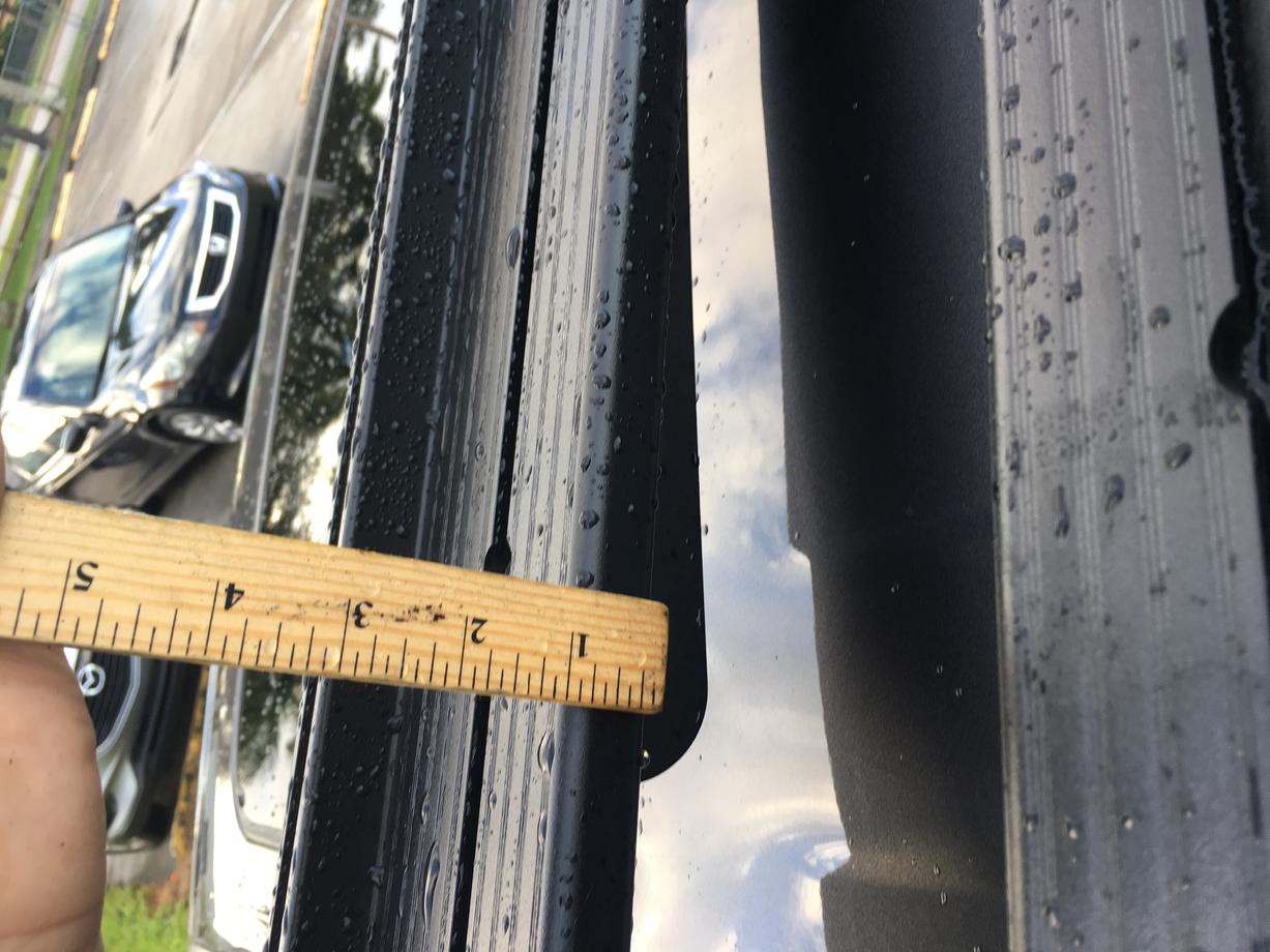

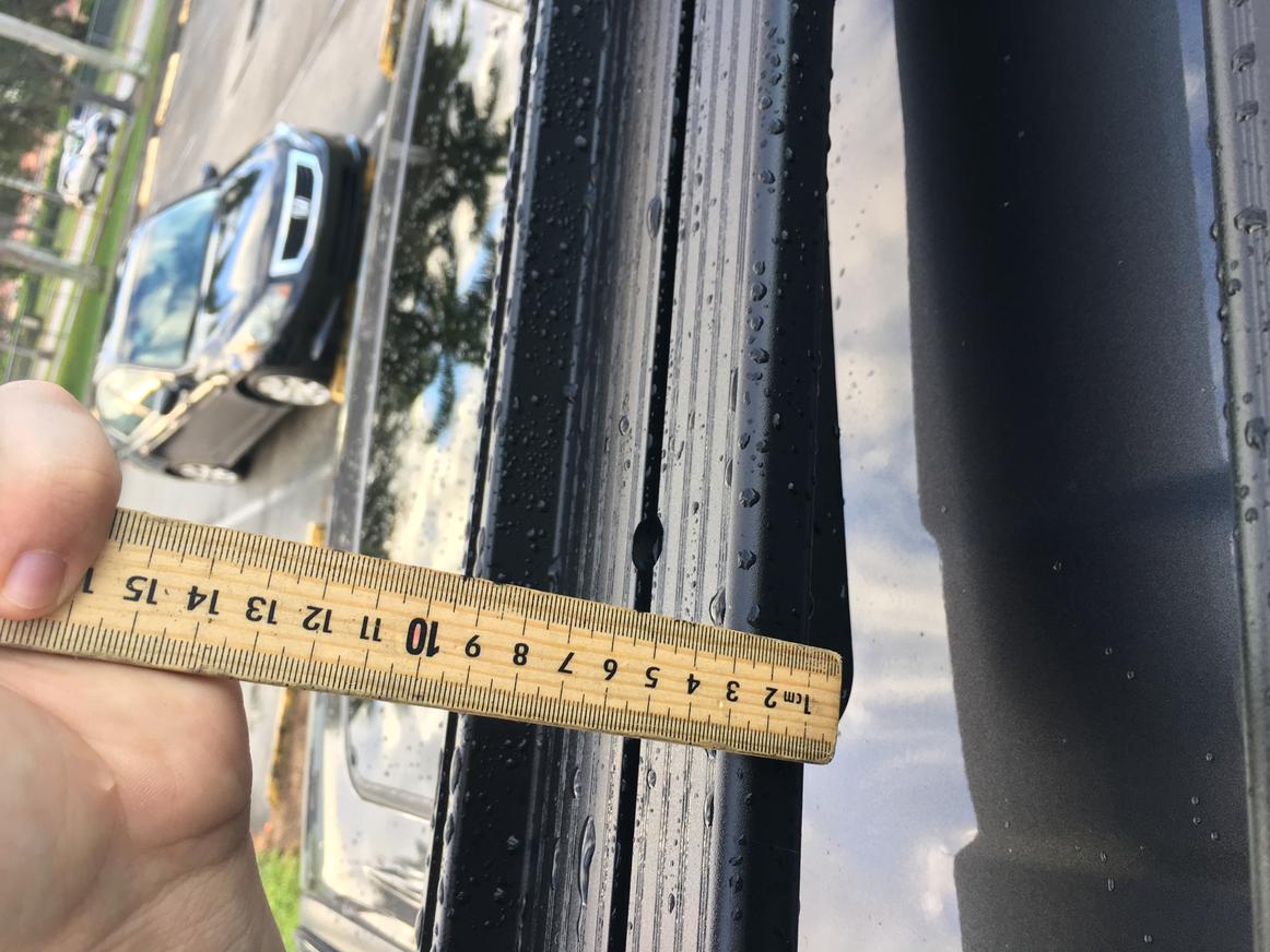

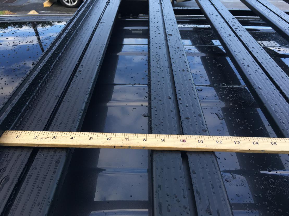

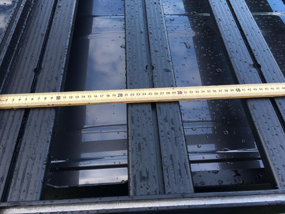

Here are the Frontrunner measurements...
Slat width: ~9cm (90mm)
Spacing: ~11cm (100mm)
The 2cm difference is likely for extra slats to be added into the space to create a full flat surface.
Slat thickness is 2cm (20mm)

And for those of you who love fractions and basing your measurements off of a long dead monarch's foot size...

Thanks [MENTION=120701]Cymon[/MENTION]! That is perfect.
Heres my measurements of the K9 rack. I was using a soft measuring tape so couldn't take photos with the tape in place.
Total slat width 13cm
7cm between slat channels
9cm between slats
13.5cm between 1 slat channel to nearest channel on next slat
Based on our measurements, looks like any frontrunner bracket that is designed to mount across slats spans ~19cm and wouldn't be able to mount in the same manner on a K9 rack. On a K9 rack, the bracket would need to be mounted on the same slat front to back.

Thanks you both...that helps a lot when looking at integrated accessories
