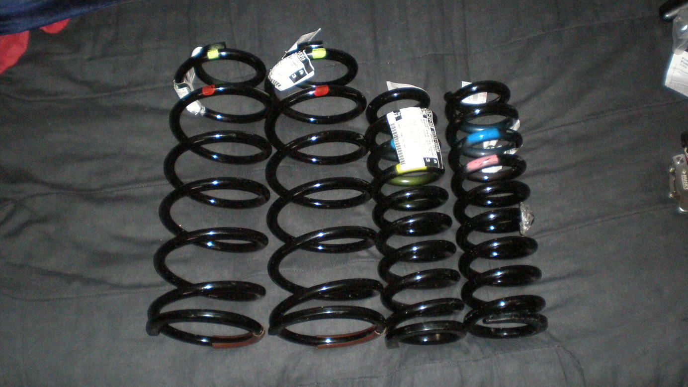

I CAN'T RESIST YOU!!! It may not be a 3" Toytec but it's 2 more inches than my saggy ass had!
Just ordered '99 springs and Bilstein HD shocks.
My 99's current springs are sagged to hell and arent the tall ones, not to mention I can't wait to not nosedive during braking, turn normally, and have some COMFORT!!
I finally got my harmonic balancer in (A B1TCH!)and it's never run this smooth since the day I got it. New front crank seal and STUPID pinion seal in the axle and fluid, too. Brake fluid is new too, made an amazing difference but still wont get much difference til the new shocks and springs. Didn't take a pictures, sorry.
WHEN I GET MY NEW SHIT I'LL POST PICS! sorry excited ahah
I would do a normal lift but I'm not as ballsy as Justin727, no 3" in a 3RZ for me.
99 spring part numbers:
Front Right Springs - Blue / Yellow (48131-35400) Passenger Side
Front Left Springs - Blue / Pink (48131 - 35350) Driver Side
Both Rear Springs - Yellow / Red (48231 - 35210) Both Rear

Yeah just did this to my 99 in the front, havent got the rears yet. Make sure your black cup for the spring on the Bilsteins HD is facing the correct way. unlike me that had to do it twice, total learning curve. I can change out a strut now on my rig very fast, not sure thats a good thing... hmmm, anyway, the cone goes towards the top of the strut totally going over the C-clip on the strut body. just food for thought. Good luck. Mine had 205K on her so figured new coils would be a welcome treat.

I was referring to the Toytec 3in kit. Thanks for the insight!!! Seems to run right in line with what I have read. If you're going to do it.... do it right.
:thanks:
awesome James! make sure to take some pics before and DEFINITELY after!!
Of course Bryan! Who do you think I am... a not picturetaker? :D Bryan, one of the few people who actually know how to spell definitely correctly.. bravo!
so was Louis able to help you out with the springs?
He and I talked, really nice guy, but the same price was offered to me here. It's easier for me to just get them with Power Toyota Irvine since it's just right around the corner. Thanks for your help Brandon! After all, if it wasn't for you, I wouldn't have had the part #'s
