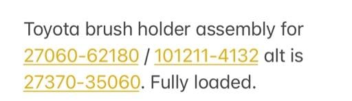

You need to order a brush assembly from Toyota or Denso’s website.
This I think is the number for the 70a Alt.
The first two numbers are the 1) Toyota Alt part number. 2) the Denso Alt part number.
The last number is the brush assembly.
