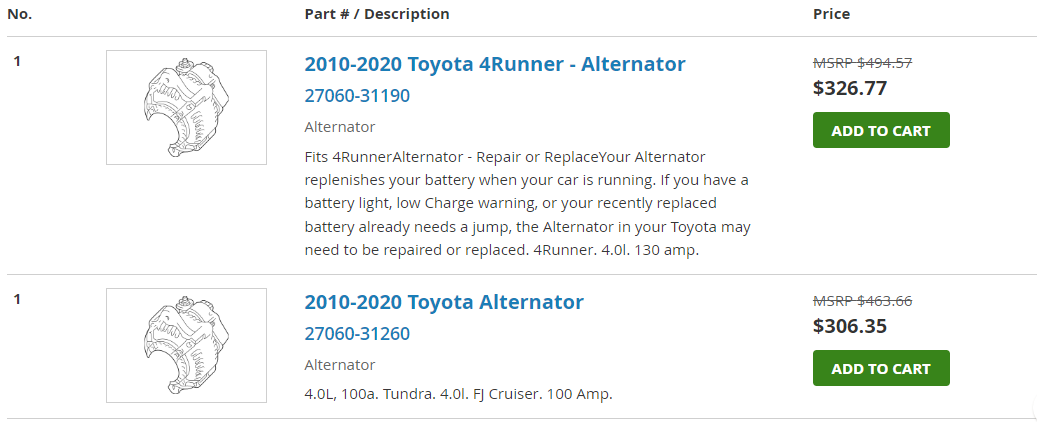

When I look up the alternators on Toyota's online parts site, they show a 130 amp and 100 amp alternators. Are these interchangeable? Both listings show it applicable for 2010 to 2020 4Runners with 4.0 liter engine. If that is the case, it would seem that the 130 amp would be preferable. What do you all think?
I would only choose the larger if that is what you need or that is what the existing is rated at. Otherwise, will be wasting money assuming it costs more. The alternator will only produce what your vehicle will use.

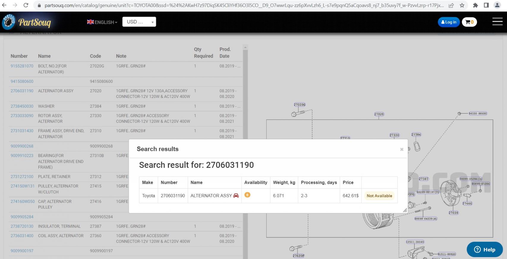

I'd go by part number. Partsouq lists number 2706031190 as the OEM replacement, which is a 130 amp.
This is for the 2019-2020 model....

These are the two that showed up when I punched in the vehicle. Description on the 100 amp indicates Tundra. I called the dealer with the VIN # and they confirmed it was 130 amp. However, the dealer price was around $580 (I tuned out at 5), but they could have it as early as tomorrow. The website price is obviously much lower. They did say they are all reman'd unit, so there is a core charge. I'm wondering if the brand new CKO (Chinesium Knock Off) for $125 with Amazon Prime is the better option?

If you have the towing package you'd want the higher amp alternator. Usually that's part of the package along with a larger battery, tranny cooler and other things.

If you have Limited or TE, you want the 130, otherwise 100 is fine. The extra amps are for the PTC heater in the TE and Limited, which are electric heat strips on the heater core which draw a huge amperage to get warm air, faster.
