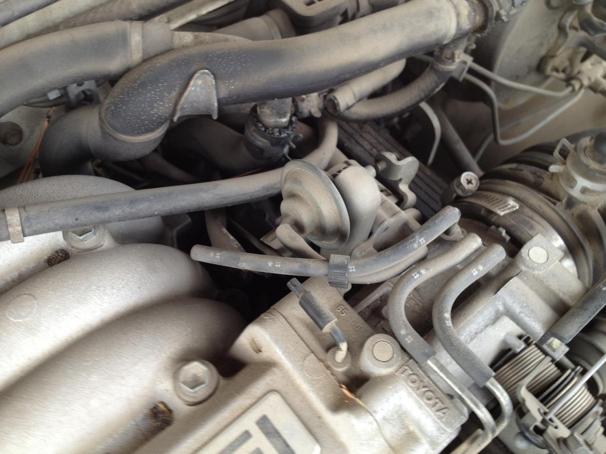

When installing my intake I noticed a couple of vacuum lines on my throttle body that don't go anywhere. Then someone said I am missing some evap parts on my inner fender well. My car runs fine but I would like to replace the parts if they are missing. There is also a larger hose just behind the TB in the picture that I just noticed is also not connected but i don't have a real good pic of it. If anyone can tell me where any of this goes or what I'm missing or even just let me know where I could find the info I'd appreciate it.

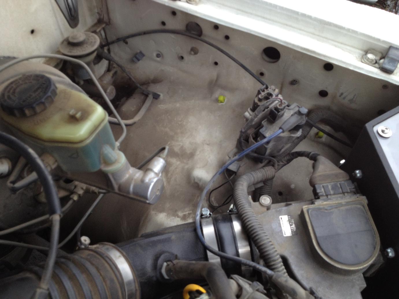

Somewhat unrelated but do you have Cruise Control? In the fender wall area in my T4R I have vacuum lines and a throttle actuator.
Here is what mines look like:
In the First picture, those look capped off.
Lets start with what year your 4Runner is. Also, there are supposed to be one or two lines coming off the TB capped off. Everything appears to be in order to me.
Tough to tell what that disconnected hose is for. Looks like a rear heat line to me. Does your rear heat work?
Code: You are somewhat correct. Yours DOES have cruise on the left side behind the airbox. However, starting in 93 or 94 (unsure exact year) they moved the cruise over to the pass side, and it became electronically controlled. Since he has a 94+, he won't have a cruise control setup on the drivers side. It will be on the pass side. I can see the cruise cable, so I know that he does in fact have cruise.
sorry ya it is a 94. ok i figured that the little vacuum port that has the little neck down rubber peice was probably some sort of vent or something the one i was worried about was the back one that curves back by the intake plenum, it just ends at that runner and is open but there doesnt appear to be anything for it to go to.
