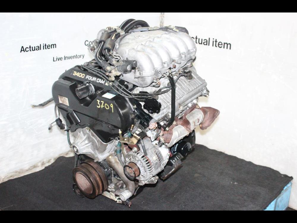

It's interesting - the so-called JDM engines I've seen online look exactly like the one in the runner... So maybe not JDM after all?
The differences are subtle enough that if you don't know exactly what you are looking for, you won't see them in the standard pictures.
In this picture you can easily see:
- Heater lines over the intake manifold
- Oil filter in wrong location
- Wrong exhaust manifold
-Charlie
-Charlie
