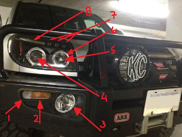

I've started my angel eye installation today, its almost complete, but I'm curious what others have done with these or if anybody has any ideas as to what I could do.
Current wired and functional situation:
1 and 3, wired together
2 is signals
4 is low beam
5 is high beam
8 is a yellow running daylight that I plan to change to white (Has a yellow reflector on the side).
I need help/advice with 6 (angel eyes surround HB and LB) and 7 (3 small LEDS). I thought about doing some work to make it so I can run the fog lights (1 and 3) under any condition (currently only possible with LBs) and wireing the angel eyes into that. Or, running new wire/fuse with a switch or two to have complete control of both the angel eyes and the 3 LEDs. I've even considered using one of the two wired into the turn signals.
Basically I have a few ideas but still have no clue what I wish to do and was just looking for more Ideas from you guys out here.

Typically the Halo's and LED's are wired with the DRL's right? I think that would be the way to go.
Maybe rewire #8 with #2 as your blinkers. Just my thoughts.
Truck looks great though Huskey!
My Halos and Angel Eyes are wired to the parking lights. When I switch them on, the Halos, Angel Eyes, DRLs, and taillights are on.
I like the idea of 8 and 2 getting wired together... I think I'll wire the 3 led's with my LB's and put the angel eyes on with my lower arb foglights, and then do the work so that they can be independant of the LB's.

Hey Husky, I have the same headlights and always have problems with the 3 LED's going out, I have them wired to my blinkers. Do you have the same problem of now of a fix?
Thanks. Yeager
