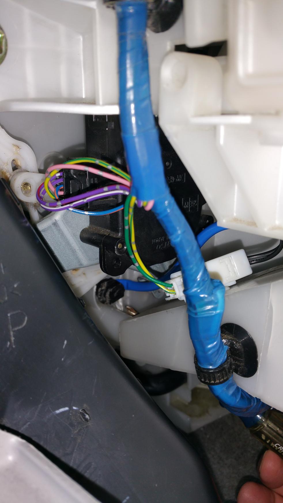

Well I think I've figured it out. Replaced the amplifier and still not help. Went back to thermistor in the side of the evaporator box. Drop the glove box and bottom piece under the glove box and you'll see the carrier with a blue wire wedged in there. The blue cover has two wires in it and has a connection right there that is fitted to a brace of evap box.
Purchased another one and put it this time with the tab pointing up. Well it seems this part needs to be in the exactly the correct position or it will continue to cycle incorrectly. Now it is just a little further back from the evap coil. It cycles normally and I can hang meat in my 4runner, finally. When running fresh air, I literally get a steady stream of water out of drain line. Very efficient system.
PM me if you need pics and I'll get you on or two. Pain to get the carrier out the first time. DON'T BREAK IT! You apparently can't get the carrier without buying a whole new box or going to the junk yard.

Post Note: The position of the sensor makes a difference. When tab is straight up, I nearly froze my core. Trying next position.
This is awesome Fuzzy. If you could get me some pics it would be greatly appreciated as I am not sure what I am looking at as far as the tab etc. We are getting into the colder weather here but I would still like to fix this problem asap. Thank you very much for figuring this out. If this works and finally fixes my phantom ac issue I will be sure to buy you a beer if you are ever out this way.
this is awesome fuzzy. If you could get me some pics it would be greatly appreciated as i am not sure what i am looking at as far as the tab etc. We are getting into the colder weather here but i would still like to fix this problem asap. Thank you very much for figuring this out. If this works and finally fixes my phantom ac issue i will be sure to buy you a beer if you are ever out this way.
Screw driver points to the carrier. The connection top pops out.
The placement seems to be very important. I had mine rotated 90 degre clockwise and nearly froze my evap coil. My tab broke when I removed it but the carrier is still intact. I'd like to see the how the carrier is placed into the box. I do not remember the position of mine. Let me know how yours is set up or send a picture before you remove it. I'd appreciate it.
Do you turn it to remove it or does it pop out? I tried and couldnt get it out. What did you use a small flat screwdriver or needle nose pliers. Thanks for your help
