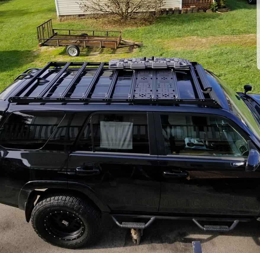

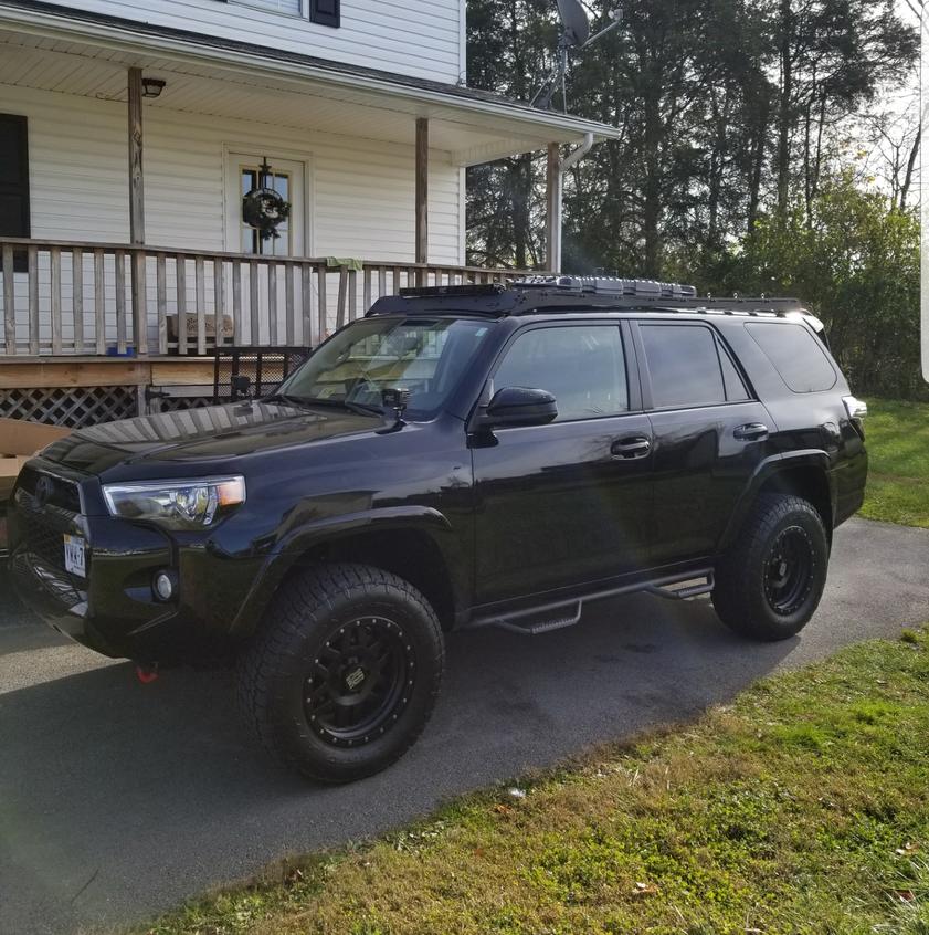

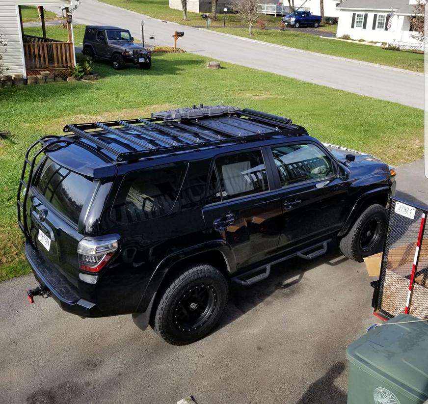

I got the full length rack and baja ladder intalled today. No issues with the fit. Ladder clears everthing even with the rear crossbar installed. Ill try to get some pictures up tomorrow
‘Cmon man!!!
Know your audience. You can’t post something like this and not follow up IMMEDIATELY with pics!!!!!
Some of us don’t do well under this type of stress. :ybrick::wtf:

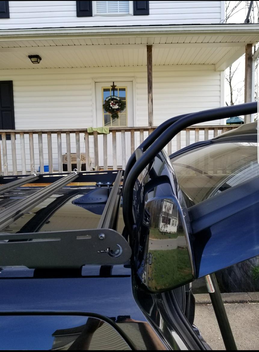

Here is the clearance with the ladder
If you install this ladder you will have to uograde the rear door struts. The factory ones are to weak to even hold the door up. If anyone has any questions ask away. The install is pretty straight foward. The load panels are a pain in the ass to intall after the rack is mounted. I wish i would have did them while the rack was on the ground
Great build. Looks amazing. Quick qestion tho, how did you route the lighting for the light bar on the rack?
Thanks. For the wiring i tucked it into the trim running beside rhe front windshield. There is a little groove and my wiring harness fit perfectly.
