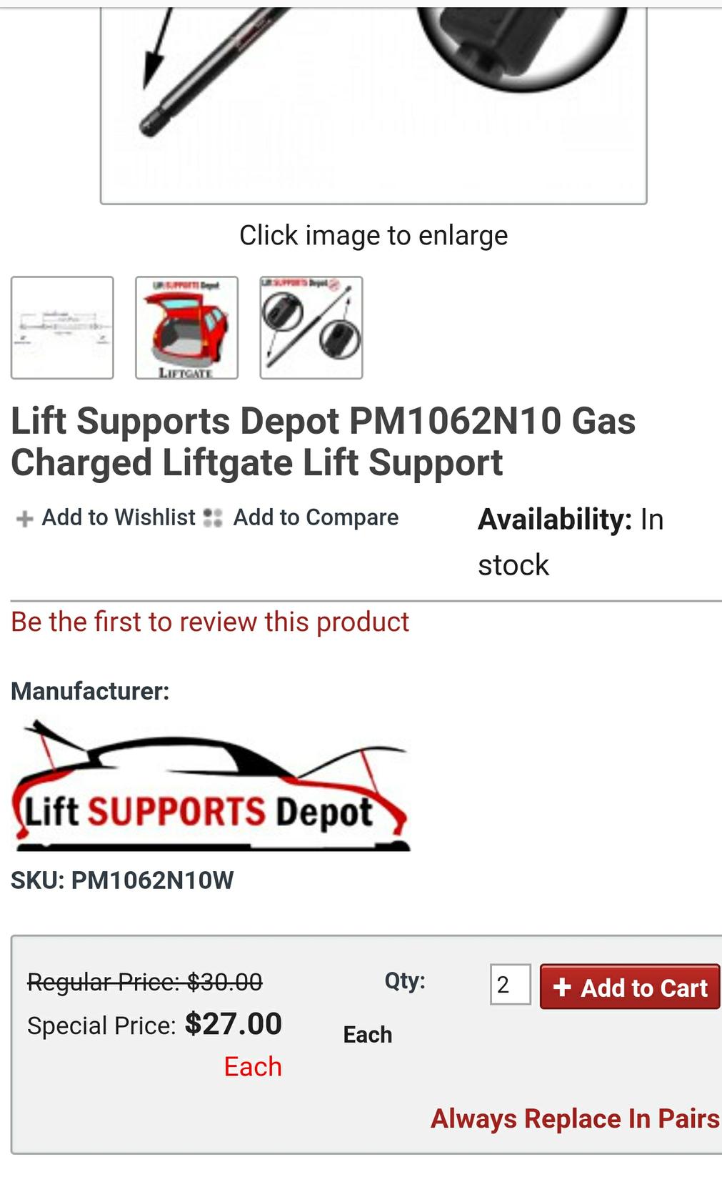

If you install this ladder you will have to uograde the rear door struts. The factory ones are to weak to even hold the door up. If anyone has any questions ask away. The install is pretty straight foward. The load panels are a pain in the ass to intall after the rack is mounted. I wish i would have did them while the rack was on the ground
Nice Rig and thanks for the photos and notes: My plan is to get the 3/4 Prinsu with the Gobi ladder soon. Your mention of the rear door struts capacity is the first I've heard of this with Gobi ladder.
Any other Gobi Ladder folks have any input/solutions?
i also have a small hatchet and a shovel mounted on the inside if the door . That might make a little difference but my factory struts wouldnt even hold the door up if i pushed ut up by hand
Dang.....I'm picturing a nice sturdy dowel rod in my future :)
This is what i used for mine. They are upgraded for ppl with ladders. Liftsupport depot is alot cheaper than gobi.

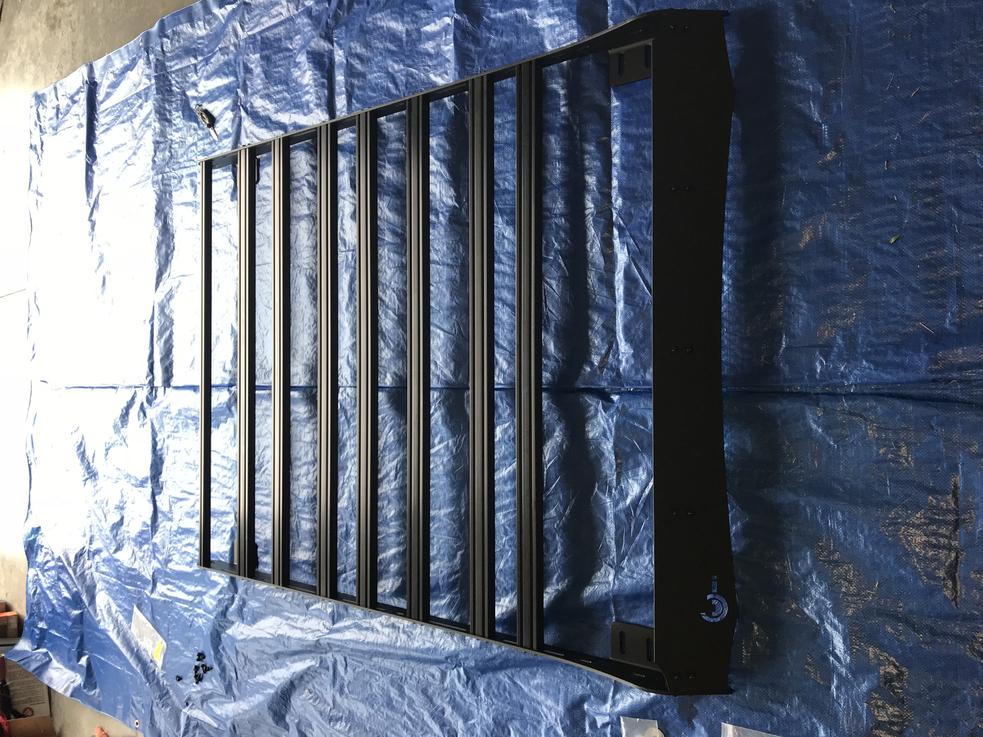

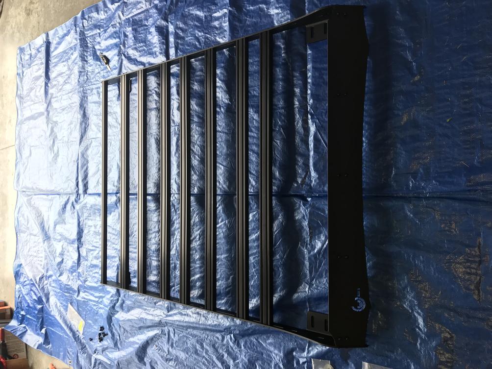

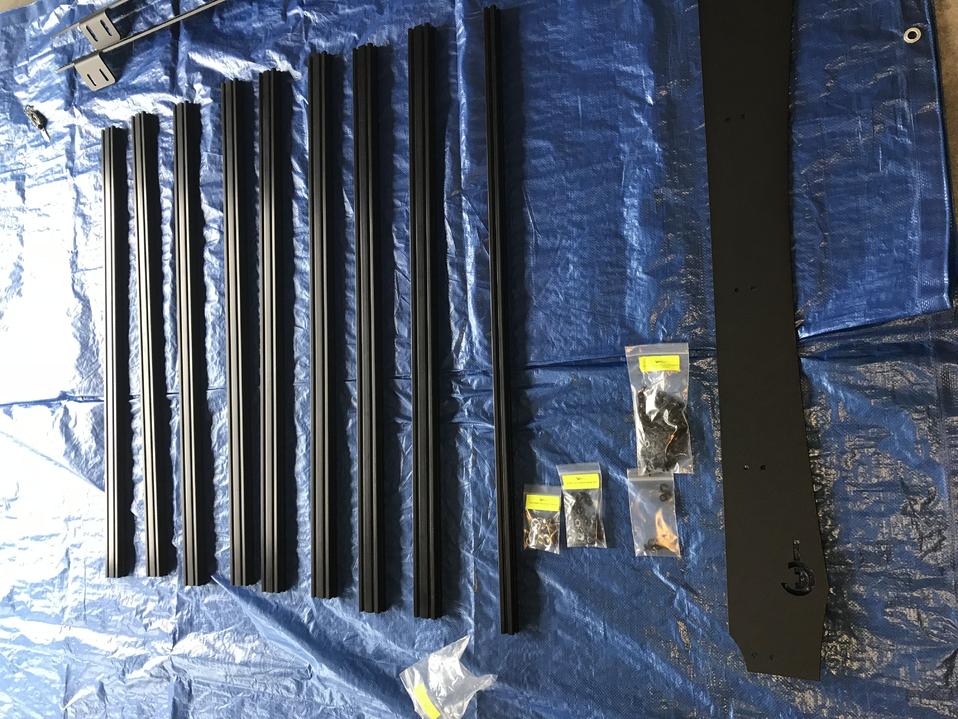

Prinsu rack arrived via UPS today. Well boxed and no damage on the package.
All the hardware is accounted for and the powder coating looks better than I expected, which is to say, no damage.
Assembly is fairly straight forward. Waiting for a friend to come over to help lift it onto the roof. Ill get more pics up after instal but its time for car line.
