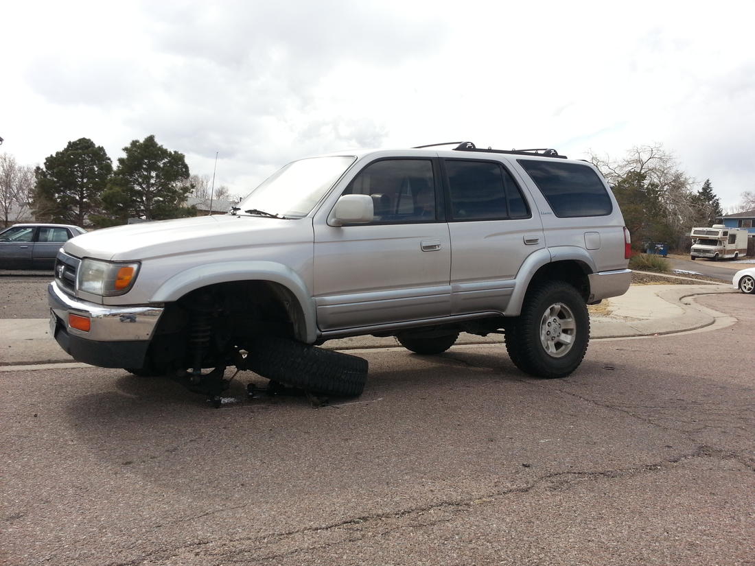

Just did mine with only 110k. They looked fine, but I drive my family around in this thing and it only took one of these pictures to make up my mind.

plans on lifting it? If you have no idea when if they were ever changed i would just change them. with LBJ it better safe then srry.

Regardless of how they "look" at the moment, assuming you have the original LBJs at 160k — if it was me, I would change them out with OEM ones and not worry about it again for a long while.
I saw this guy a couple weeks ago. It happens more than we think...
