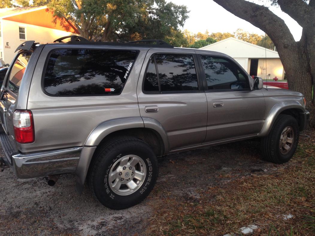

How it sits as of now. Not the best pic but just a quick FYI for you guys. Can't wait for all this to come to fruition.
