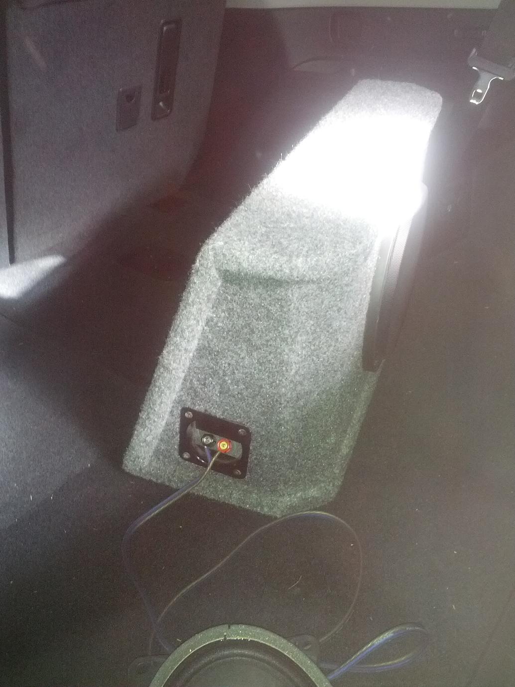

This sub can't handle the hd600/4, gain all the way down and already unbridged it, fader to front -3 and the woofer just bottoms out easily. This sub might be dud, or I just need a higher rms sub. Do you know a good shallow mount sub with 300 rms.?
"...This sub might be dud, or I just need a higher rms sub. Do you know a good shallow mount sub with 300 rms.?"
Well, think of it this way: Don't compromise by trying to find a speaker to fit into an inferior box; that's like buying a wedding ring because it's on sale, then trying to find a bride who'll fit into it. :crazy:
Instead, maybe do this. Pick up an Empty "sealed box" for $35 bucks or so: Amazon.com: Bbox Pro Series Single 10-Inch Sealed Subwoofer Enclosure (Charcoal): Electronics Then, get a used JL "10W6v2-D4" driver (sub); can be found on-line for $100 bucks, or an Alpine "SWR-10D4" both incredibly superior devices, and will handle 600W "true RMS". With other audio components, you may get away with cutting a few corners here and there, but with subs... you'll be truely sorry you did it; tis the nature of the beast!
Greg
I know what you mean but unforunately I need something that'll fit behind third now so I don't have to take it off when I use third row and the box I got fits perfectly behind there.
This pioneer sw2501s4 got some great reviews. Might pull the trigger later today unless you can suggest another option.

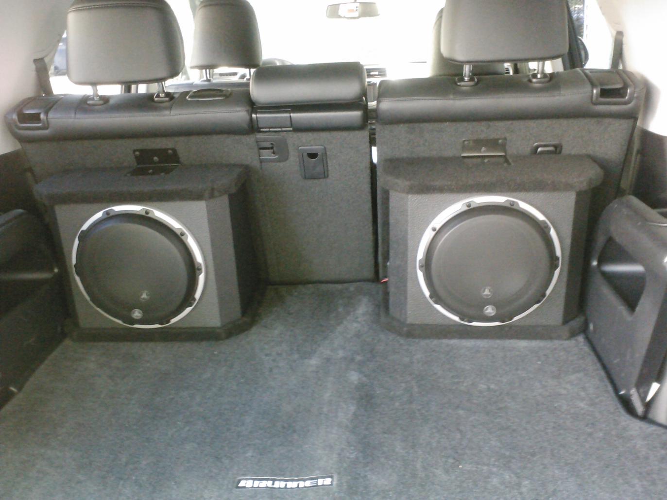

I've got two, "Empty" JL CVS110-RGW6v2 cabinets that I bought when I first got the truck in April, 2012. The drivers were removed when I started my next project, which was a large, 2x10 bass reflex cabinet. The cabinets are quite small but with the right drivers, will kick some serious booty! you are welcome to grab them if you are willing to pay the Shpg costs, "US Postal Service". I'm not sure if I am allowed to discuss any selling price here on this forum, but I'm not trying to get rich this way. If you're interested, you can P.M. me and I'll give you my email addr. "here's a photo"

"...What's the dimension of the box? Looks deep though . If its over 10 in deep doubt it will fit with 3rd row up. ...my box slopes though, so it has to be really shallow"
These boxes are shaped just like yours, a wedge. They're made to fit behind the back seat of an suv, so they fit tightly against the "backrest" of the seats. Their dimensions are: (W)14"x (H)12.5"x(D1)11"x(D2)7" Note: D1 = bottom depth, D2 = Top depth P.S: Please don't think that I'm trying to sell you anything, they're packed away in storage and are not for sale. It's just that I see you struggling to pull it all together, and doing a fine job; I guess I wanted to help. "Keep up the great work"!

I tried to take photos with my phone that I think might be helpful for others in the future. So yeah I'll post them up when I get the time off again. The sub is on its way here tuesday, damn veterans day delaying my fix for bass..
