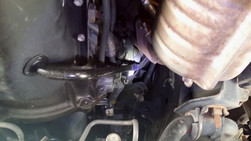

I will be working on my starter this week. I saw a few threads were people were able to get it out from the bottom without taking the wheels off. Is this possible? I have a 99 4wd 3.4.
Unfortunately it died in my condo parking lot and I cannot really work on it there so Id prefer to just get under it and get it done that way is possible.
I was able to get mine out from underneath w/o removing anything but the
starter bolts. I'm not saying it was easy, but it was possible, at least on mine.
Any tips or tricks for doing it this way?
Would prefer to get it from underneath, but I figured it definitely would not be easy.
Thanks,
Nothing special, though it was ~a half hour of twisting and turning. I did not
have to take off the engine shield. Here's what under mine. If you have anything
more in the way than this, consider the wheel-well exit option.
