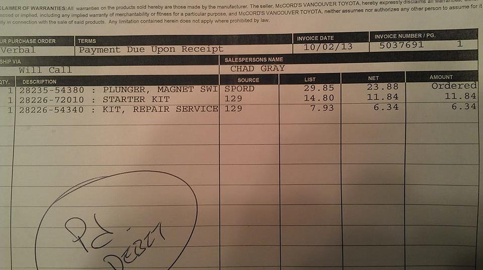

Are these the correct part numbers for a '99 2WD V6 auto?
Are these really the part numbers for a 4x4, 3.4L V6 3rd Gen (1998)? Would be incredibly helpful if someone could confirm. All I have to do is get these and I'll be good to go?
yes the parts listed in the top quote are the correct part numbers for the rebuild.
plunger, magnet switch pn- 28235-54380
starter kit pn- 2822672010
kit, repair service pn- 58226-54340
