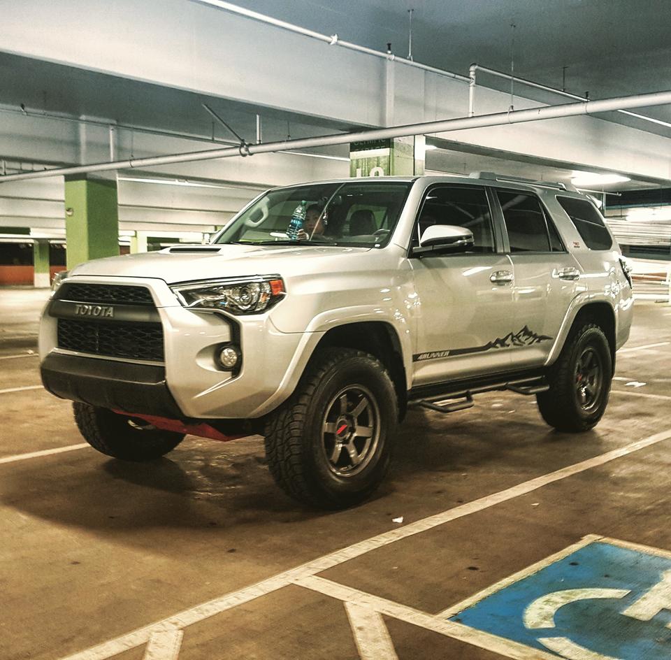

I swapped an OEM trail hood onto my SR5 a week ago. Absolutely useless but I think it completes the front end of the '14+ T4R which already has a mean fascia and by adding the hood and lower valance it gives it a "complete" and less so naked look. IMO.
I lucked out and ran into a local TE owner who happened to have another oem trail hood in his garage and in the same color as my truck!

Looks awesome! Were you able to get the hood to fit better?
