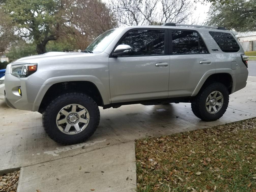

You should be good. My wheels have about the same specs be it a 17” vs a 18”. Backspacing looks good. My tires are a little bigger though and I did CUT and trim a bunch. Every truck is different though.

3' Toytech Ultimate here, basically same as what you're doing. I highly recommend doing aftermarket UCAs while you're at it. I went with ICON DJ UCAs after a few weeks, the "darting" at freeway speeds was terrible. Drives like new again.
17X8 FN Wheels FX Pros and 285/70/17 Mickey Thompson Deegan 38s.... zero rubbing.

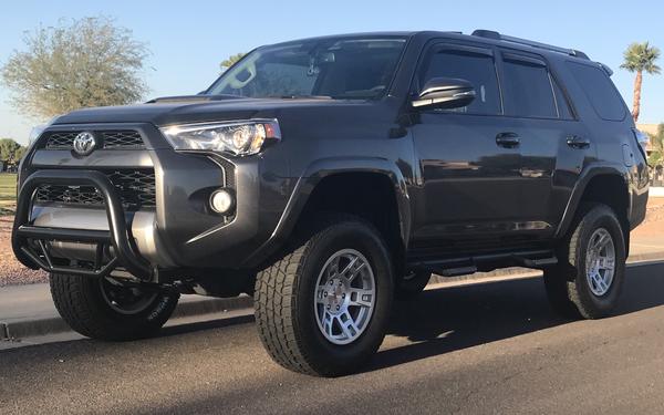

Ended up going stock for now to save some cash. Rides great. Maybe rims will have to be in the future.
