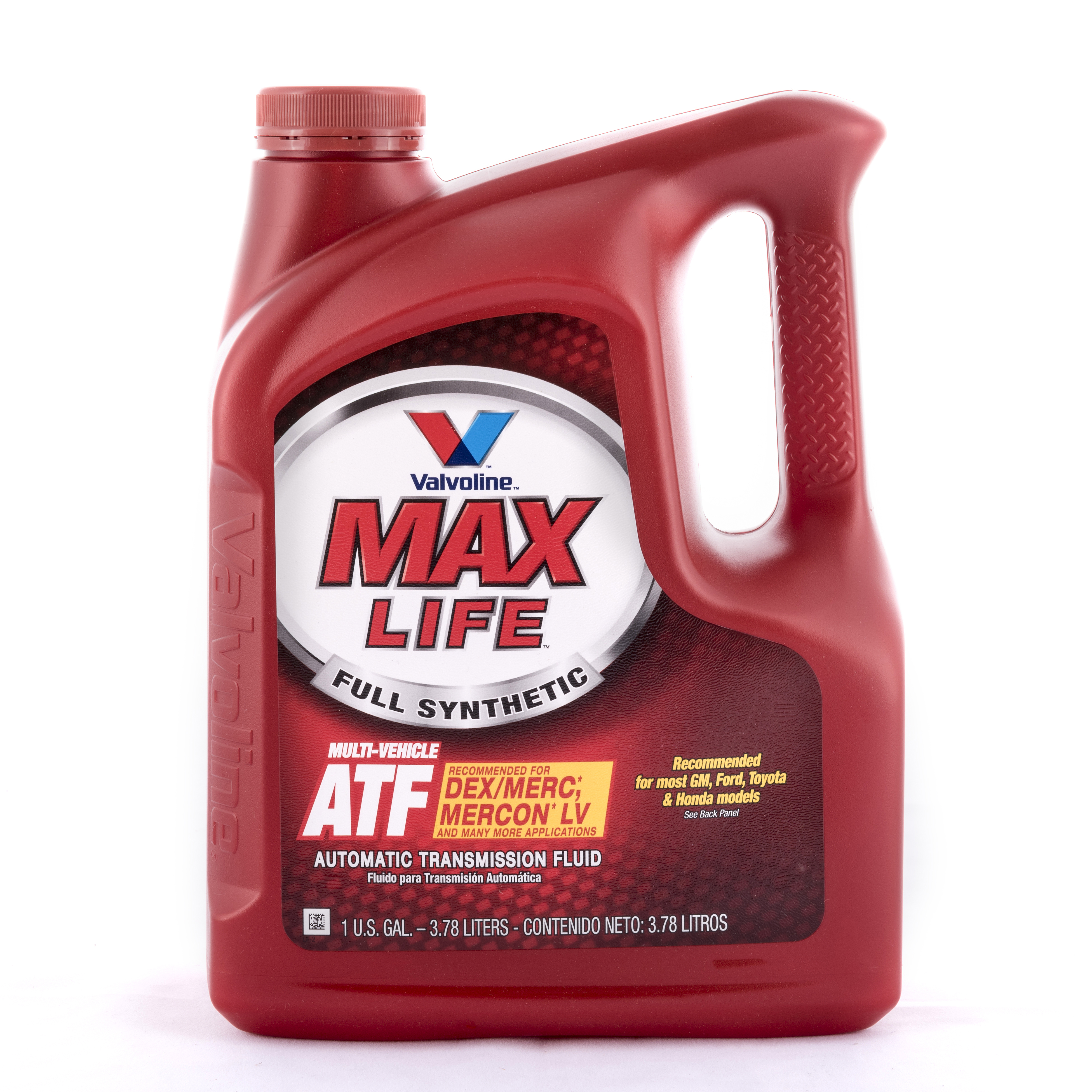

Got two of these coming on Tuesday. Less than 18 bucks each delivered, which seem reasonable...
I will cycle through these two gallons, then ponder more afterwards...

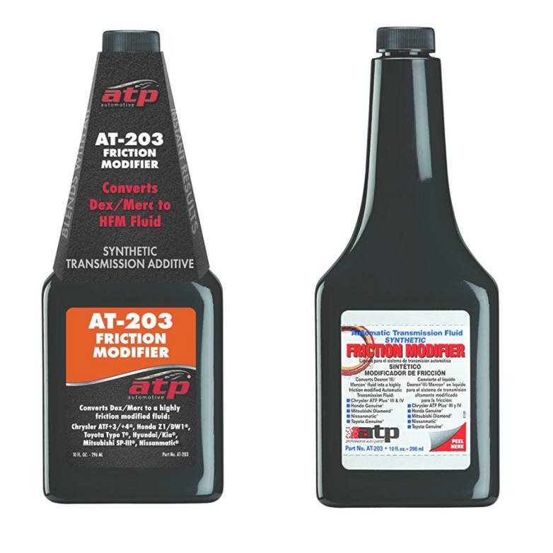

Did a drain and fill on my 2WD trans last night. Only recovered 2.1 qts so that's what I added back.
Went skulking around on the internet, found dis
ATP Automotive AT-203 ATF Friction Modifier Synthetic Transmission Additive

Actually, I would be reluctant to use it until someone with a 4runner used it for a ton of miles. I am pushing 178k now, at the p.o I bet had pink milkshake at 110 because the service records indicated, drivability issues....the fix was new radiator and flush trans. All done at the Toyota dealer
that said....I'm afraid to run anything other than the amsoil I am running in it now, with a magnafine filter and a B&M cooler
but if there is real proof it helps our trannys, I might do it ......might.....someday

Ths stuff says it's specifically formulated for Toyota and Amazon greenlighted it for my vehicles while it told me other additives were not compatible.
I've got a bottle coming Monday and will report back when I use it
