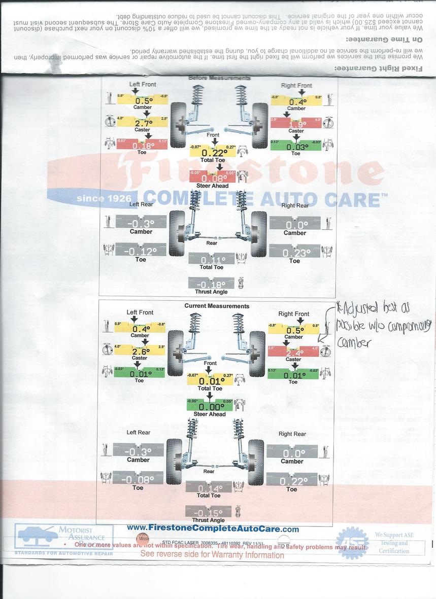

Had another alignment done today. The tech at this particular firestone told me the specs from the previous alignment was way off from what I was given.
Here they are now:
