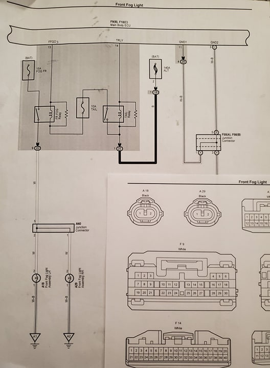

2019 FOG Light mod believe it is simpler then ANTMAN even outlines.
If you Only want Fogs capable of being ON when you have
1) running lights/parking lights
2) Low beam +fogs
3) Low +Hi +fogs
4) Retain Auto/DRL mode where Fogs STAY OFF in DRL mode but turn on automatically if light sensor said turn on headlights.
5) Retain ECU fail safe/time out on turning off headlight and fog lights if left on after shutdown.
Appears that if you run Auto/DRL mode that the Fogs would stay OFF in daylight/DRL mode as PCMs logic would still apply as the "tail" relay would not be energized/closed as tails are not on during DRL mode.
With that said it appears from the attached picture one would only need to ground pin/wire 13. Fog switch on the stalk would have no functionality other then to signal the ECU to light the fog light indicator on the dash via CAN bus
Another thing to still work out is if you wanted the stalk fog light functionality /have interrupt capability on the fog by using the stalk switch as an interrupt to the ground path.. ( simple just wire the switch in line....)
However what if you wanted to retain your fog light indicator on the dash as it is in the OEM config ( lit in the LOW beam config and off in the hi beam stalk position) then perhaps diode isolate the ECU FOG ground signal from the +12 current on PIN 13... need to research if diode isolation will still retain ground signal to ECU if the other side of the diode has +current on it but flowing to ground point.
If this works then its much simpler then wiring in a relay...

So are you saying that the fogs would always be on if the lights were on? Or would the switch on the column still turn them off when desired?
