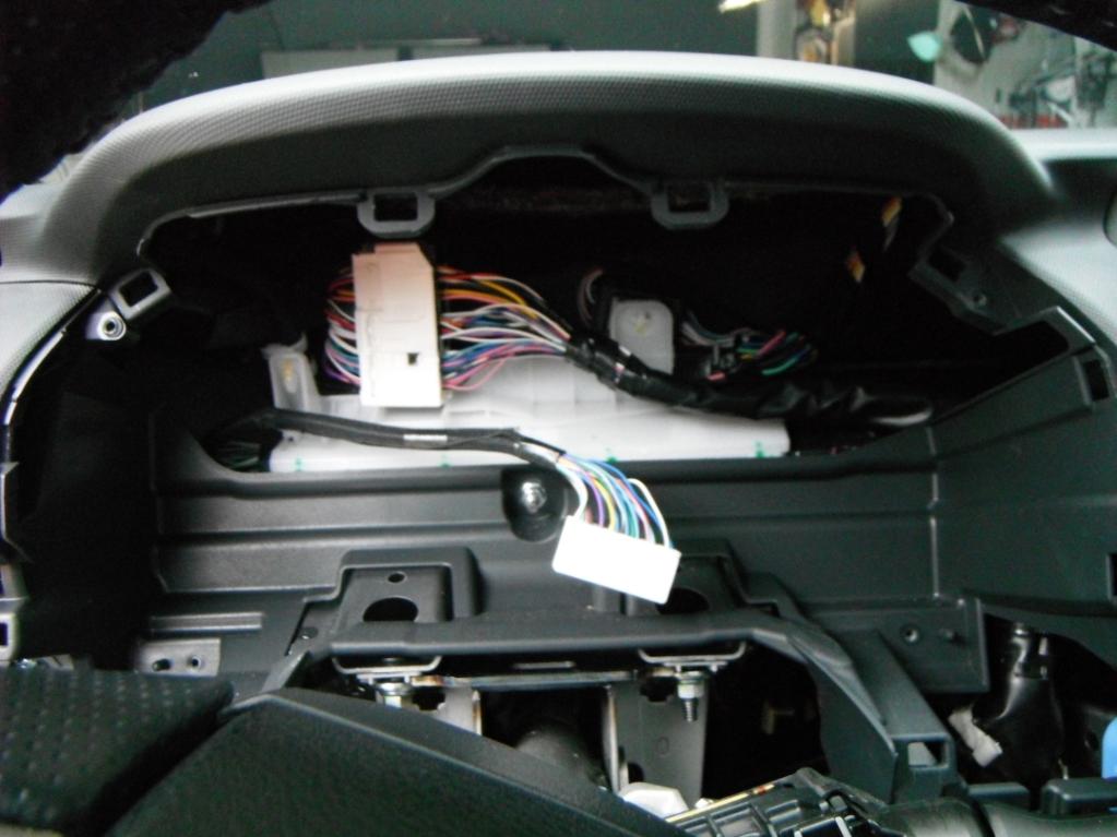

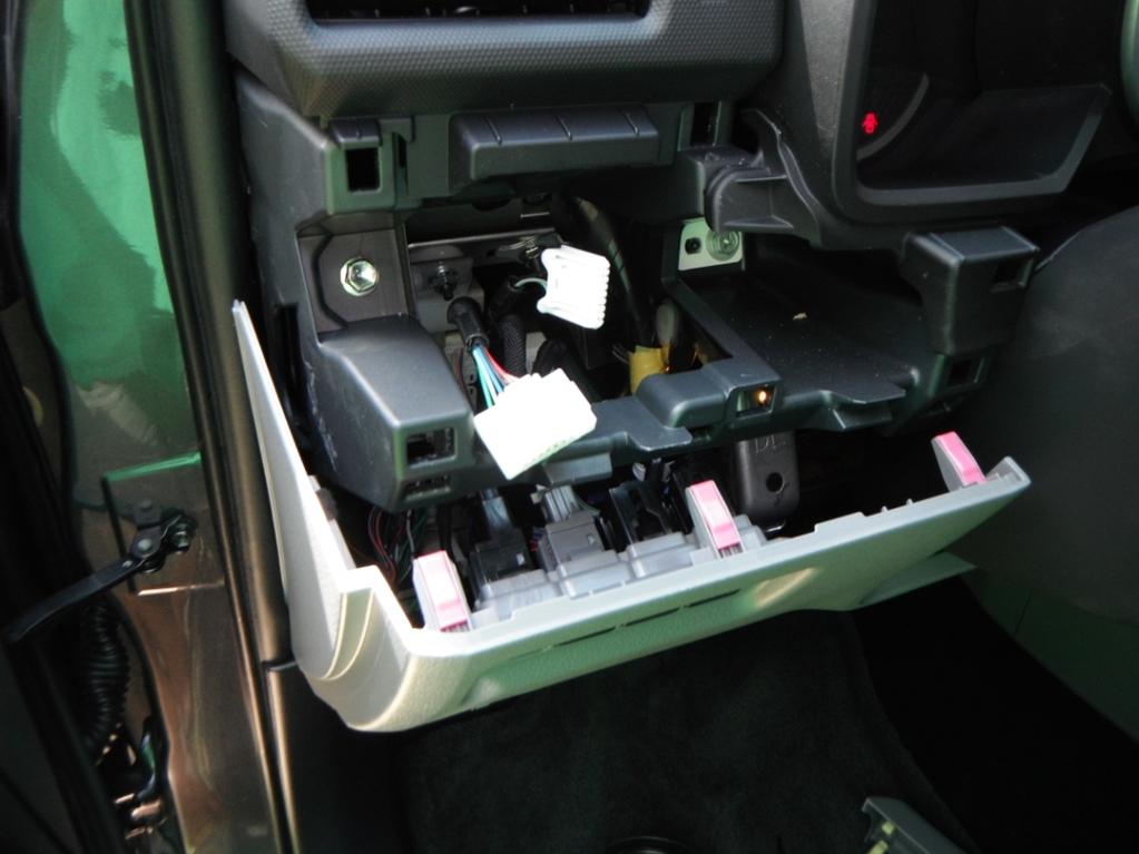

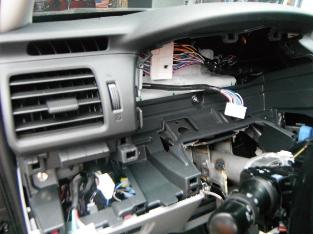

Pull apart your dash- and I mean that literally. The switch panel pulls towards you, and the lower dash just pulls away (you won’t need to remove this completely)

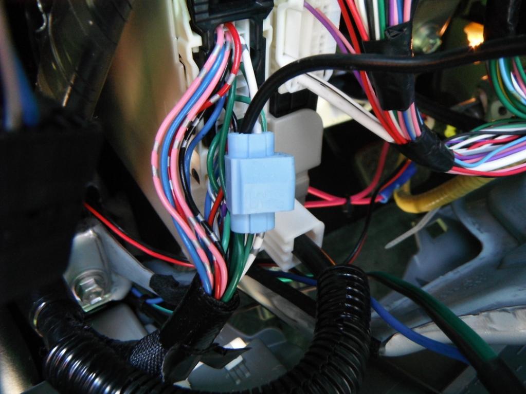

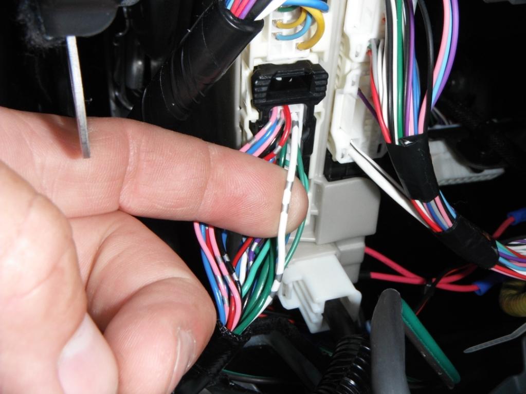

This is the location for the factory fog-light feed. PLUG 2D, PIN#9 from EWD
This is the wire- white with silver specs. This wire will “feed” the fog lamps.
Tap into this wire with a 3M wire tap. We will connect this wire lead later.

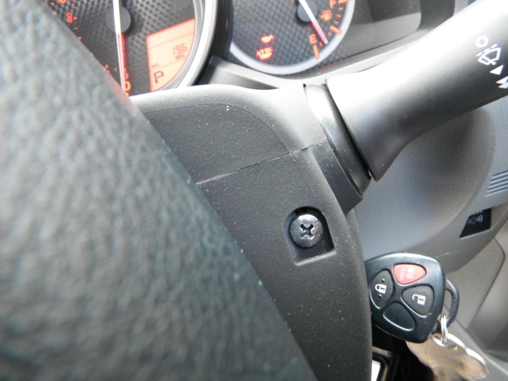

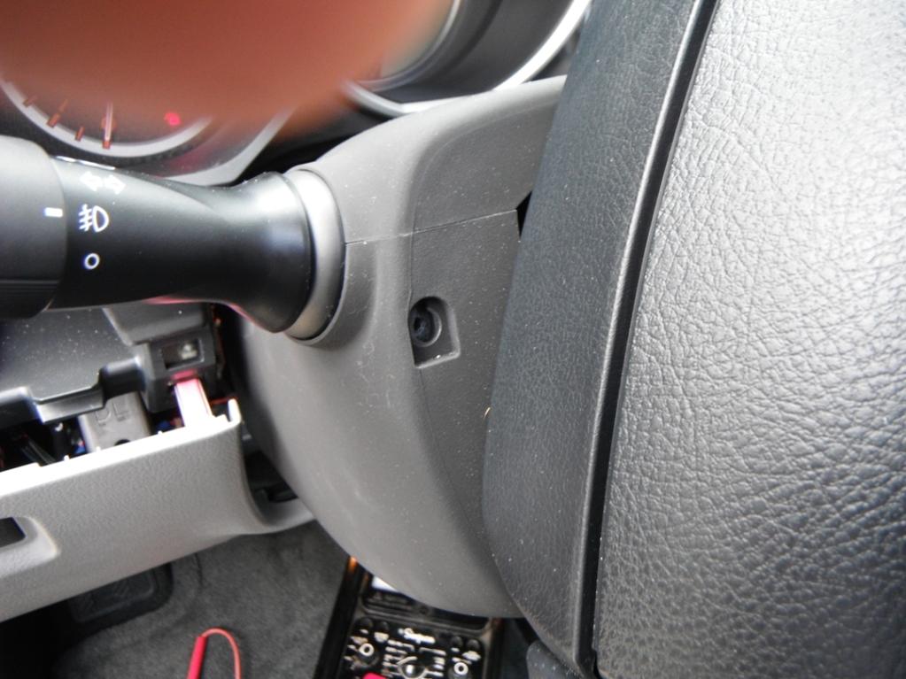

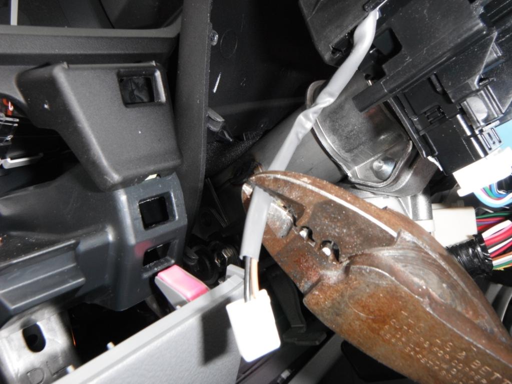

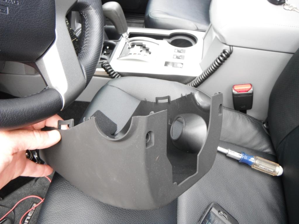

Time to take more apart! Remove the lower portion of your steering column with these 2 screws

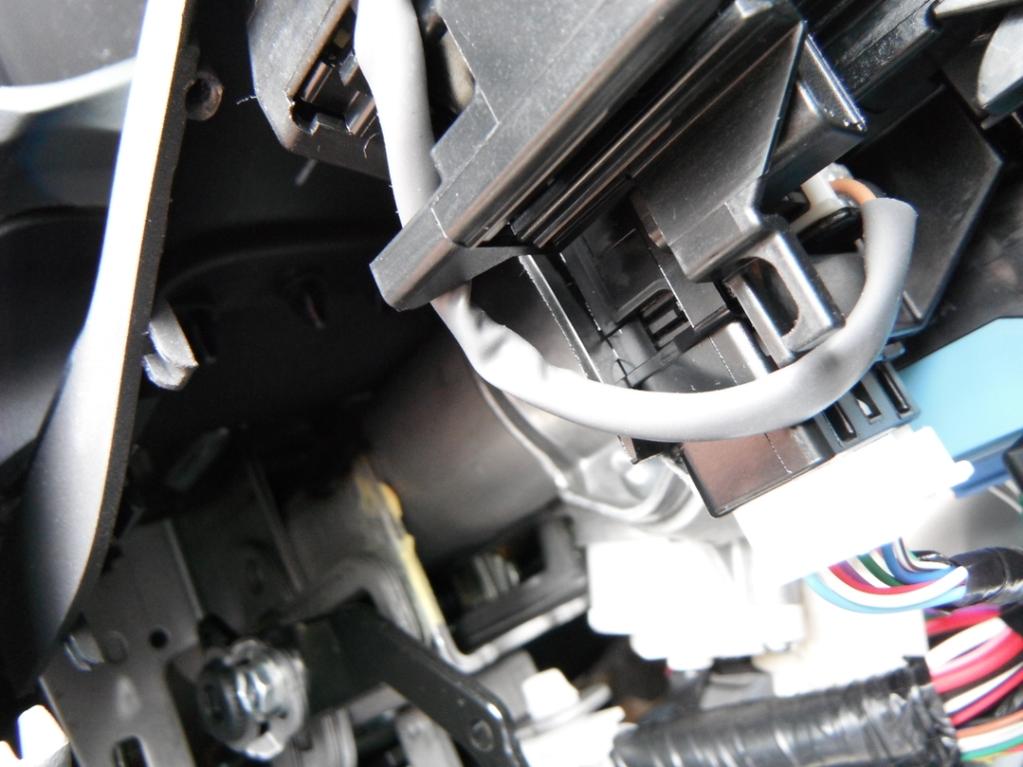

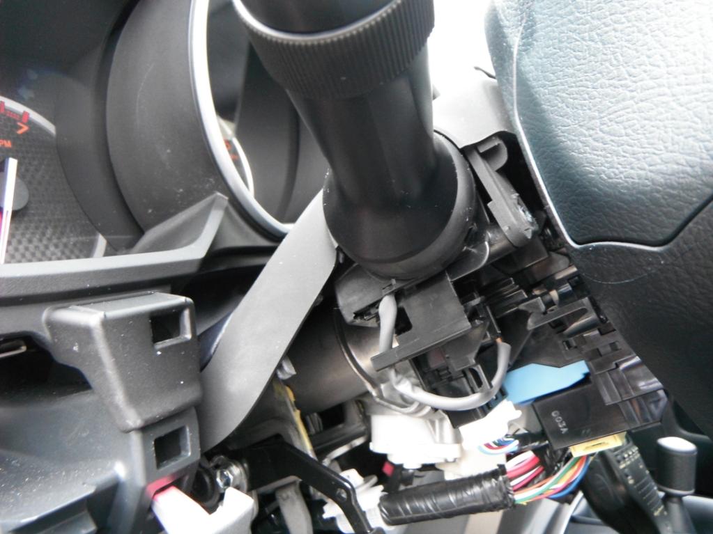

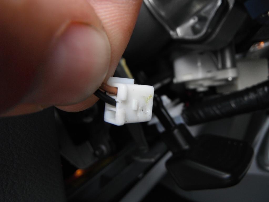

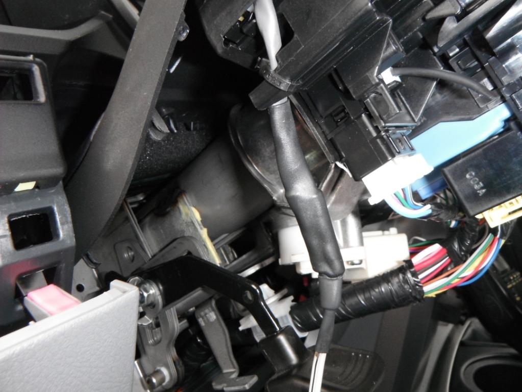

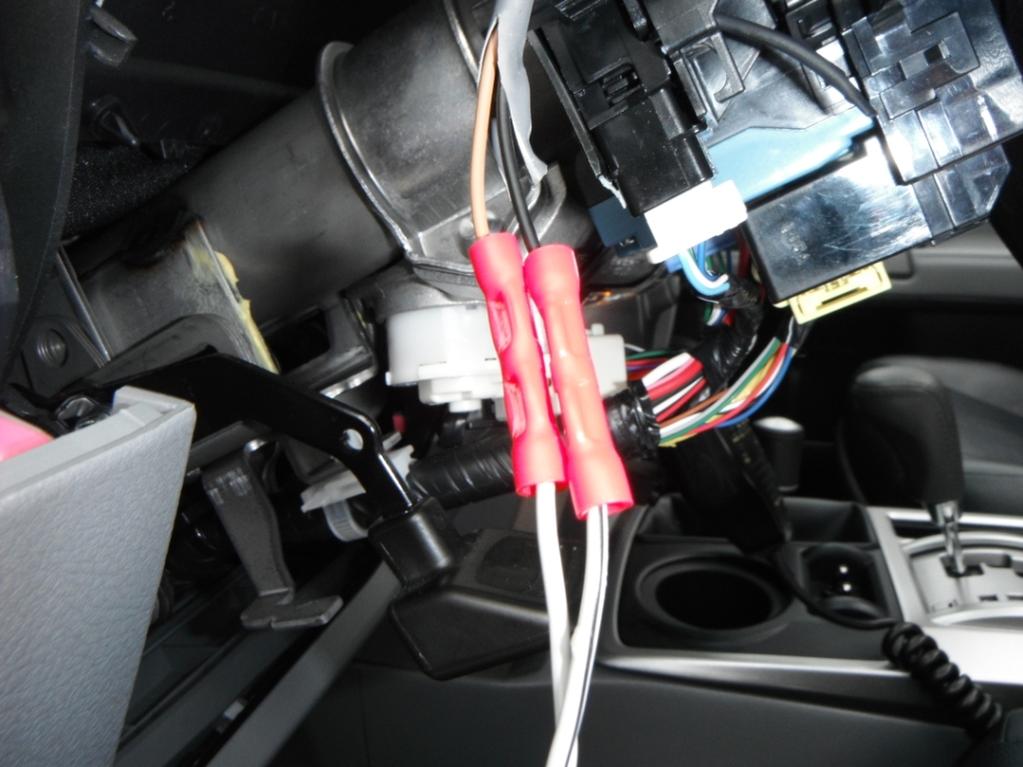

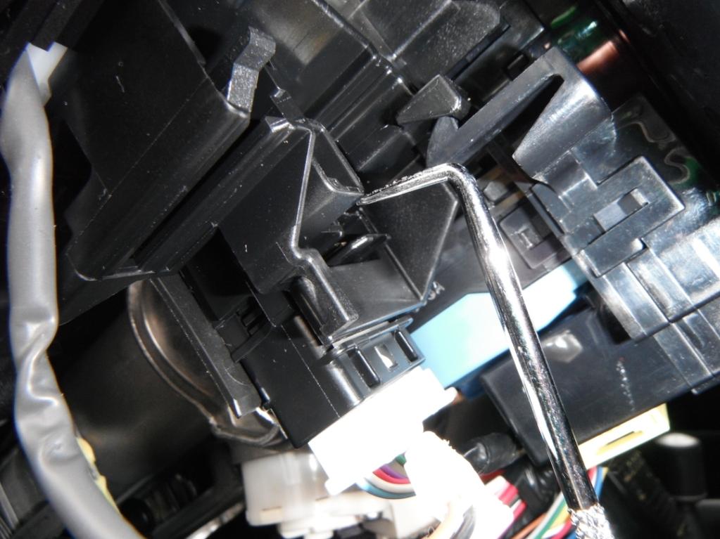

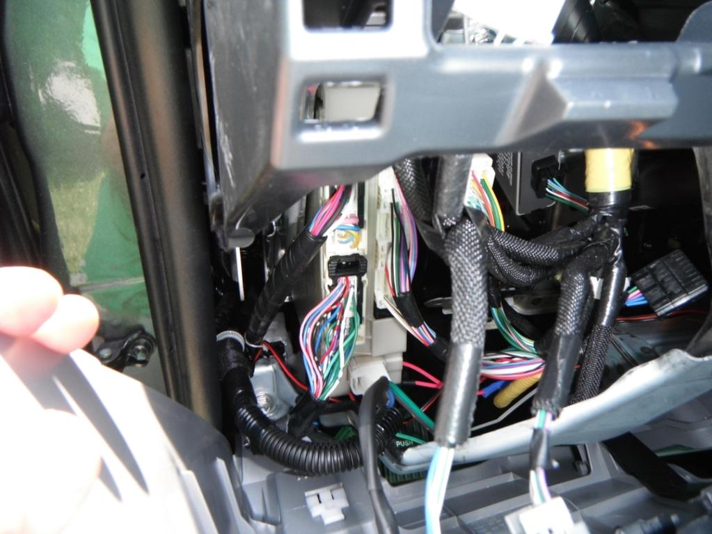

See this wire bundle? These are attached directly to the fog switch. Brown, and black under the shrinkwrap...
This plug is NOT easy to remove. I used a right angle pick on the top of the plug and pulled it out. Be patient here!
Cut the wires and connect each to a length of wire. I reinstalled the original plug (insulated), and shrinkwrapped the connections

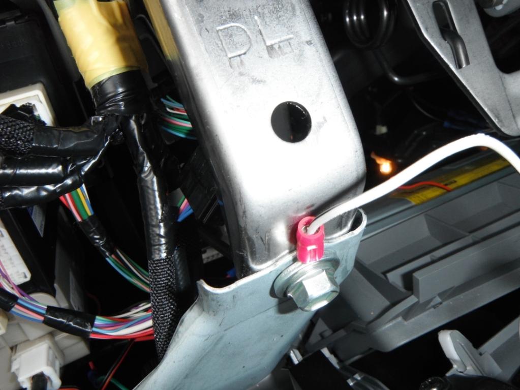

One wire will go to a ground (doesn't matter which, but I used the black one). Here is a good ground…This is a metal dash support behind the lower panel you have pulled off. This will be very evident when you have it apart...

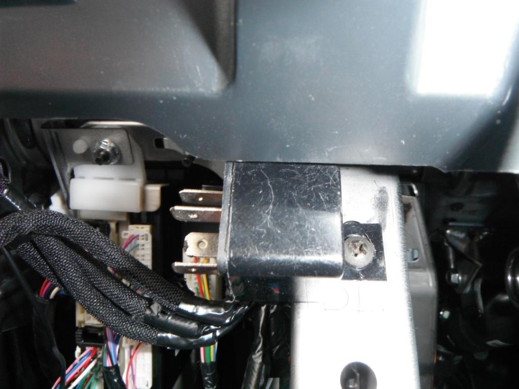

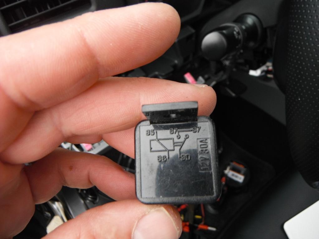

This is a standard relay – don’t get all worked up- it’s easy to hook this up. Relay's are like heavy duty switches that are controlled by, in this case, another switch. This will enable your lights to work without burning up your factory fog-light switch! The relay can mount here, right above the ground location.
I used a j-nut behind the metal dash support, and a screw to secure the relay.

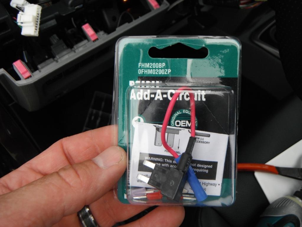

You will also need 2 mini-fuse taps (unless you want to cut more wires…). You can get these at any auto-parts store. Make sure you install two 15a fuses in each one! (buy fuses when you buy the taps, factory fuses won't fit!) Make sure you read the included instructions- these need to be installed correctly to properly protect the circuit. This is very important!
These minitaps will plug directly into your fusebox in the following locations: lower right (FOG FR 15A), and upper right (P/OUTLET 15A).

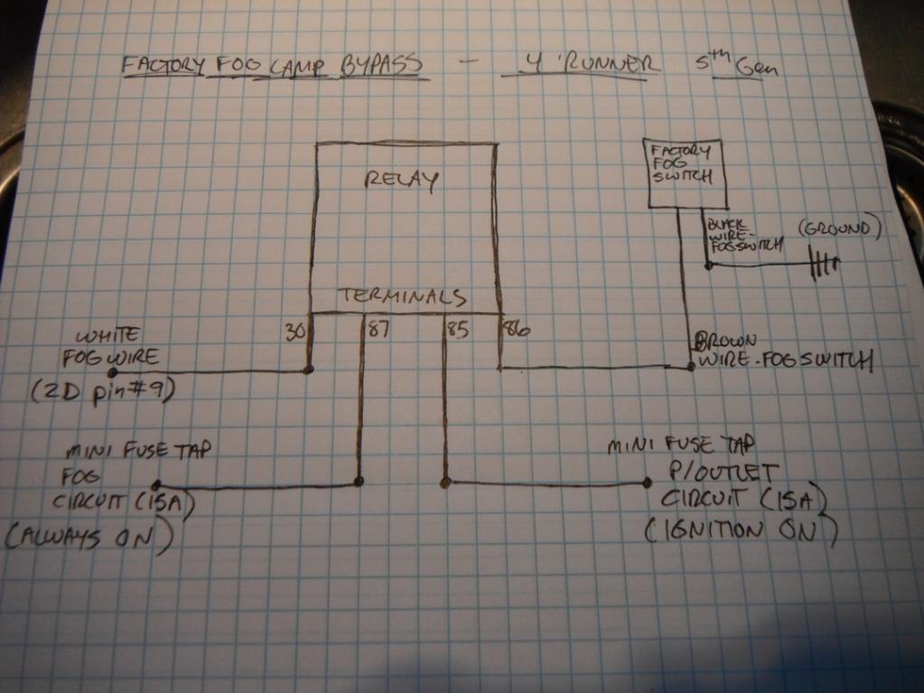

Attach some wire to each of the supplied connectors on the minitaps, and feed the wires to your relay location. Attach some female spade connectors and plug them into the relay:
Your relay will have numbered attachment terminals. The minitap from the FOG FR will plug into terminal #87. The minitap from the P/OUTLET will plug into terminal #85.
One more connection to make! The lead that you tapped into the White fog-light wire. Attach a female spade to this, and connect it to the relay terminal#30.
Sounds confusing- but very simple. Here is a wiring diagram I drew up for you guys (and girls!):

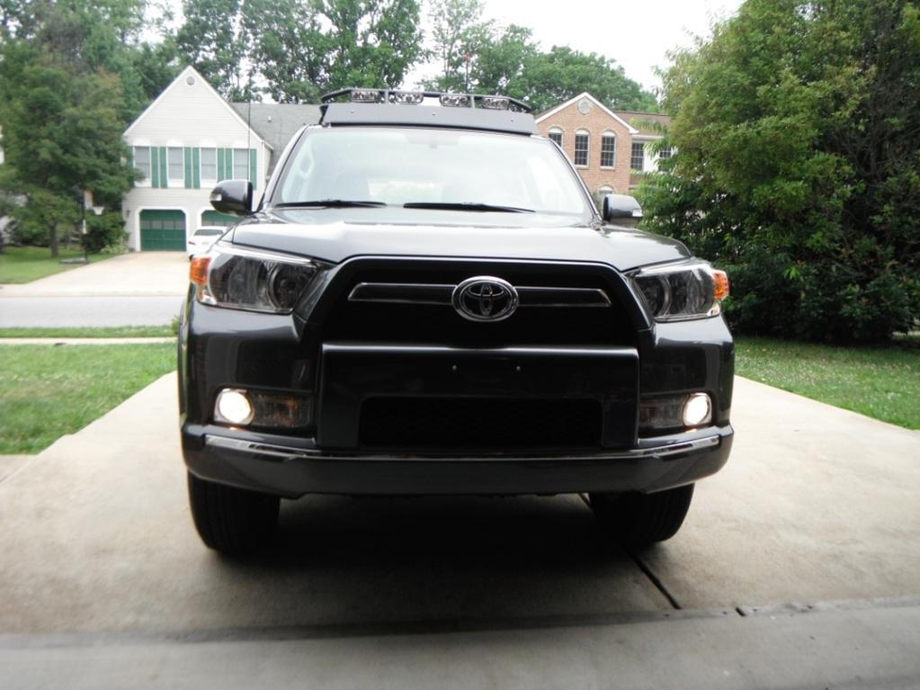

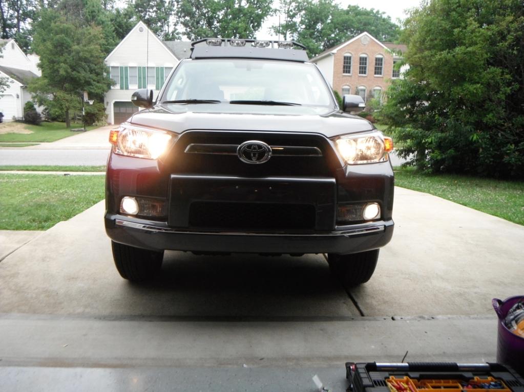

This is what you end up with.
Fogs only
Hi-beams with fogs
<O:p</O:p:thumb3:

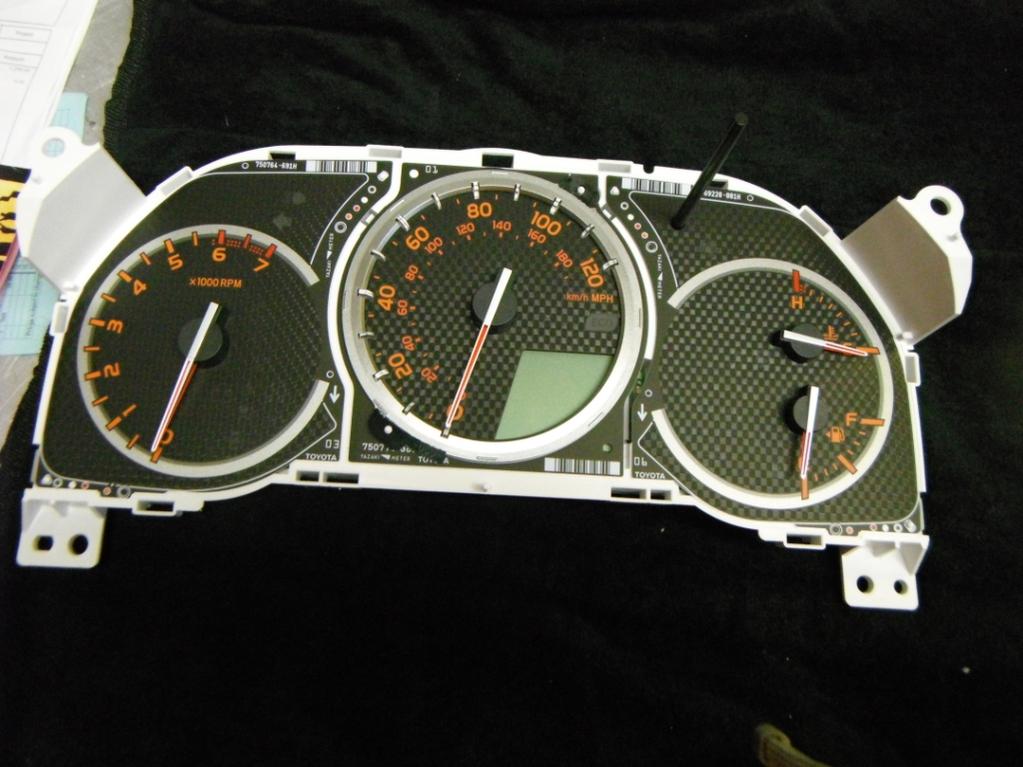

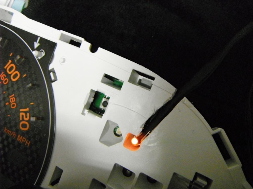

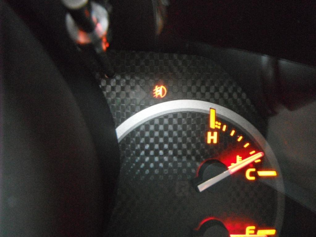

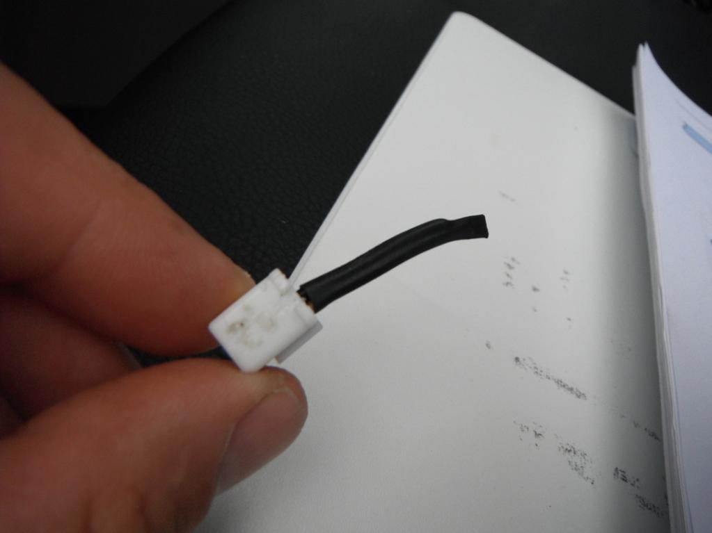

Well, it took all of 24 hrs, and the "Fog LED not lighting up" thing bugged me enough to do something about it. I took the dash apart -again- and buried an LED in there behind the FOG indicator. I used an orange LED, mostly because I didn't have any green available, and the electronics store is 30 mins away. What do you guys think about it? I'm not sure yet, may just throw a green one in there since all the real work is done for this...
The entire dash comes apart without any tools, except for a phillips screwdriver- thanks Toyota!
Here's what you need to pull off:
*The plastic panel where your fan switch is located
*The panel to the right of the steering column that houses the useless "party mode" button
*The panel to the left of the steering column that has your mirror controls
All of these panels pull towards you- use your muscles!- to come off

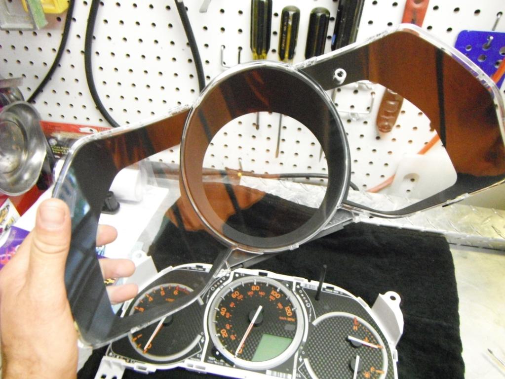

The steering column screws, under the steering wheel, need to come off and then you can pull the black plastic guage surround off. it's connected to the top of the steering column plastic with a piece of vinyl.

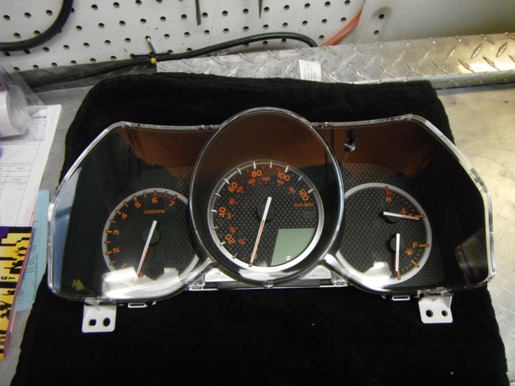

4 screws remove the cluster, and the plug is on top. Here's what you end up with...
The top of the cluster has molded in black plastic tabs holding it on. Simply take a small screwdriver and- patiently- work your way around the cluster to remove it.
Remember this- every time you look at your dash you will notice any dirt, dust, or fingerprints you get in here! Be careful...

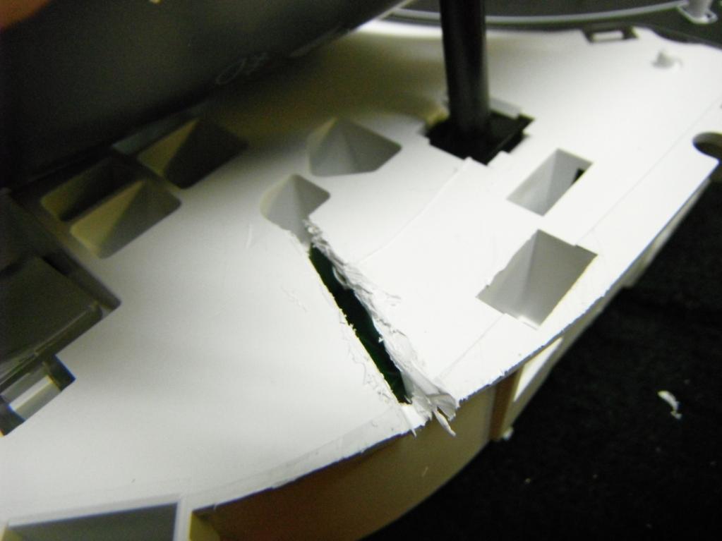

I used a hobby knife to cut a slot for the LED , and it's wires. You can't access this area without removing the needles for the guages, so this was the only way to get it in there! I cleaned up this cut significantly, before I was done- forgot to take a picture...
Here's a LINK on how to make LED's like this one that's buried in the slot. Note: The long black push-button that goes through the hole in the guage face pulls right off, and snaps back in easily. This made the job alot easeir once I figured that out :)
I messed around with the positioning of the LED, to try to get the lighting as even as possible.
Now everything can go back together. The ground to the LED gets connected to the ground in the FOG MOD writeup, and the hot-lead ties into relay terminal#30.
Here is the result, whenever the fogs are on...

Very cool. I wonder how many warranties you've voided so far! j/k. Looks great. (I know you will end up getting the green LED, it's driving you crazy already isn't it?) ;)
