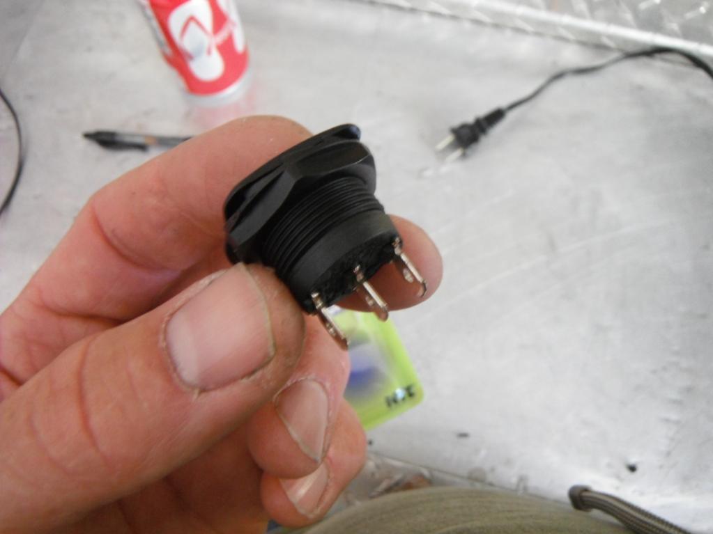

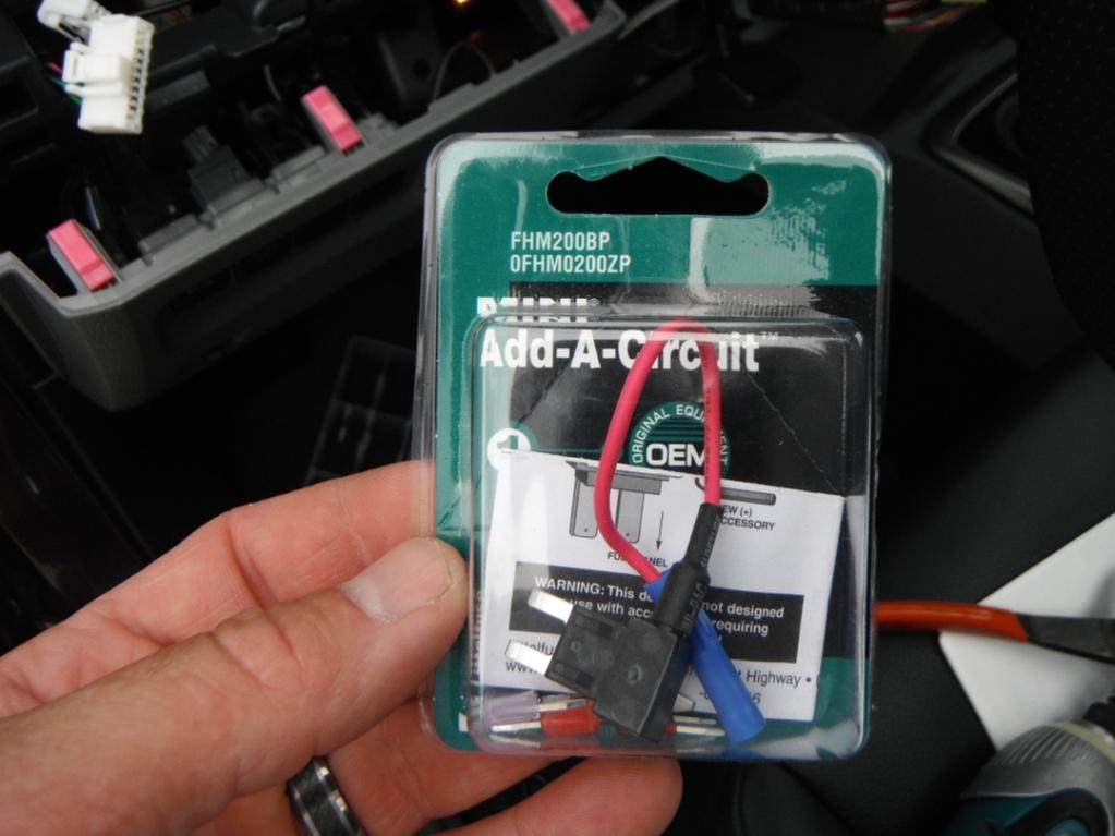

This mod allows you to use your factory 12V outlet in two different ways via a switch. The outlet will either function exactly like it does now, meaning 12v power during ignition-on only, or 12v power all the time, your choice. I find it most useful for charging my phone overnight, or charging my GPS for the return trip home…
Yes. This MOD requires cutting, and drilling big ¾” holes :wtf: in Toyota plastic, yikes!! Truth be told- you only have to cut 1 tiny little green wire, and you can put the switch anywhere, so technically speaking-
You don’t need to drill a hole at all. Sticky-tape the switch to your dash, if that’s your thing. :)
Here’s what you need for the MOD:
<O:p
</O:p
· Mini Fuse tap
· 10A Mini Fuses (2)
· SPDT switch.
· 16ga wire
<O:p</O:p
... hand is lookin' a 'lil bit rough. . .
<O:p</O:p

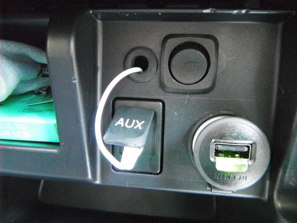

This is what the finished MOD looks like.
<O:p</O:p
<O:p</O:p
The white wire coming out of the hole is another mod for my CB- so ignore that, OK? The 12V MOD is just the switch- that’s it. I also chose to remove the flip-down cover over the 12V outlet. I just plugged in my USB adaptor, which has a built in LED, and I have visual indication of whenever the outlet is powered on.

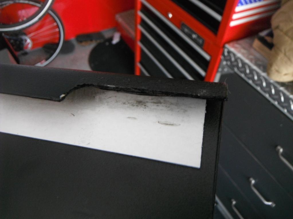

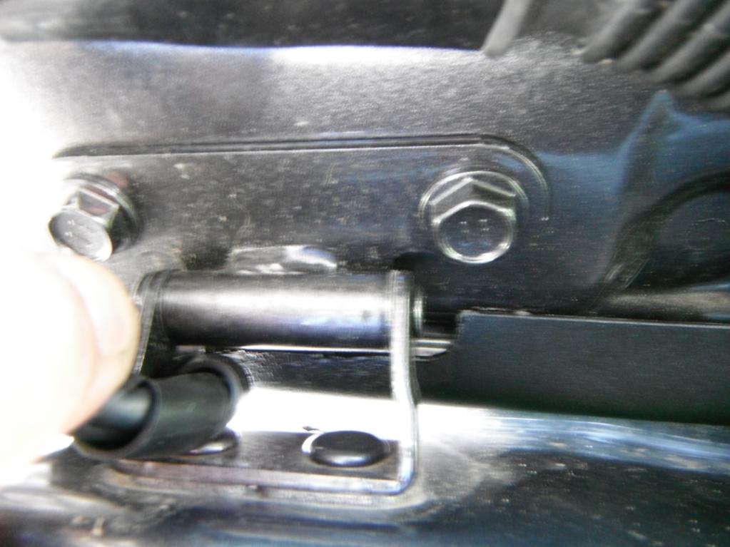

In the meantime, I received my Gobi ladder today :) I ran into the same problem as alvorbn did during his install. he did a nice writeup on the install HERE

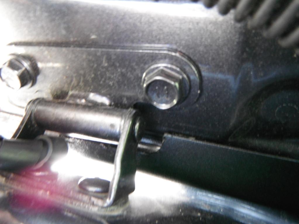

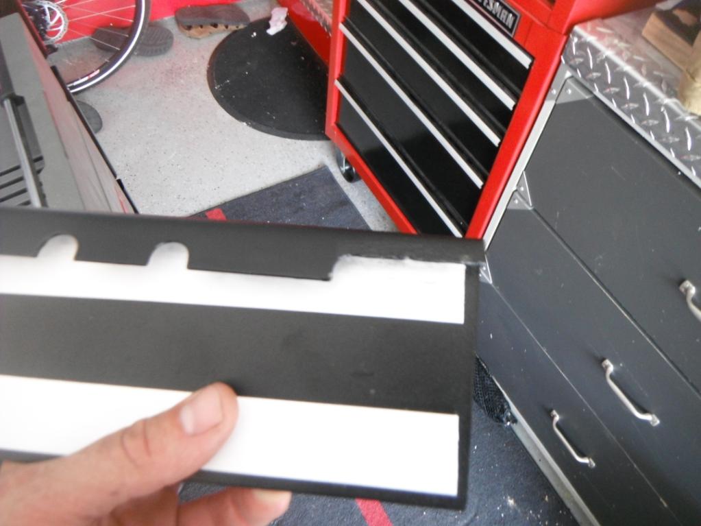

I didn't bend the upper bracket to make it fit. I trimmed a little off with a Dremel and a fiber cutoff wheel. I touched up the bracket with some black Plastidip. It appears that the bracket is used for other vehicles as well(?). The problem is that the bracket hits the driver's side hinge underneath, which won't allow the bracket to sit flush on top of the hatch. I trimmed evenly with the big U shaped holes in the bracket to allow clearance for the hinge.
Here some pics of the underside of the upper bracket and where I trimmed it
You can see how it clears the hinge easily now. (The wires in the pic are power for the rack, and CB antenna)

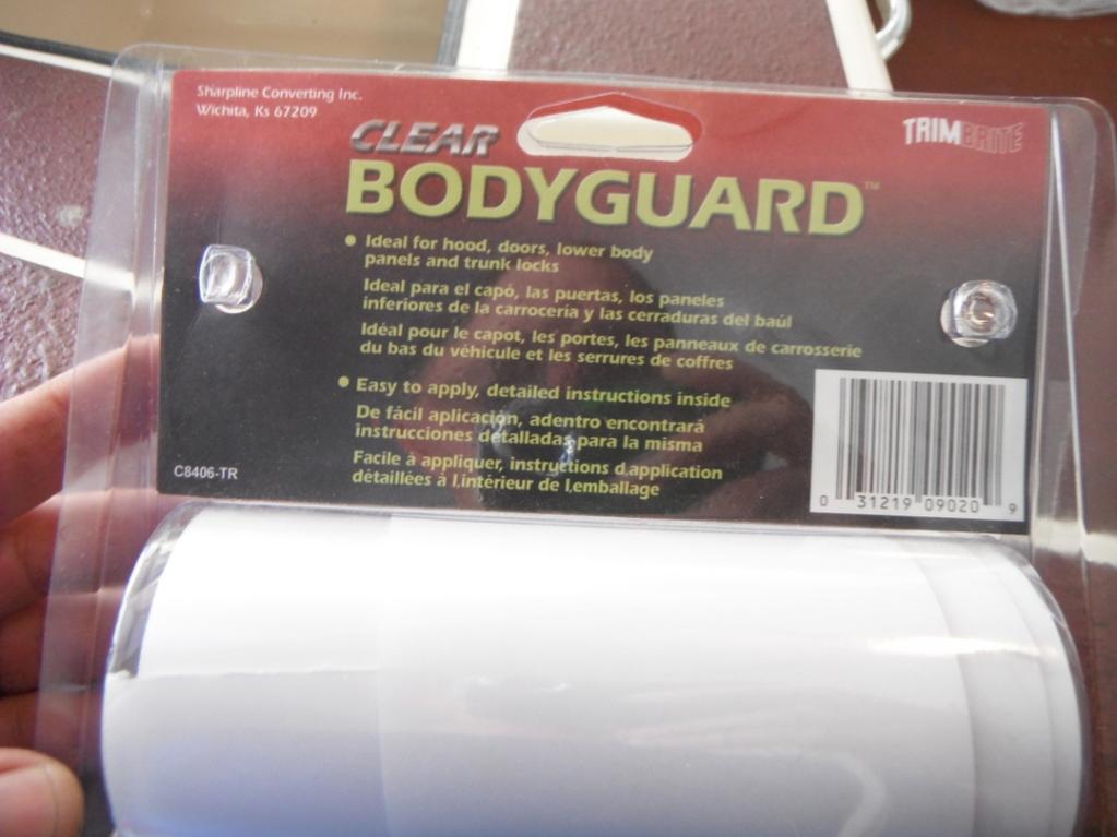

** I bought this stuff at the Autoparts store and cut it to cover the hatch paint under the bottom of the ladder. I stuck the ladder's adhesive strip directly to the clear tape. Hopefully no rubbing (= rust!) for me...

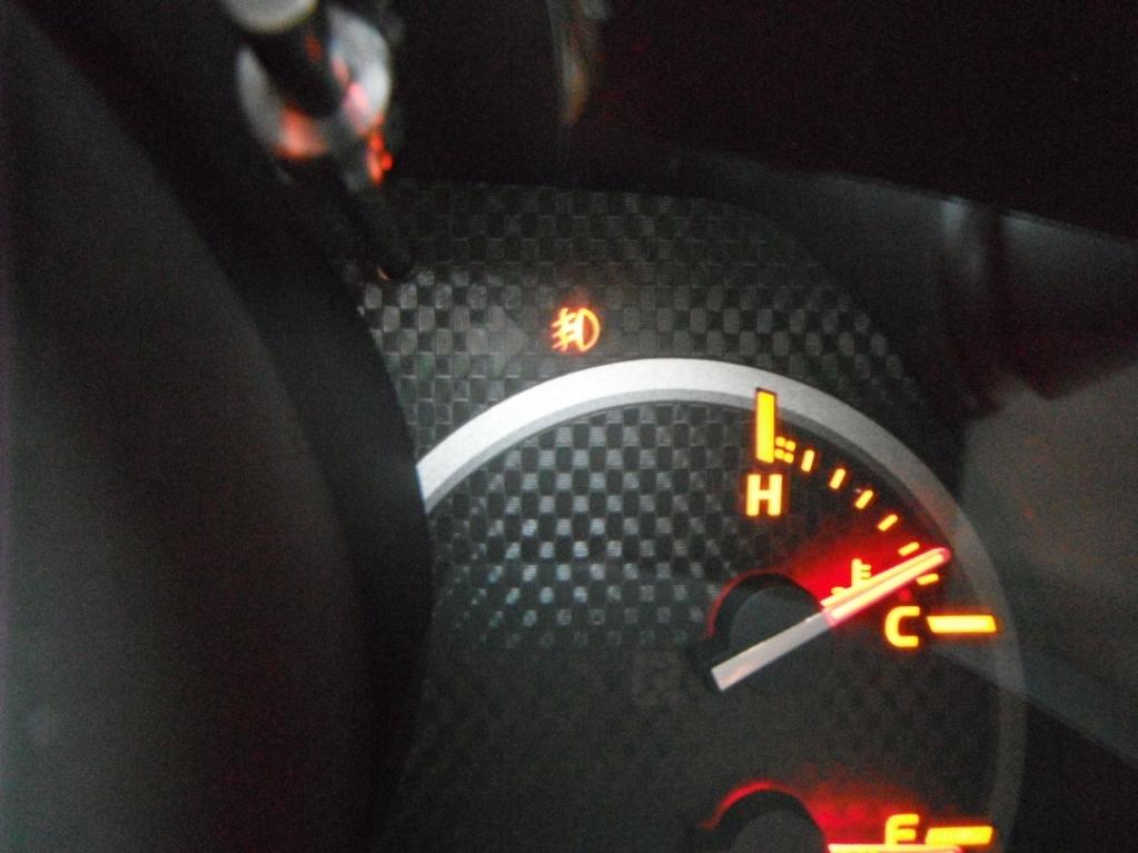

Lighting up the FOG indicator from the FOG MOD
Now everything can go back together. The ground to the LED gets connected to the ground in the FOG MOD writeup, and the hot-lead ties into relay terminal#30.
Here is the result, whenever the fogs are on...
