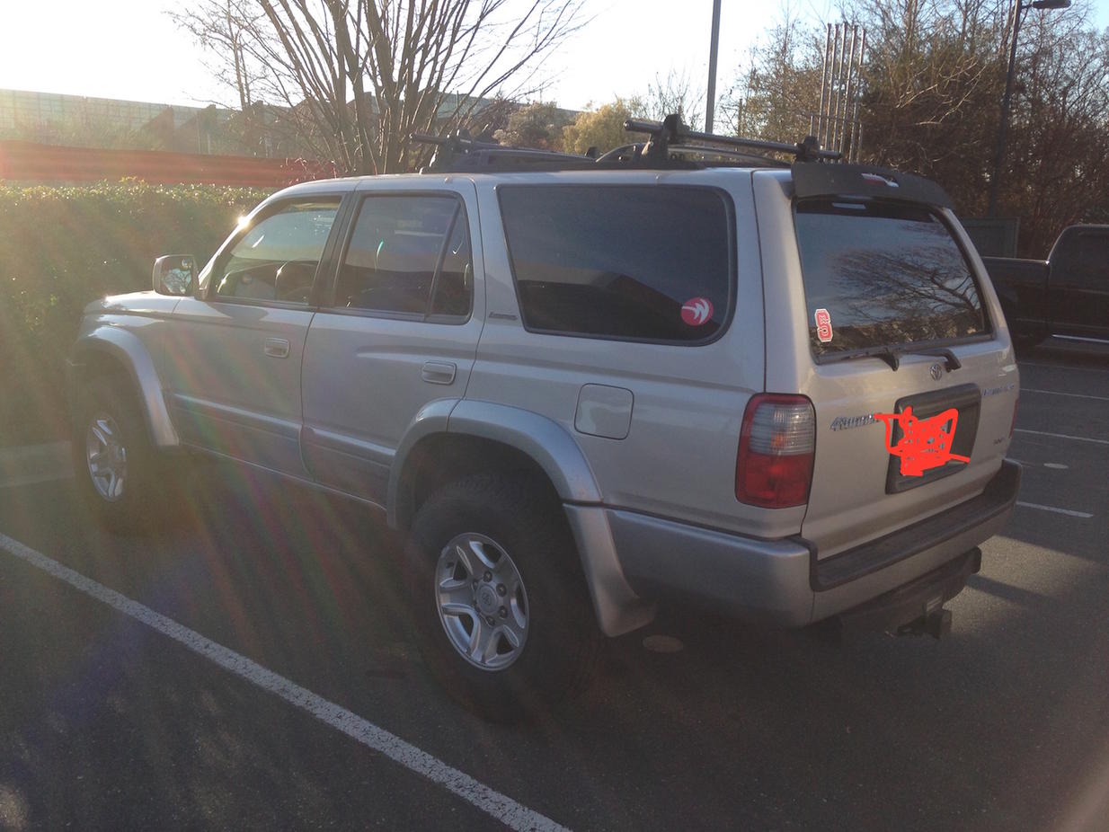

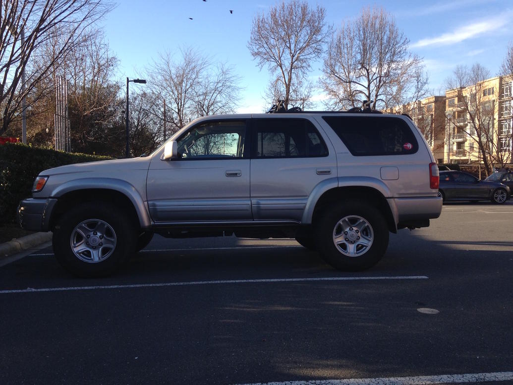

I can snap a few pics tomorrow. After I installed the spacers, I remember the rear being .75 to 1.00 taller than the front. Prior to that, I was 0 to .25 lower in the rear than the front. I'm sure it was from the aging original springs. I have the original 99 tall springs all the way around.
Sorry the pics don't really do it justice. It's basically level on the worst day. I honestly just need to replace the rear springs...and if I did so I would be inclined to go OEM 99 tall coils again. The OME 906's sound a bit stiff for my purposes since I rarely haul much weight. I think the airbag systems sound like an interesting option as well.

Thanks for posting pics.
Unfortunately mine's a '02 (shortest 3rd gen springs),I think even with those spacers the rear height still won't be tall enough. Maybe use my $20 AutoZone gift card towards rear Moog springs along with those spacers.
