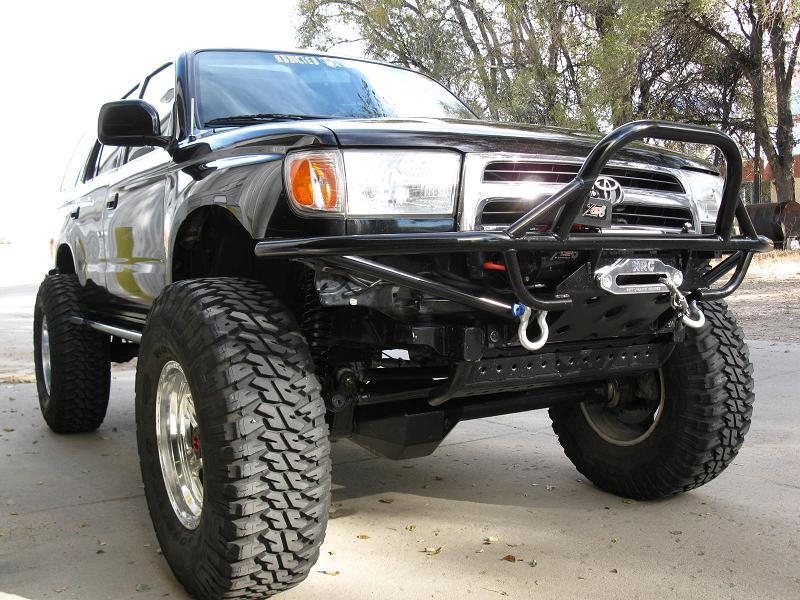

Solid Axle Swap
Any Questions? This is next for you:thumb3:. The IFS can only go and do so much.
I dream of this one day.
Blue
That is a sweet rig and has been a dream rig for me for a long time!
Unfortunately, there is no kit for the above 4runner. That is all custom fab work and all very high dollar parts. If you have a 4runner and about 10 grand, that may get you started with that suspension.
I was honestly just being a smart ass lol.. I know it's custom fab work. He just asked for a 4" lift kit or higher and I said here ya go.
