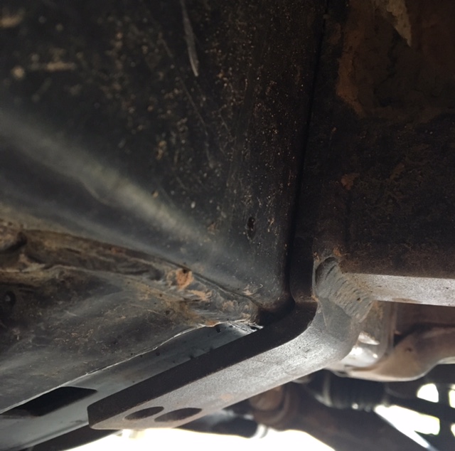

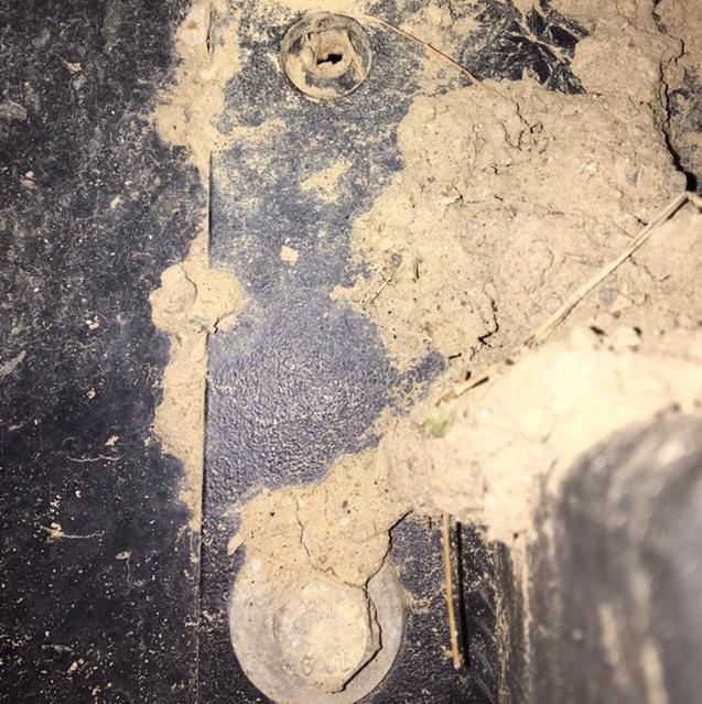

Understanding it usually a lovefest for ShrockWorks I have not mentioned this prior. That said, the product is built fantastic, the QC on my sliders was lacking IMO.
First pic is the driver side, upper bolt no go.
Second pic passenger side, have not drilled hole. But notice how much space is in between the frame and slider.
Not a big deal, the two combined rub me considering the price. Actually, regardless of price, shit should fit as it is intended to in general. End of the day, I am currently down two bolts, one per side. Though, each mount has the other two tightly locked down.

That sucks -- Love fest or not, they should stand by their product and that's not up to snuff, IMO. I'd hope that they would offer to swap at least the passenger side. The driver's side could probably be shaved out a little with a file or drill bit.

I can't recall for some reason and has mud in the pic, I believe that driver side was threaded. But in general yes can be, whatever....moving on until I feel like messing with it again. They are on tight as hell, not much true sliding for me. So good for now.
