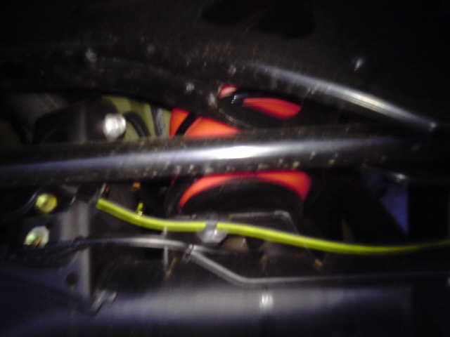

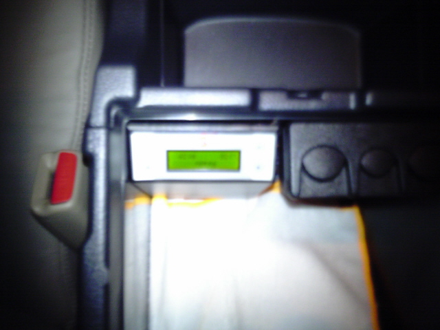

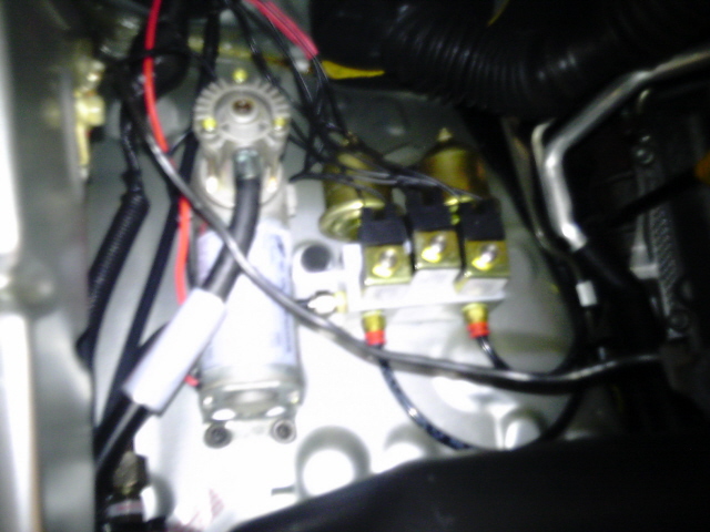

Look dude, I have a 2005 4-Runner V8 Limited and I'm just trying to explain that it's easier to install them without removing all of the components. Have you even looked to see how much of a gap there is between the springs when jacking the frame up? If you don't think so or are not able too then fine. Leave it to others to decide on how they want to install them. You chose your way right? They're always easier ways than what the manufacturer states. It's just the way I chose and it was a piece of cake.
Controller
